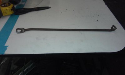

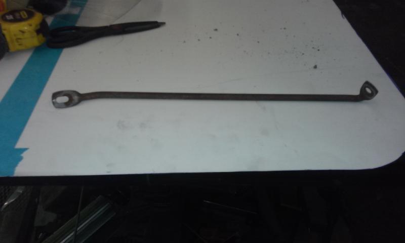

I'm trying to remember the location of this bracket, maybe around the grill or front end area.

One pic is the bracket and the other of the car taken this past summer. It's all together now and will later post a nice package . I hope they attached.

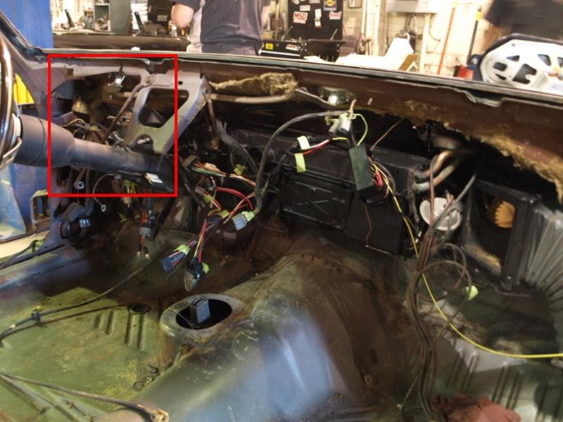

Looks like the column support brace Dale. Goes from the top of the column support to the inner cowl side wall
Front fender brace?

Thanks for the info. Propwash be right, column brace. Will be a challenge now but I'll give it a shot Dale
Will is the man that wins the prize :beerchug:. Forgot all about that under dash brace.

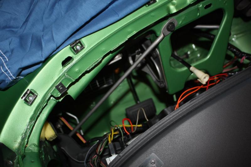

These tend to be forgotten. Found this picture from reassembly that shows it installed pretty well. Hope this helps.

My question to you is, how much of a bear was it to install after the dash / seats / glass / interior is in? Or did you just run without. Don't really know what it does other than perhaps offer some stabilization in a crash. Open for comments on this. Dale
I think you are correct about it being a crash brace. There does not seem to be any other reason for it. I think your car looks great without it.
Your call on putting it in. I think the top bolt is going to be a bear to reach with the dash installed. Never tried, so give it a shot.
