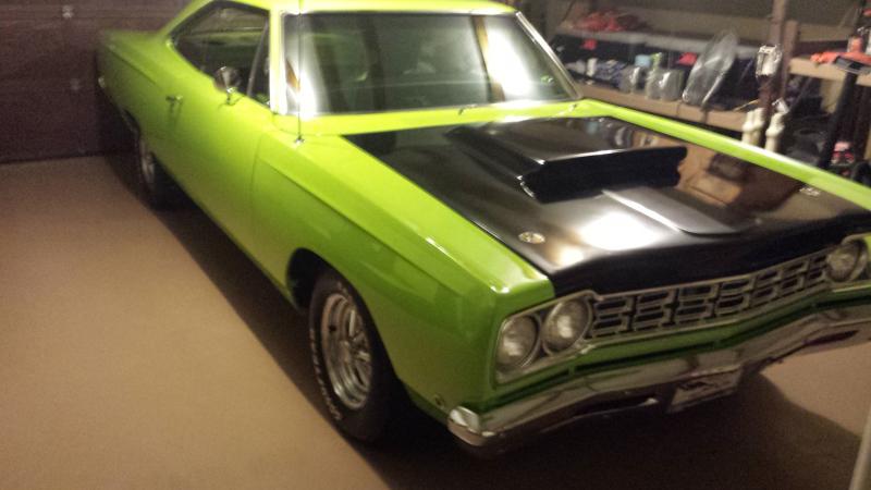

I have a 68 roadrunner that I just got back from the paint shop and need to know exactly where all the decals go on it. exact measurements in inch's would be appreciated. thank you.
Actually, you don't need measurements if the repo decals are exactly like the OEM. On the backing paper there was a notch cut out and that notch is a tool that locates off the metal door badge. FYI: 69's should have a similar setup.
thank you, that is really good to know about the decals but my roadrunner had been in a wreck and I have had to replace the doors on it so the original holes for the metal door badge's arent there on the new doors. If I could get the locations for where the metal door badges go it sounds like I could line up the decals with it. Im also running the metal trim panel that goes along the trunk and know there is a decal that goes somewhere on the passenger side but not sure exactly where. is there anything that lines up with?
