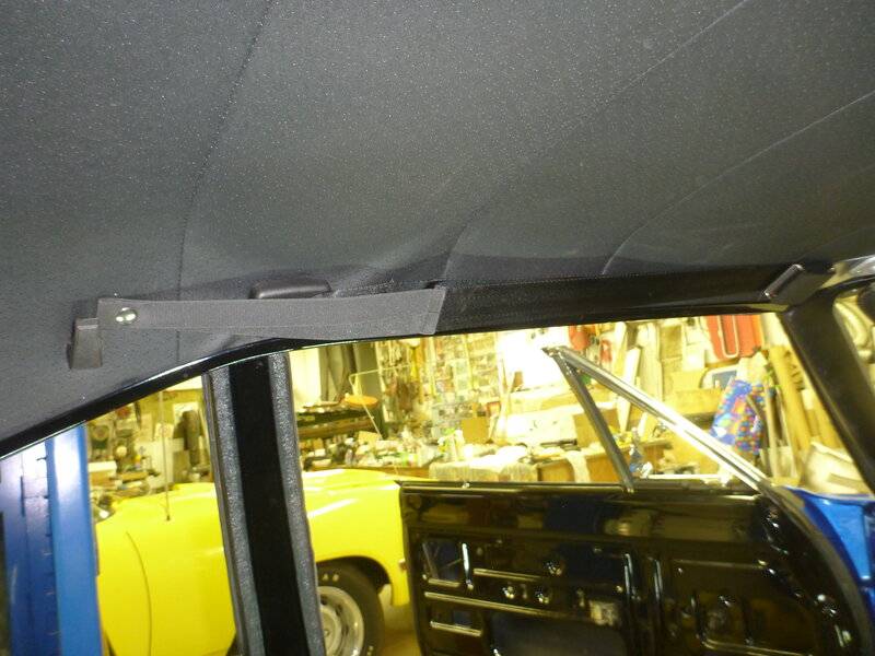

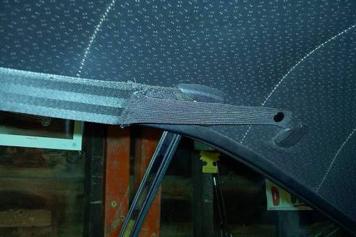

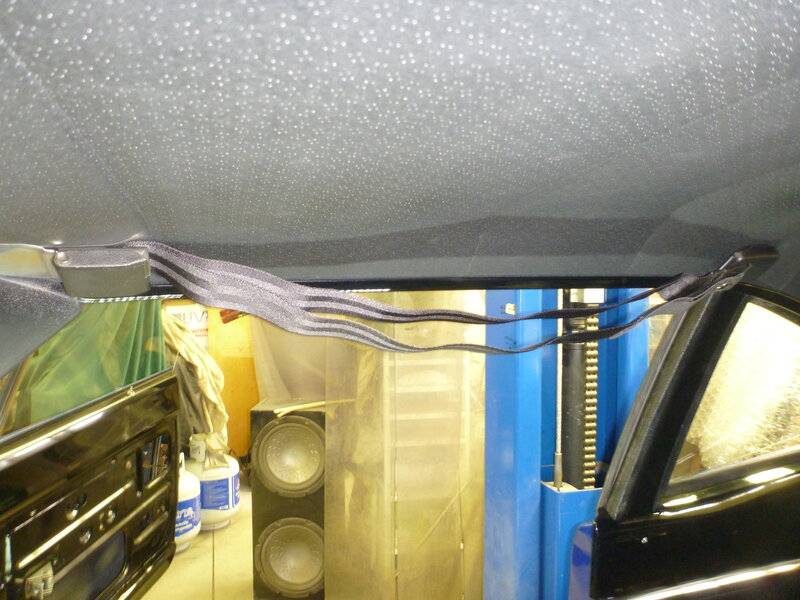

Can anyone post a photo of how the elastic strap that snaps to the retainer in the headliner and stores the shoulder belt is attached to the shoulder belt?
Thanks
each end of the elastic is sewn to the belt to form a loop. then at the end of the loop the two pieces are lined up and the snap goes through both pieces to form a sort of a triangle
I just bought some elastic to redo mine, guys at a local leather shop are doing the sewing, Beekeeper, when it's not snapped in place, how long is the elastic?
I don’t have the measurement handy but it will vary with the type and thickness elastic used.
Best thing to do is install the shoulder belt and the snap that screws to the roof then clip the belt on the visor storage clip and get a measurement on how much tension it needs to hold the tag end of the belt tight.
..and when you're not driving the car, move that snap to the other male snap that is on the actual belt so the elastic isn't stretched!

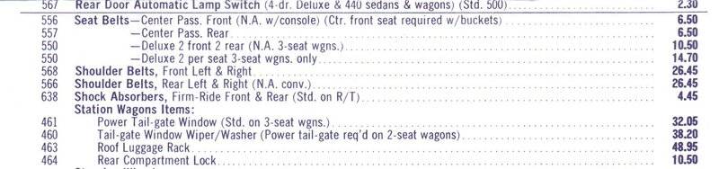

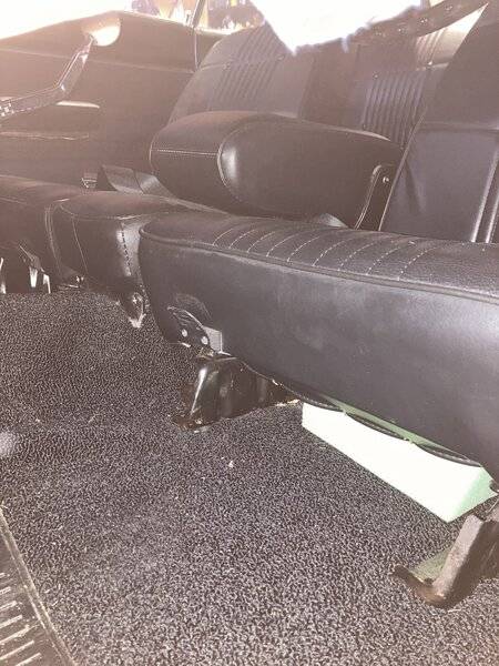

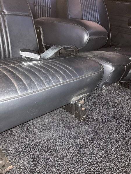

Does anyone have a suggestion where I can find an original or correct repop 68 Coronet RT front seatbelts in blue? Also...have a buddy seat. Does that classify me as a bench seat as far as seatbelts are concerned ? None came with the car so I am flying blind.
thanks in advance!
Matt

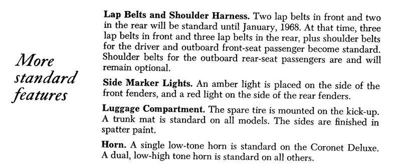

If you are asking if there should be 3 seat belts with a buddy seat, I don't know what the legal answer is, but my car came with a buddy seat and 3 seat belts. When restoring my car, I left the center front belts out, as I also went from automatic to 4 speed, which makes it virtually impossible to have three people in the front seat. Belts became mandatory on 1/1/68, which made them not mandatory on early build cars (from the first car of the new model year built, until cars assembled after the new year). The law said "at all seating positions" which means buddy seat cars were required to have 3 belts for front passengers. Here is how Mopar advertised belts for 1968 Coronets (see above). However, you could have optionally ordered belts and harnesses on 1968 model year cars assembled in 1967 (see above). My car was built Oct. 10, 1967. It came with front and rear center belts, but no harnesses. Since my car came with 6 belts, the center front and rear were ordered optionally.

My dilemma.....the buddy seat is really too small to seat anyone and is just a cool armrest. However, I have tried to be as correct with this car as possible. since a set of bucket seat seatbelts do not have the middle belt, I think I am safe to assume they used a bench seat set from the factory.....? I want to pull the trigger on a nice set of belts and don’t wanna get the wrong ones. Any advice would be greatly appreciated.

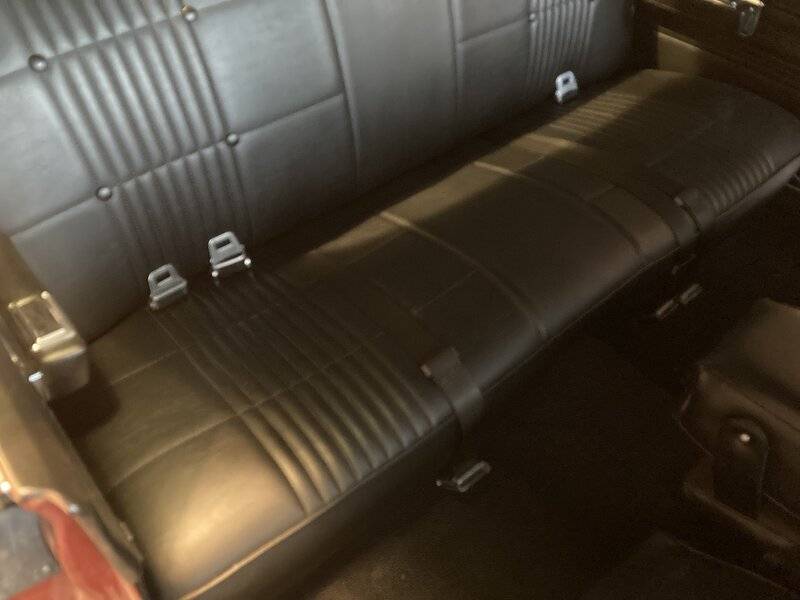

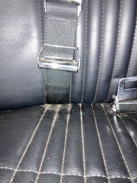

If you bought a set of three belts from a bench seat car you would be all set. I do believe The outboard male belts came two different ways. One-way was just the belt itself, the other was with a retractor. Also there were belt keepers on the bottom front of the buckets and the rear seat. These were plastic male ends that you attached the female belts to in order to keep them neat when not in use. There was no such feature for the front middle belts. I have the front Retractors on my car from the factory. I have also added retractors on the rear seat male belts.

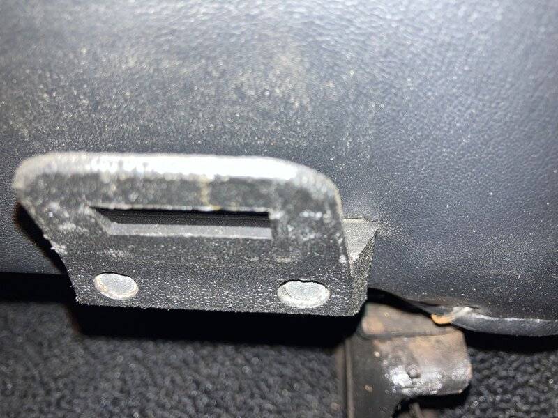

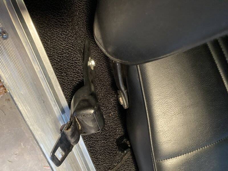

Thanks! Do you happen to have a pic of your front seat and the plastic male end retainer location?
Matt
There are holes in the frame of the seat that are for the screws that hold on the retainers. Classic industries and I’m sure other companies also sell the retainers.
