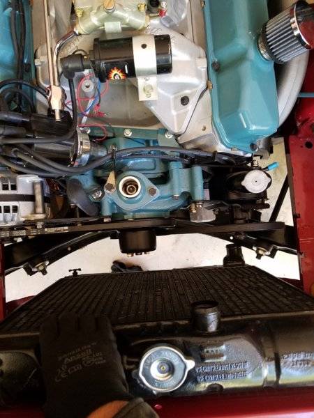

Well looks like the Dayco 70369 will work perfect for you. Not so much for me with the correct 053 radiator in my '69. Hose attach on your '68 is closer to the cap, right where my picture shows the hose.
What is the correct hose for your radiator please? Mine is the same as yours. 1968 Roadrunner 383
