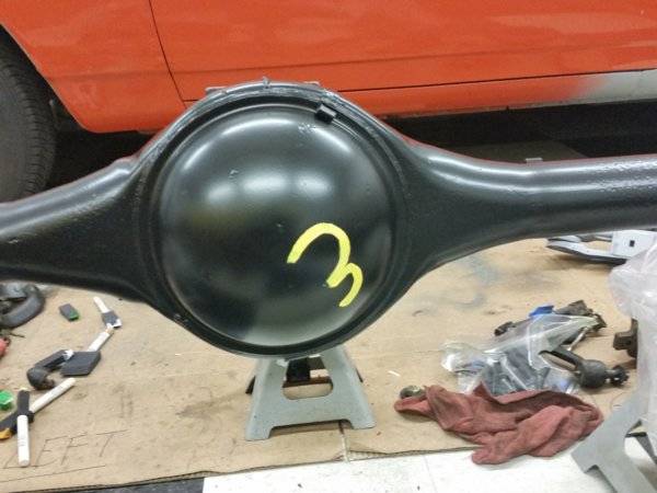

Does anyone have any pics of axle tube markings and date code locations. I am also looking for the correct font and size of the numbers. I do not have the build sheet for my car. I think I have to add 524 on my drivers side tube for the A36 package that is on my car. This is what I have so far.

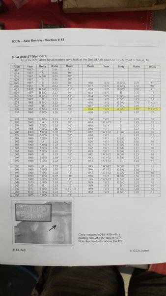

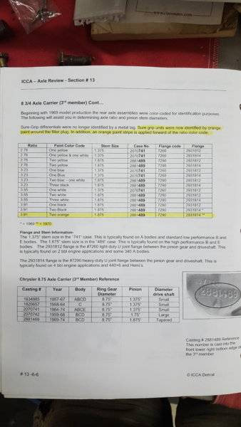

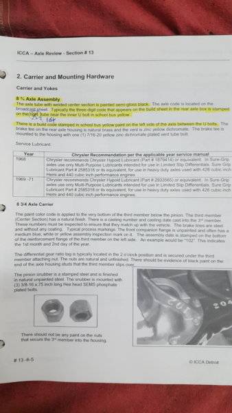

Here is some info from the David Wise books. Take it for what it's worth as I have found many discrepancies and errors. Any markings I have experienced on an 8 3/4 are on the inside of the left axle tube near the third member (last photo is the 8 3/4 from my E-body.) Hope this helps...

Here is some info from the David Wise books. Take it for what it's worth as I have found many discrepancies and errors. The "B" on your diff. looks a bit large and unnatural - remember, these were painted on quickly by hand and not much care was taken when doing so. Also those markings on the rear side of the left tube don't belong there. Any markings I have experienced on an 8 3/4 are on the inside of the left axle tube near the third member (last photo is the 8 3/4 from my E-body.) Hope this helps...

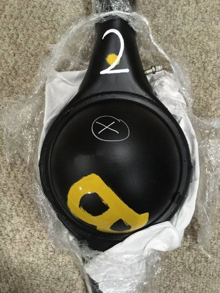

Thanks for the info guys. I didn't like the way that B turned out. I did make it as large as the original but it does look to perfect. I went over it to many times which in turn made the B wider. I have to live with it. I powder coated the diff. To much work to redo at this point.

If you duplicated it to the "T" then it would be too nice and not correct....
It was correct once, thats it....So your mark is the second trip down the assembly line.....Do not sweat that a bit...Fan out some brush strokes at your start and finish(you can still add that)...
Do not take offense but if your shooting for 100% OE...Powder coat is a big "NO NO" and will get caught....
That aside your first pic looks nicely done just add some brush strokes....

GC what did you use for the numbers? Was it a stamp or stencil? It does look amazing. Nice work.

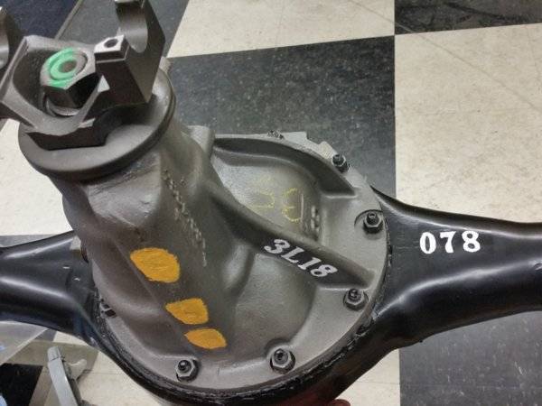

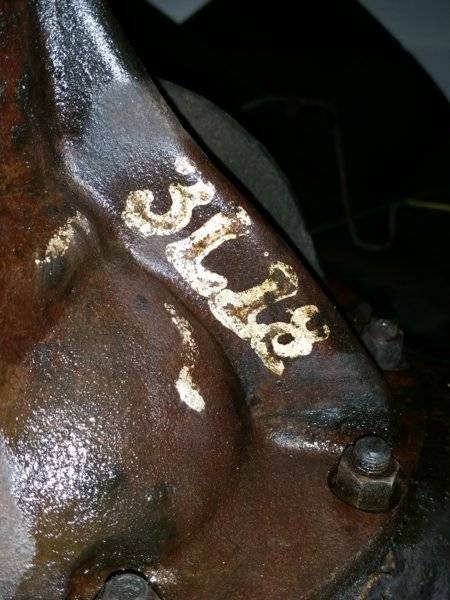

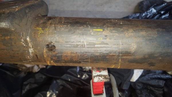

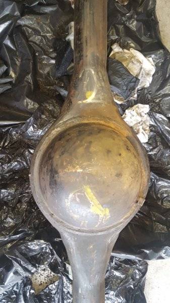

Moparnation is correct about the stamps. I made a stencil for my numbers using info from the DW book. In the book, there is a page with numbers printed to their actual sizes. I just photocopied the page and cut out the numbers I needed and painted them in. It was certainly cheaper than the stamps but a bit more labor-intensive and not quite as accurate. I also can't agree more with Moparnation regarding the care needed in the cleaning process. As you can see what I discovered with my original rear by going slowly and not using abrasives...

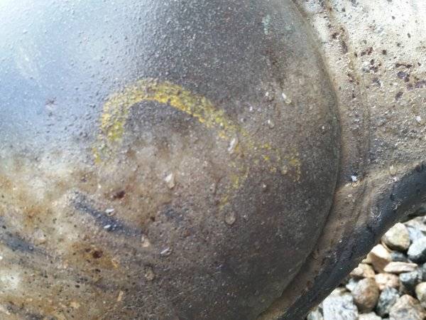

The "D" on the back of my 8-3/4 looks like they just slapped it on with the brush from a big bottle of white out...

GC, What does the 3L18 represent?
210 would represent February 10th, but did they ever include 69 for the year?
The 3L18 is a mystery to me. In one of the pics I posted from the DW book, there is a "K111" stamped in that area and a "4L3" shown in another photo. The book states they are the 3rd member assembly dates but nowhere can I find out what the significance of the letters are and why they appear at random (ie: sometimes the first character in the sequence, sometimes the second, etc...)

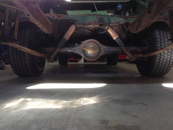

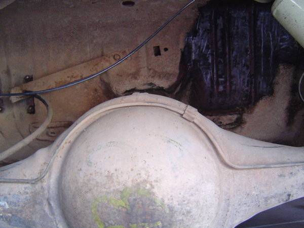

Well, this is very interesting to me because back in the 80's my entire rear end was replaced in my 73 RR because I seized one of the axle bearings, so the shop at the time just found a replacement and installed it. So after seeing these pictures and looking at mine, wondering now if I have a rear housing from a 68 or was this done on all housing into the 70's? Here is the picture I took before I restored the rear end.

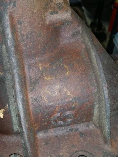

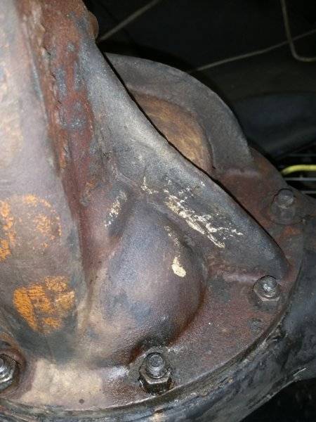

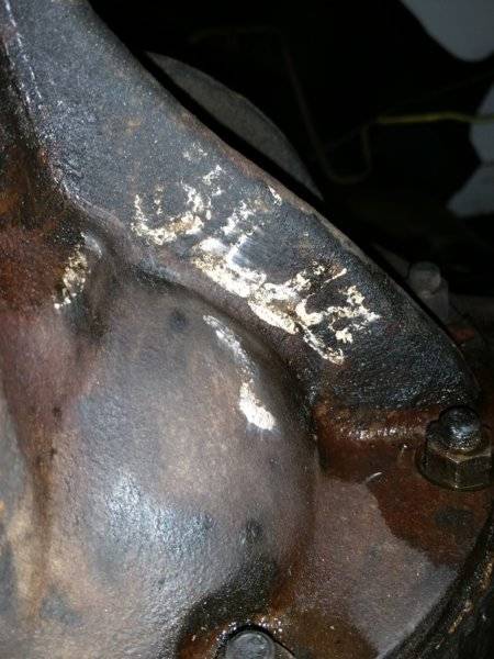

Thanks GC. Have a look at this pic of my axle tube. This is on the passenger side facing the front of the car. I expected to see this on the drivers side if this is the axle Broadcast Sheet number. Maybe this is the date code?

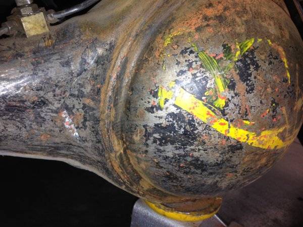

We all know it's an inspection mark, but what does the big yellow "B" on the rear of the axle mean anyway?
