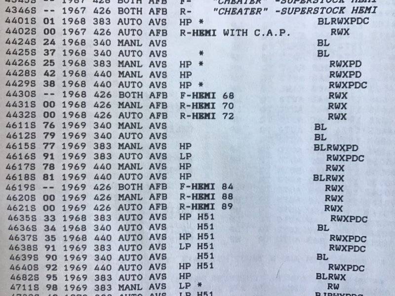

A 69 road runner 383 comes with a Carter AVS, not a Holley.
You have the broadcast sheet so look up what carb it came with.

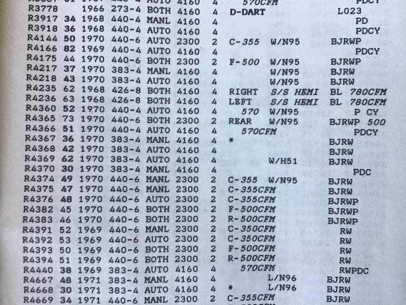

It came with 38. Number 4440 Holley 4160. Listed on the second image you posted. Thank you!

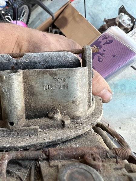

I was under the impression the carb bodies were date coded all the way down to the week from a search I did on Holley codes is all
247th day of 1968 Dom. (Sept 4). (Or 78, 88, 98. 68 is 100% more likely however).
And 69 runners came with both carters and holleys, four barrels and two barrels (three). But you knew that....
(Holley four digit date code is first three digits, day of the year, last is which year of the decade).
I thought Holley date codes were 3 digits when that car was made. I think all 4 digit Holleys were made after that car.
Factory installed Chrysler Holley date codes were 4 digits for 1967 and up.
I was on a FB page on Holley carbs. date stamps came up and I made the claim that they were 4 digits, 3 for the day and last for year. Ohh boy! I was chastised like none other. Turns out the other holleys are in the 60's are only 3 digits.
Learn something maybe the hard way. These people questiond my moral / religious values and insulted my entire family a few generations back. Love internet thought guys huh? LOL
Ok, good, I learned something. I have a couple of 70 Road Runner carbs I think and saw the 4 digit dates and thought they were replacement carbs. I knew my 65 Race Hemi carbs were 404 and thought all Holleys were 3 digits until the early 70's.
