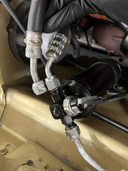

Inching forward in this. Got the green o rings in finally. Tally was 4 black and one missing, rest they managed to change with the new hoses.
new drier is on. Expansion valve changed.
the drier to expansion valve line fooled me. That one isn’t new. They painted the ends. It’s still pliable. I ordered a new one just to be safe. Hope it makes it before the guy works me in.
