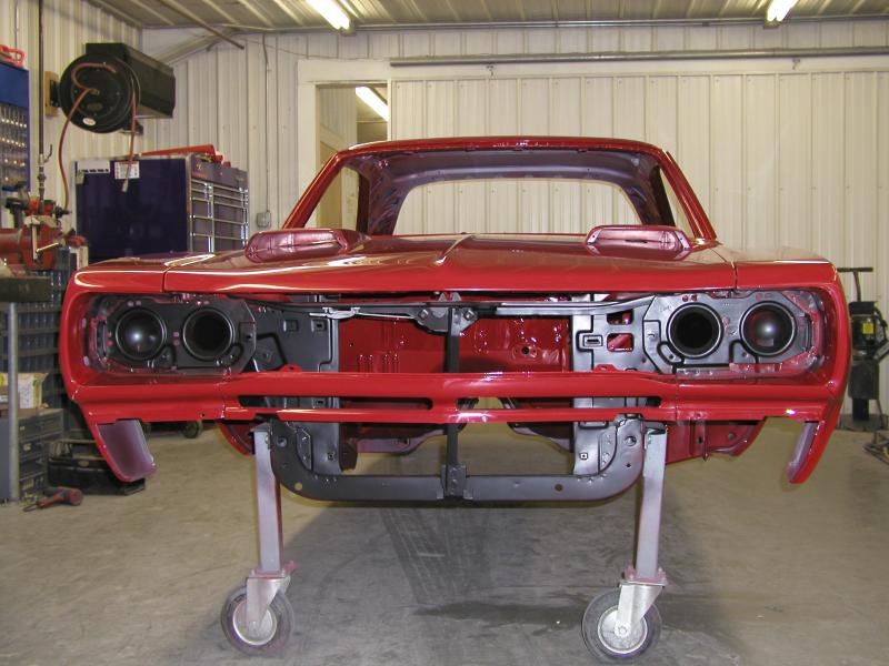

I am going to paint my radiator yoke black like factory original. Anyone have pics of how that should look when finished?
A radiator yoke is the same as some call the radiator support. It's the pieces of stamped and welded sheet metal which "yokes" the radiator to the car itself once the "support" is inserted between the front inner fender supports and tacked into place... hence the term "radiator yoke". Not to be confused with a drive shaft yoke or an oxen yoke.
It was painted flat or satin black at the factory along with the pieces behind the headlights.
I think this is what you wanted to see.................
