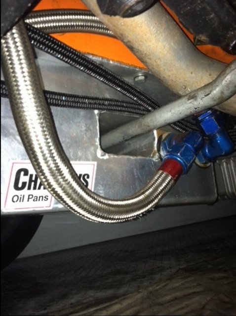

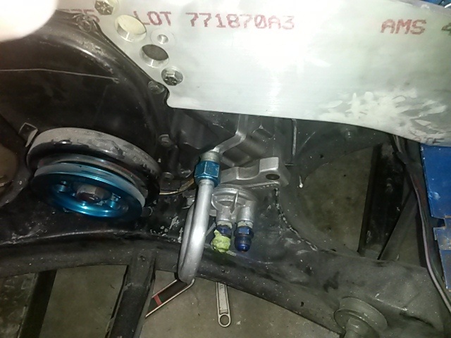

Alright guys this is what i have hopefully the pic will load. I'm gonna have to get line and shorten them up some. Also when I make the line, I want to have a line looped up above the pump so it don't lose prime.. did i read that right?
I would start by mounting your engine and plate in the car. Then you can check clearance at the steering box, the lower radiator hose, oil filter and plate. Those lines can leave the pan almost vertically and be against the block for clearance. The line at the back of the pump will try to fight with the steering box mount. If the front line is hard line it may go over the top and through the plate. Can we have a picture from the front? Dave
Check the location on the lower radiator hose. If you can, try to run this over the pump maybe. You can get a 90 or 120 fitting to go over the pump and back along the block and down to the pan. Thanks for the pic. Dave
ok will do another thing to look at..im concerned about the headers, the back of the motor and getting them to go and not getting burnt by the headers...in the pic above is that the right right way the lines are suppose to be?

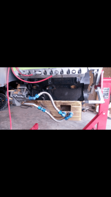

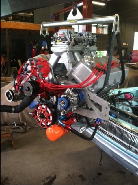

With a motor plate, you'll have no problem but if you want to retain motor mounts milodon offers a oil pump housing specifically for that.
charlies oil pan1.jpg NEW HEMI2.jpg 10426233_10203251969174302_266255686668756624_n.jpg
Sweet! that will help alot...like in that first pic, my header is so dang close to the block...gotta be able to make it work somehow..Thank you for the pics
