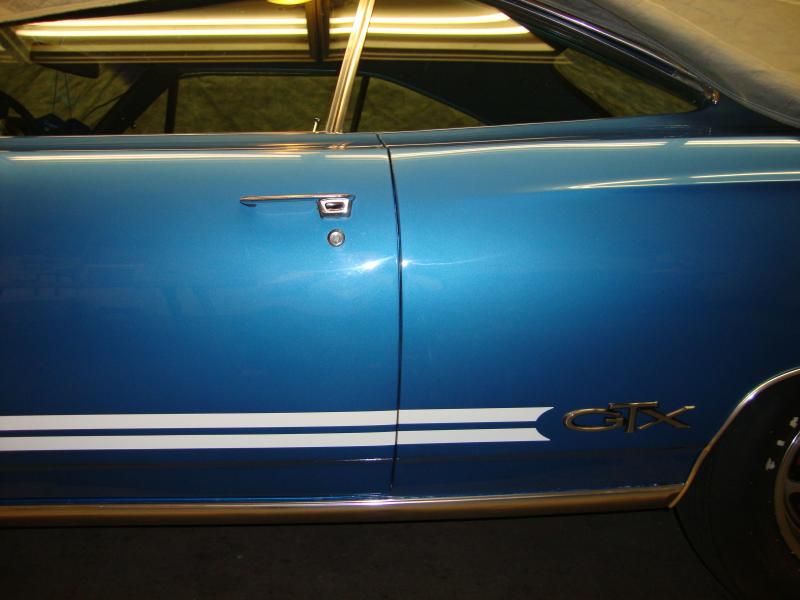

here's my 68 GTX for reference...
so the 69 and 70 doors are exactly the same. 68 has the lock and handle in the different position?
