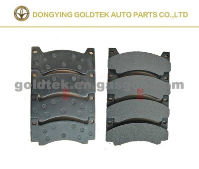

These are the pads. no clips. they sit in a bracket and ride on pins. '69 fury

May not be the pad.
Had to go check the old FSM. Whether you have Budd or Kelsey-Hayse disc they all had anti-rattle spring for inner and outer pads. Just as kryslerkid suggested.
any idea what they look like and where to find them??
could you post a picture of the FSM so i can check it out?? thanks.
