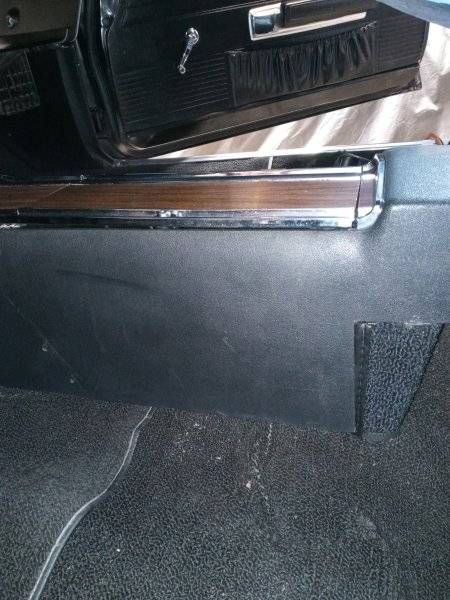

I just did my 69 charger was a original 4 speedconsole car it's hard to say from the pics but mine the console front looks to go up under the dash a bit more and as far as floor gaps the carpet kit and the extra side piece you can get will cover up that mine without the kit was about a inch or so off the floor hope the info helped

i measured from seat belt bolt to back of console it was 1 inch I got some pics for u if I can figure out how to post them to u

I measured from seat belt bolt center to back of console it was 1inch I got some pics for you to if I can figure out how to post them to you

I posted some pics let me no if you got them also the side piece was off on driver side
