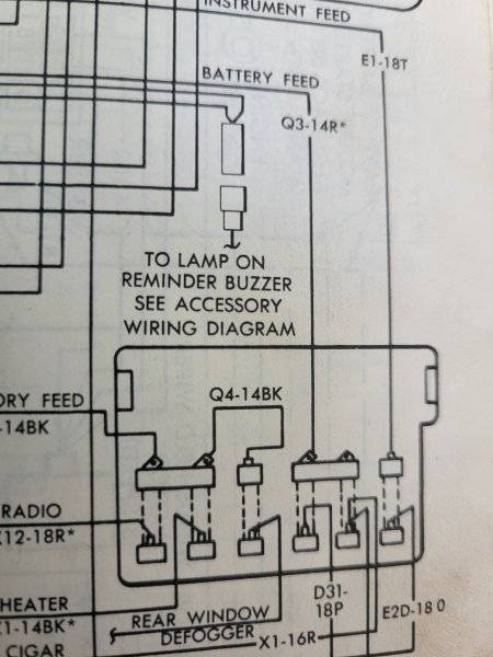

I'll need to confirm on my wiring diagram, Do you have a test light to check for power on each one? Test each one before connecting to see if there is power.
If you need a color diagram photo, I think there is a link

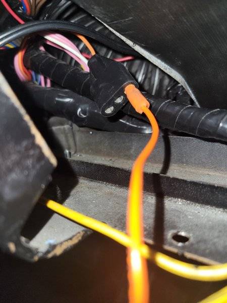

As for the 3 bullet connections, here is a pic.

You can use the 3 bullet plug for lights.

Glove box you want on the pink wire. Thats 12 volt hot. The ashtray light is to go to the 3 pin bullet and orange [dim-able] circuit.

What else typically connects to the dimmer "3 bullet connector"? Speaking of anyone know what that connector "male" is called. My normal bullet.connectors dont fit.
