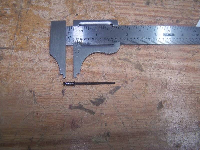

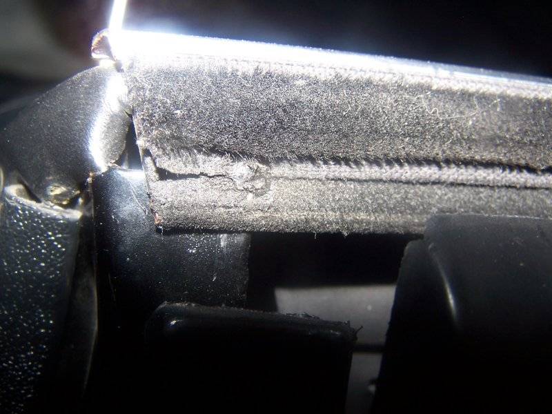

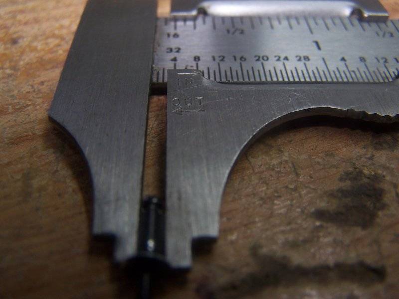

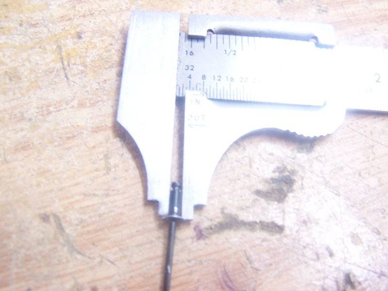

I used some pop rivets. 3/32 X 1/4". They worked perfect. I found some black steel rivets. Can't remember where. Probably Ebay. Here are a couple pics. You can see one of them in pic #4. I put them in about 4-5" apart. If you can't find the black ones, you can touch them up with some black paint afterwards. Good luck.
