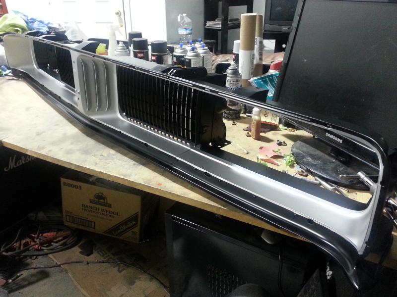

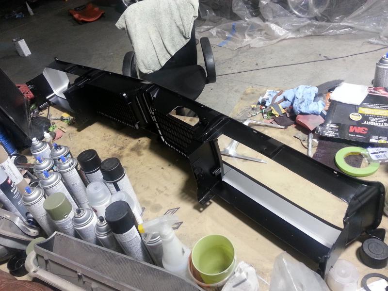

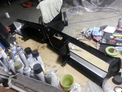

Thanks guys here's the main pieces mocked up after getting hit with the satin black, got a couple small runs but they're on the edge of the finned section where I'm going to have to sand and paint silver anyway, then I should finally be done with these damn things haha

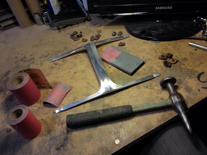

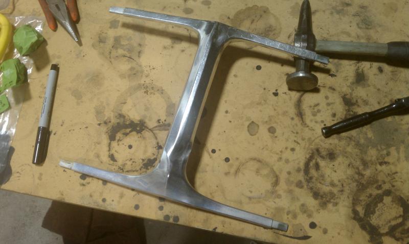

Man if you like the stainless you'll love the old aluminum, this is my "I" beam piece that Chuck showed me on, I'm still straightening it out so this spot was only sanded with 320 before he buffed it. All he did was a few seconds of the blue compound on a pedestal grinder with a soft buffing wheel and it hardly shows any sanding scratches, figure wetsanding up to 600 and some buffing and the trim should come out perfect.

Thanks Brian I'm really happy with how its coming out so far, the hours of taping paid off I guess since I haven't gotten any overspray on anything yet (knock on wood) haha. Detailing the rest of the grille assembly stuff will be a breeze compared to these pieces

Well on to the trim, trying to get the hardest piece out of the way first. Got the Who blasting on the radio listening to Nights With Alice Cooper and straightening this I beam, it's a party here tonight lol
Already have the big dents taken care of, more pics to come when I'm done sweet talking this thing.

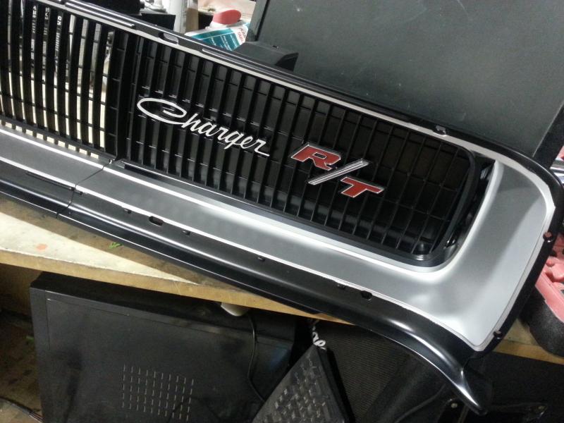

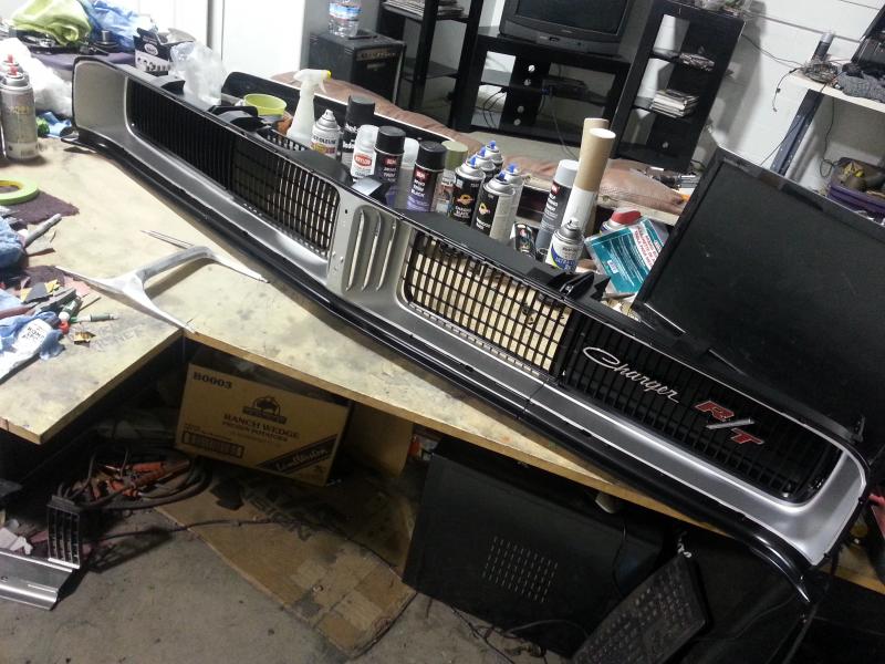

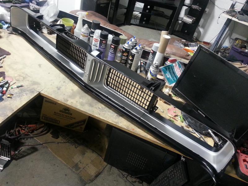

Still have to do the little silver outlining that goes around the finned sections, but couldn't help mocking up my grille with the emblems and headlight doors. Feels good to see it all together finally

Mr.SpeedFreak, Forgive me if this has been stated in your posting somewhere but which exactly "dull aluminum" paint did you use for your grill? It appears to have a very good look to it.
Hey Speedy - Is this the paint you used on the R/T grill emblem? I didn't realize Walmart even sold this stuff, but yours turned out so nice I figured I might give it a whirl on mine.
Thanks! It's Krylon number 1403, I'm really happy with how it came out and like I said before from what I could tell it's a dead ringer for the factory silver. The friends of mine that do restorations professionally use it, too. On a sidenote, Goose is that you?! Lol
That's the one! Like I said just let it drip into the emblem after it's good and clean, the brush will show brush strokes pretty bad. Then just set it on something level to let it dry and it should come out fine :icon_thumleft:

That grill looks awesome all put together "excellent work Speedy".

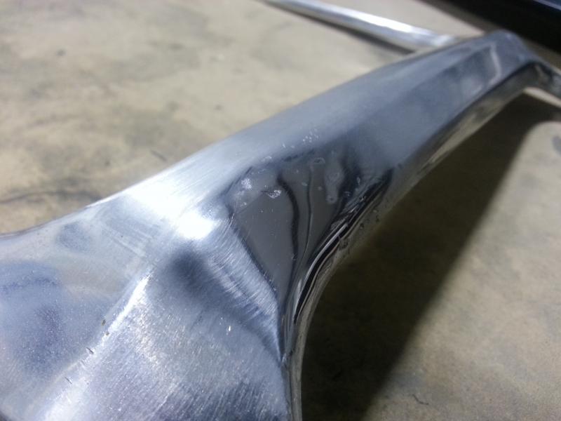

Thanks guys, unfortunately it's about that time for some good news/ bad news.. good news is I'm going to see Alice Cooper down in Redding this saturday haha, bad news is I sanded through a spot on my I beam trim.. Got some low-temp fluxless aluminum/magnesium rod to try and save it but so far it's looking like I'll have to hit ebay for a new I beam. Gonna give it one last chance at resuscitation tomorrow before I call it, fingers crossed.

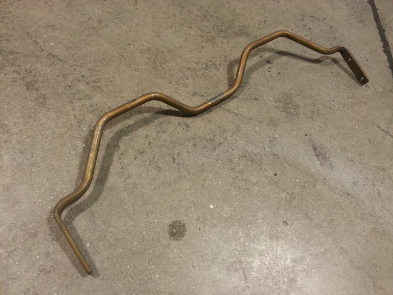

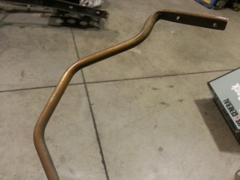

I also have an interesting question for you guys, I got to cleaning up and restoring my vacuum assemblies and noticed the headlight door crossbar things have a bronze coloring to them that isn't corrosion. Did these have a coating like cosmolene or something from the factory? Or maybe some freak overspray since my car was originally T5? Considering just satin clearing them to keep this coloring for some cool/interesting originality :thinker:
All of the restored headlight bucket arms I have seen were painted grey, so I would have thought they were unpainted originally. Maybe shoot Mr. Cranium a pm as his 68 is really detailed nice - he might know for sure.
