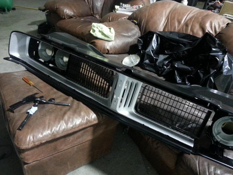

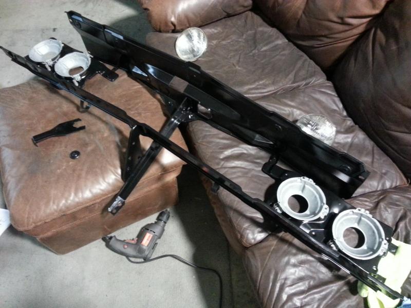

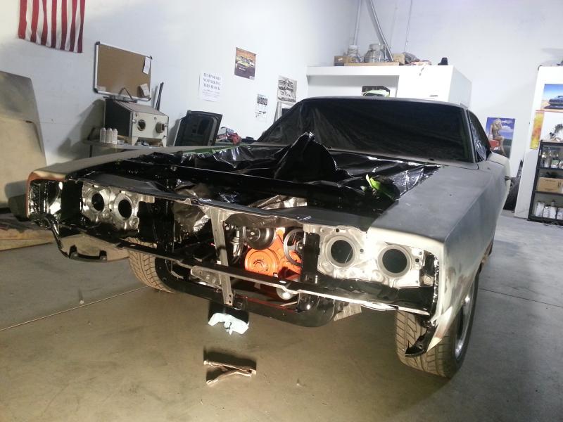

Well it was a busy, cold holiday weekend but I finally got the gas turned on to the shop, heater cranked, and the grille frame all fixed up, sanded down and painted. Had to straighten the outer tabs on each side that were tweaked pretty bad and the wide vertical piecethat goes down the middle had a bit of a bow to it. Nothing some gentle convincing and a pair of vicegrips couldn't take care of.
For once I remembered to do the smart thing and test-fit it before paint haha
Didn't have too much surface rust, so I just took a wire wheel to wherever there was and sanded down the rest. Don't mind my ingenious cherry picker/ bungee cord hanging system lol
Then the usual program, some etch primer..
..and topcoated with some satin chassis black. On to the trim and hopefully thowing this thing back together soon :icon_pray: hope all you guys had a righteous turkey day

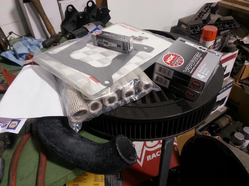

Just so you guys don't think I've been (completely) slacking off.. here's a little update. I was lucky enough to get a bit of a Christmas bonus at work last week, and it was enough to get the last odds and ends I need to finally fire up old frankenstein. Since I'm finished up underneath the car/engine bay and the interior is ready for the dash/pedals/etc, I decided that firing off the 440 will be my main focus here over the next month or so, then back to the bodywork and paint. I just can't wait disturb my quiet little neighborhood any longer

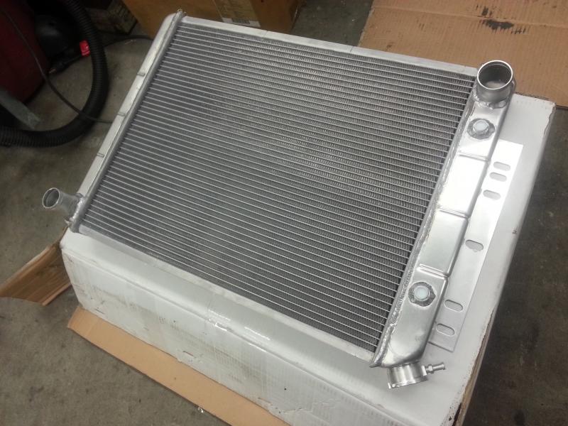

So I treated the Charger to an early Chistmas and picked up all my gaskets, belts, hoses, spark plugs and stainless braid sleeves for the wires, and one hell of an aluminum radiator lol

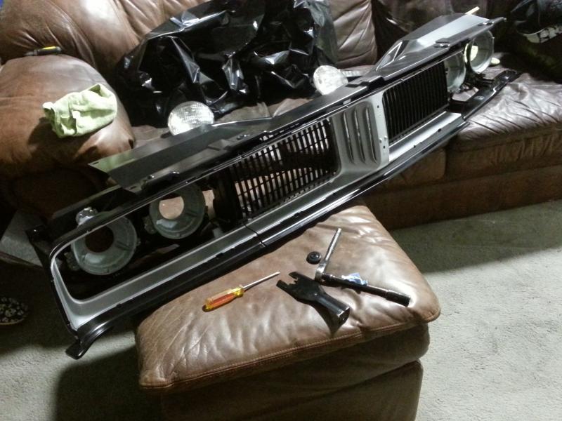

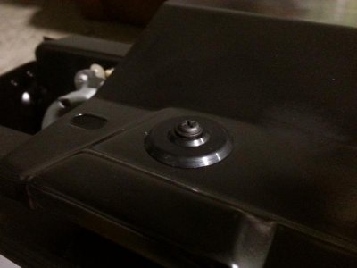

Let's see.. on to the grille AKA "pain in my @ss" lol. The last little bit of silver paint around the finned sections has been fighting me every step of the way and it's doubtful I'll be able to save my I-beam trim that I sanded through. So if anyone has a '69 Charger center "I" beam grille trim piece it'd be a huge help if I could pick it up from you for a reasonable price! Didn't let those issues keep me down though, got the headlight hardware all blasted, flat-cleared and back on the frame

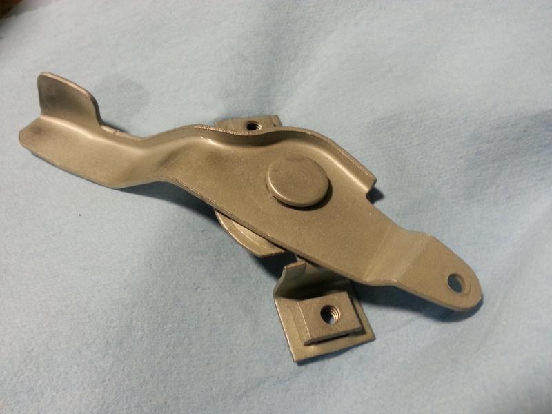

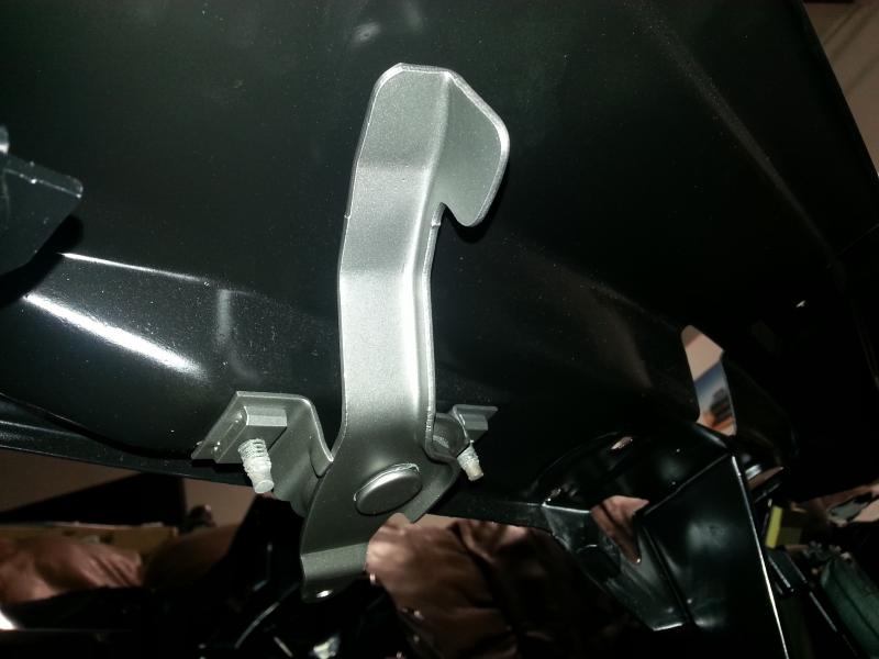

Sandblasted and painted the hood release with ironcast paint and flat clear for some extra wear protection

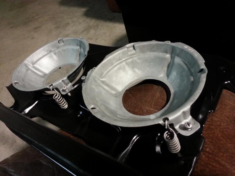

And started mocking up the plastic sections.
I was missing all the spacers along the top so I picked some up from my friend with the mountain of parts, for anyone that also needs to replace theirs, they're interchangeable with '70 'Cuda grilles. I was also missing all the bolts/screws that go through these spacers into the plastic sections to hold them in place, so I hit the local napa and found some black hardware I thought looked pretty good! :shruggy:

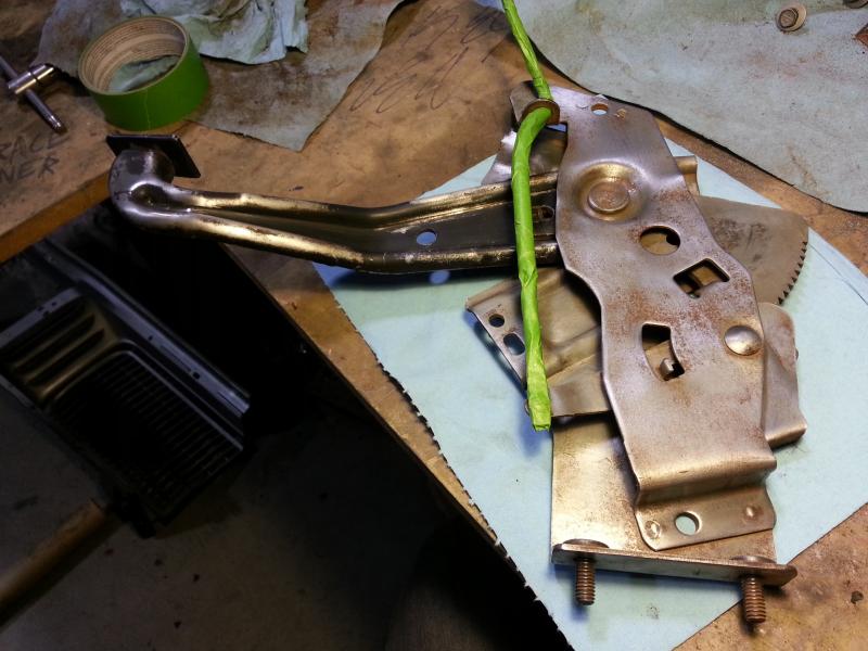

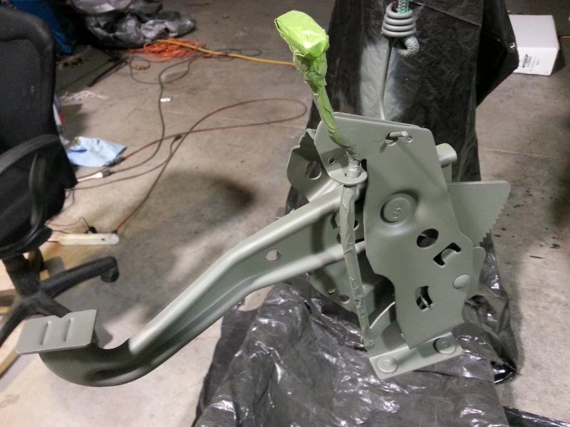

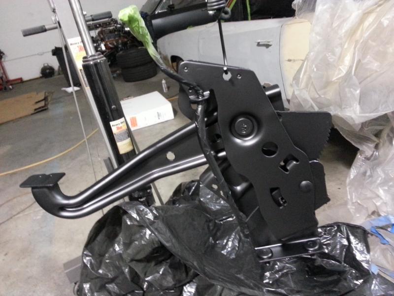

Also got my emergency brake assembly stripped, etch primed, and painted with a flat "underhood" black I decided on using for all my pedals

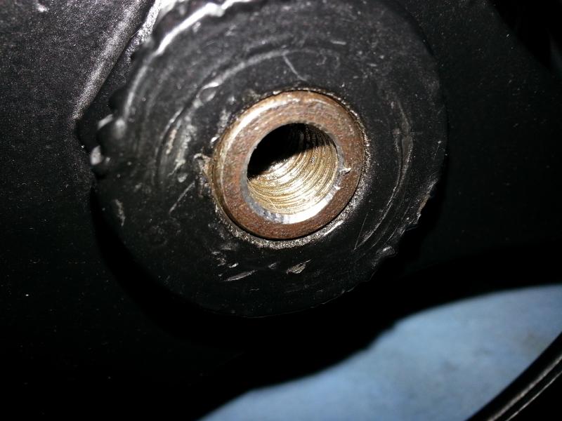

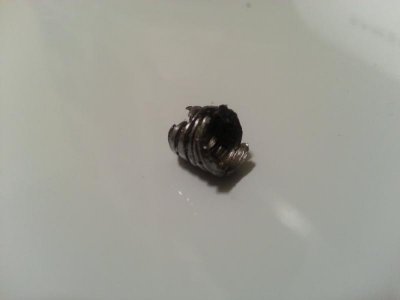

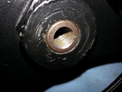

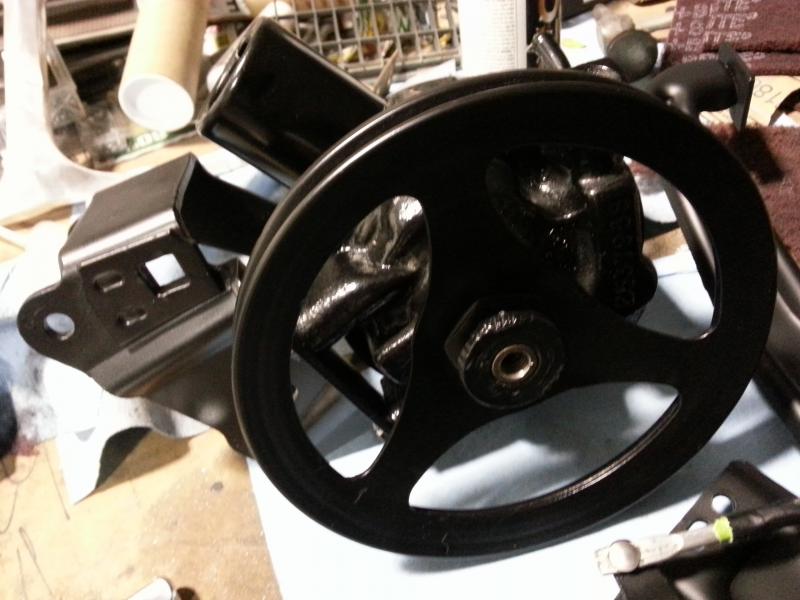

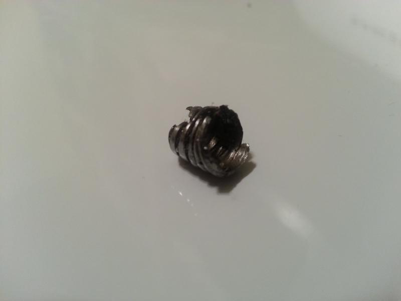

And I don't remember if I mentioned on here that I broke off a bolt in the power steering pulley trying to press it back on (probably bottomed out and kept trying to tighten it, and used a cheapo bolt like a moron lol). But yesterday my dad and I messed with it and ended up drilling out the off-center hole i drilled, and retapped the hole. Part of the old bolt even came out with the tap, nasty business lol.
Then a little work straightening he pulley itself which had a pretty nice wobble to it, and bam! Good as new and ready to go back on the engine.

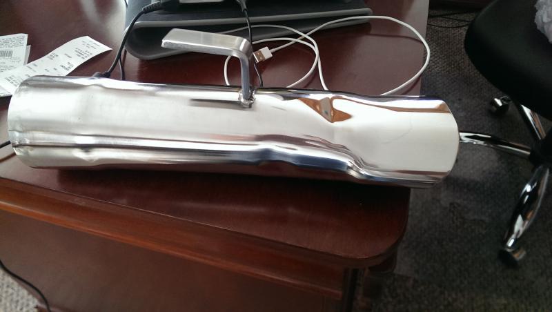

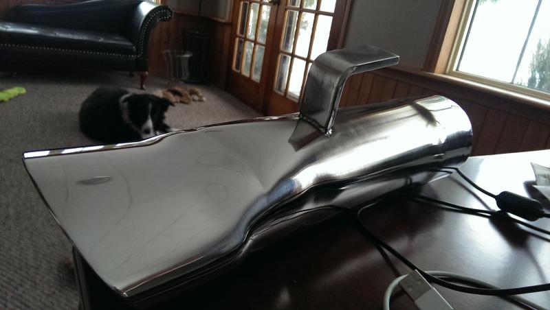

And one last thing I also got my tips from PG... no problems with shipping and am happy with the quality. Here's a couple pics of mine

Who is the rad supplier that looks sharp? also that air filter is that a spectre or K&N?

Thanks man! The radiator is from Northern I just had ordered in by the local radiator shop. It's a two row but they're oversize so it's supposed to cool like a 4 row, but with better airflow through the radiator. I guess it's a good sign when the radiator guy calls to say it showed up and all he says is "Hey I've got a pretty bad@ss looking radiator sitting here" lol

Damn those tips are gorgeous! Can't wait til mine get here now, I think the tracking said estimated delivery the day after christmas :waiting:
