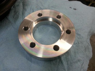

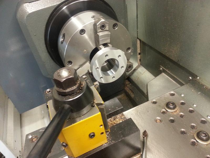

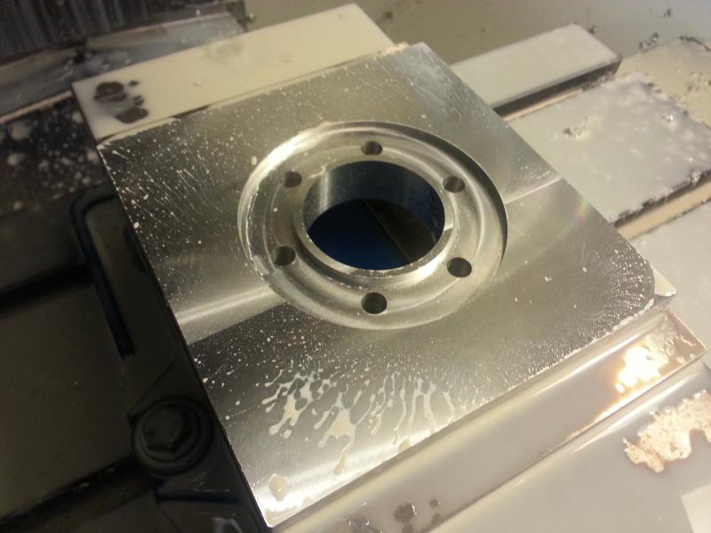

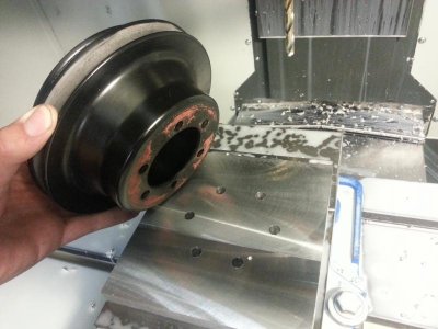

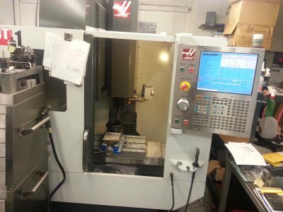

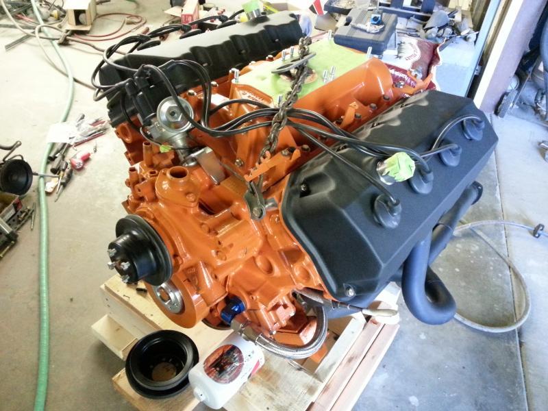

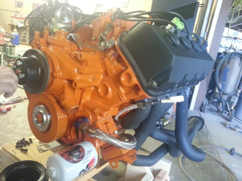

I got my jobs done early at work on Friday, so me and my dad did this fun little side project machining a spacer for the crank pulley on Mike's Hemi. He said he used a 440 style dampener because the cost is so much less compared to the hemi counterpart with the same performance, so he needed a spacer for the factory hemi pulley to line up correctly.

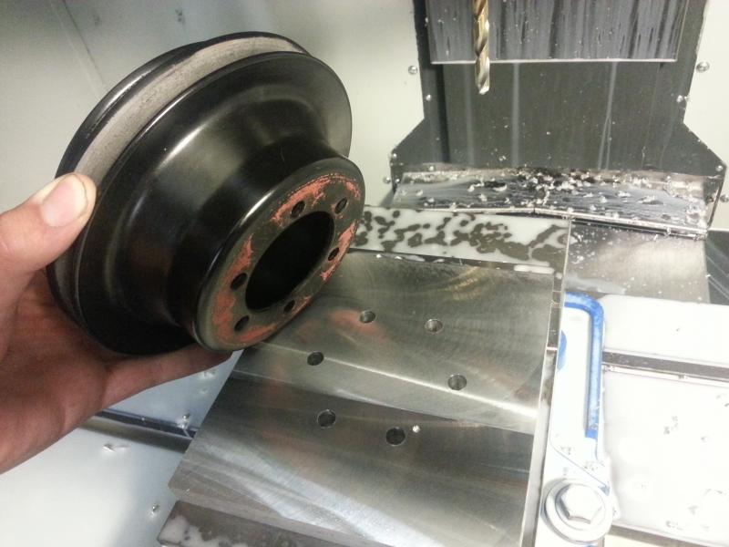

So we started on the mill with flycutting the material flat and drilling the bolt circle. Took a bit of trig to find the position for the one offset hole but we got it haha

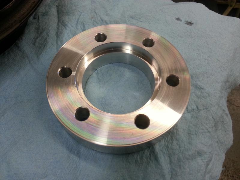

Then we milled it to thickness, leaving the front register that the pulley locates to.

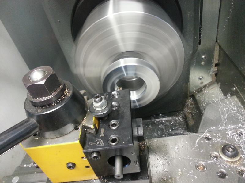

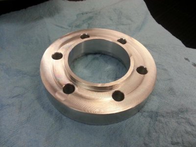

Then the outer diameter and over to the lathe to face the backside and ID turn the inner register that locates to the dampener.
And the finished product!

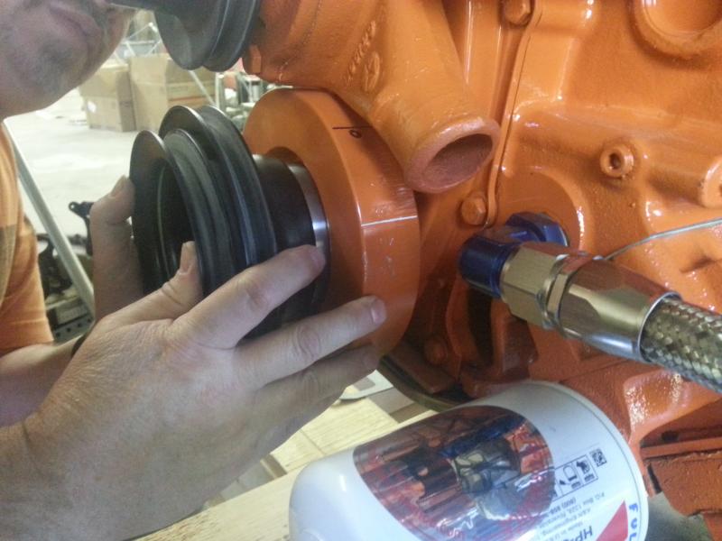

Then off to Mike's after work for delivery, fits like a glove! :icon_thumleft: So if there's much of a demand for these I may start making them in production, that way anyone can save some money running a 440 dampener and still retain all the factory hemi pulleys.

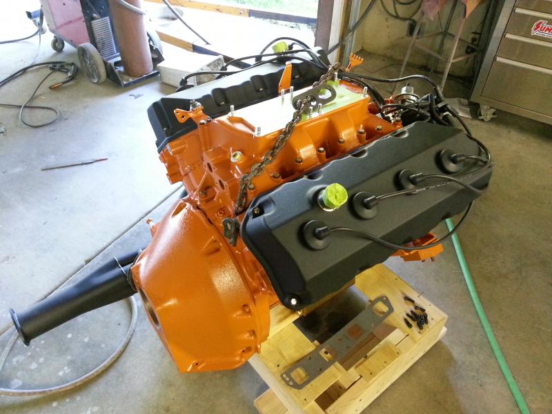

Can't forget the 540 cubes of engine **** haha

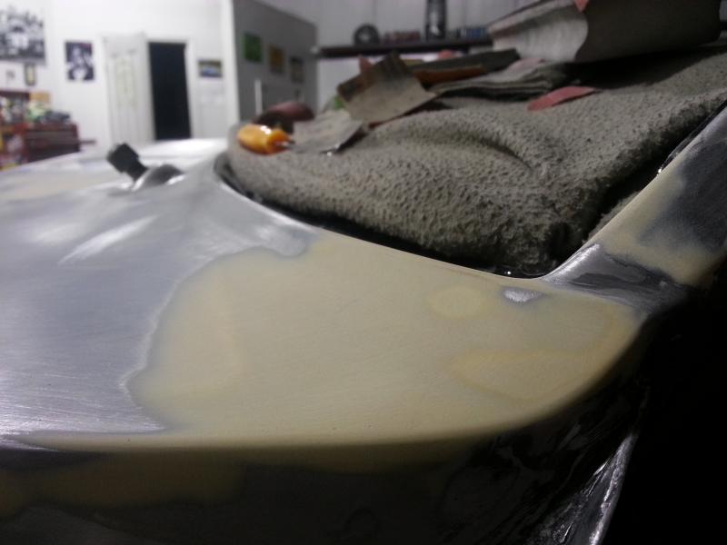

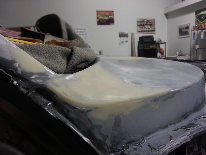

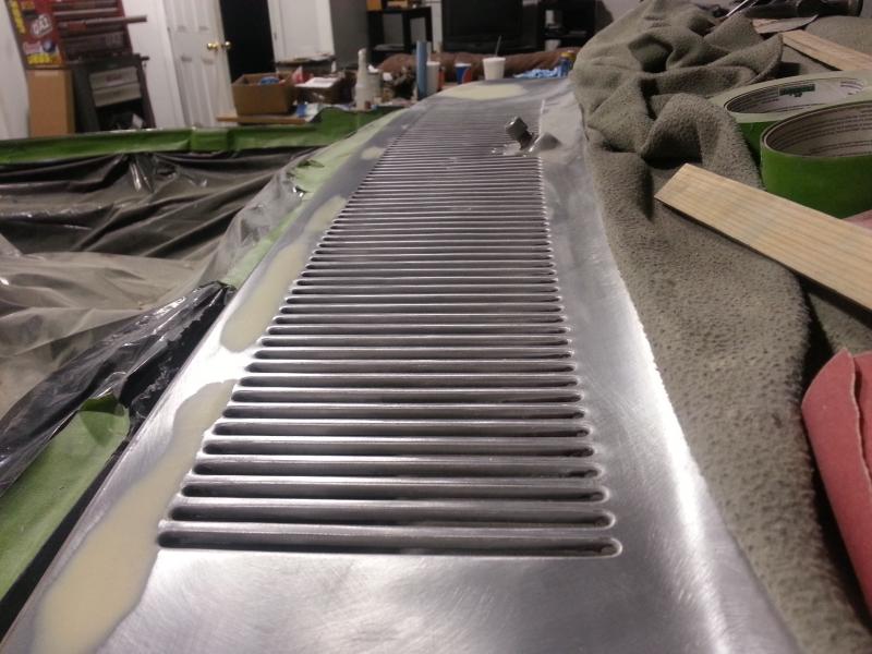

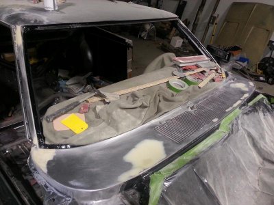

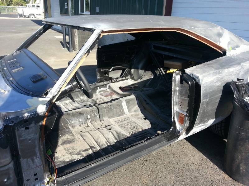

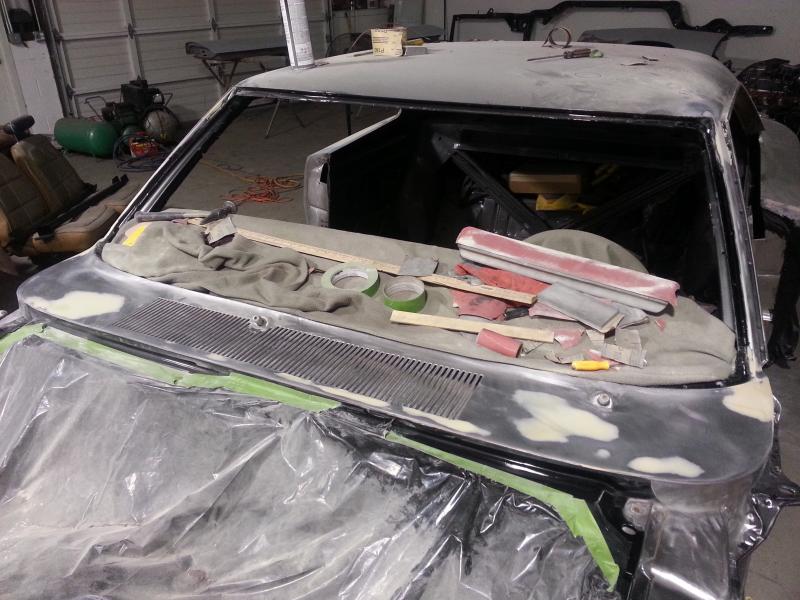

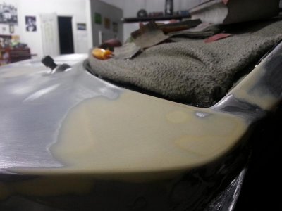

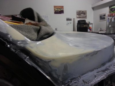

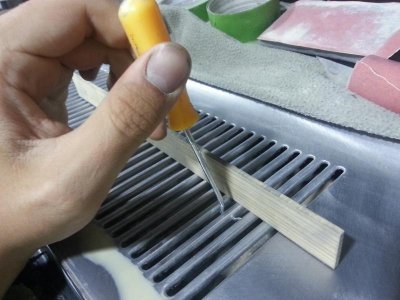

Now back to the regularly scheduled Charger programming lol. After some colorful language and a good chunk of time I got the cowl fins all leveled off and straightened. Opted for the paintstick/ hook tool combo and a buddy of mine was over hanging out at the shop and helped eyeball how close everything looked. Just a note to anyone doing this for the first time like me, it doesn't take much force to pull these things so don't over-do it. I'm assuming if you pull too far and stretch the metal you'll pretty much be stuck with some wobbly looking fins. (Still say you should put your tool into production elk lol!)

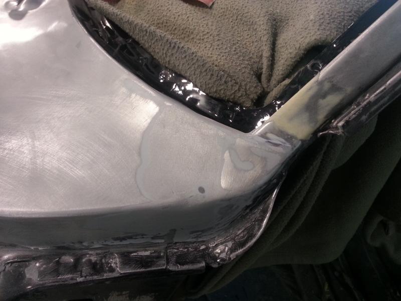

And finally got the cowl to A-pillar seams done, and the rest of the bodywork on the cowl in check :icon_pray:
So at this point I'm finally all systems go for primer, gonna get everything all cleaned out and masked off today. Feel like I'm making some real progress now

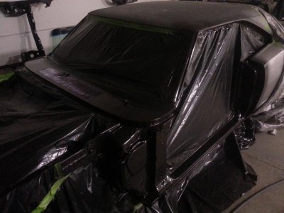

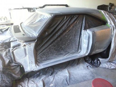

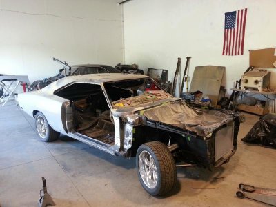

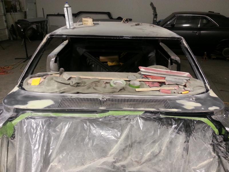

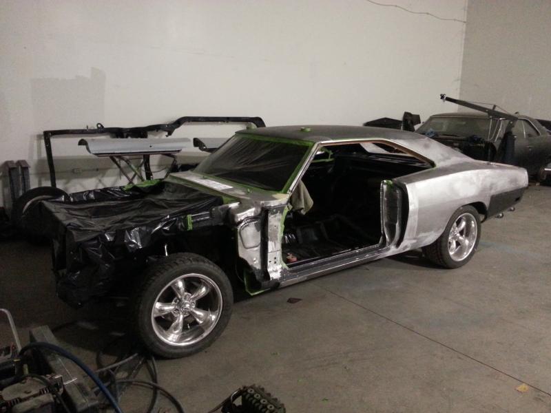

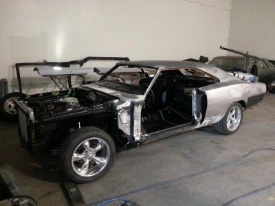

Well I had a busy night taking the little lady out to dinner but I did get some time to roll frankenstein outside for a massive cleaning (which meant the shop got one too haha). Just gotta do some last minute re-scuffing and masking tomorrow and we'll be good to go. Just thought I'd share some more pics in the meantime
All cleaned up and ready for action haha

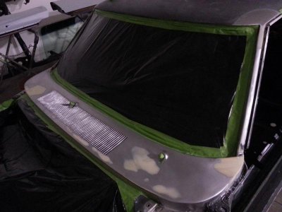

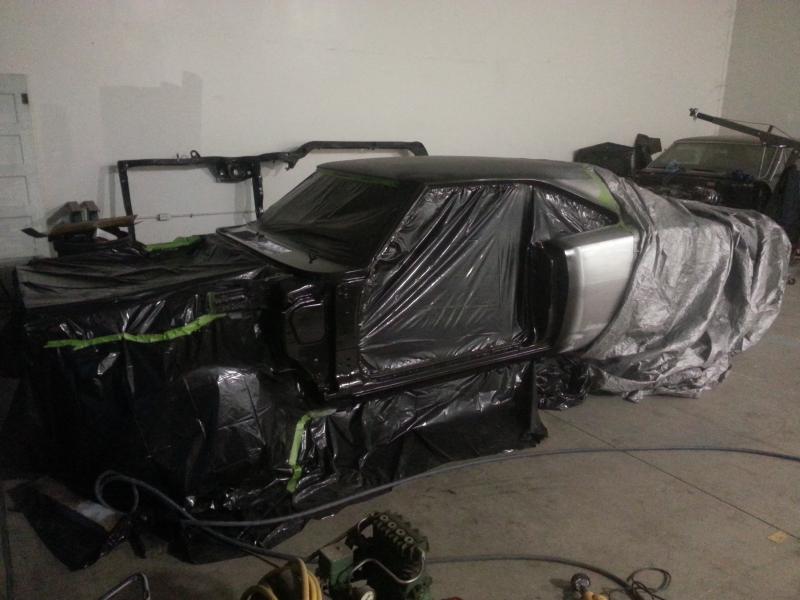

Sorry Daytona, no primer yet but tonight should be the night. As always I underestimated how long the masking party was going to take but I burned some midnight oil and knocked it out.
All edges are masked so now I just have a couple more sheets of plastic to hang, break out the tac cloth and lay some primer!

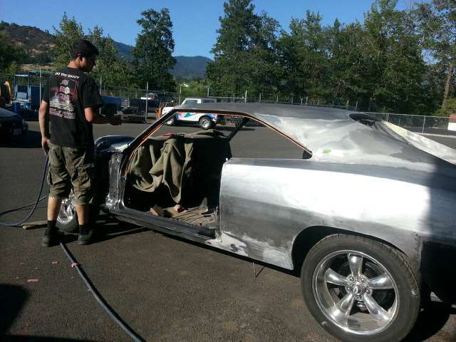

Well fellas the deed is done!
The learning curve kinda kicked my @ss though haha. Had some pretty bad runs in the doorjambs and rockers, but nothing some sandpaper can't fix and like my buddy Al always said-
Basically my advice with All-U-Need is to let your first coat remain semi transparent. Charlie and the paint guy both warned me it would look like that and still be building, but I was in a hurry and thought I'd try to get it a little darker on the first coat which caused the runs. But oh well, lesson learned and at least the cowl and A-pillars seem to have come out ok

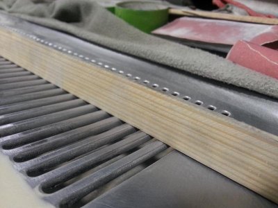

Carefully sanded the runs and sags with 80 grit to level them off, then 180 to knock down the orange peel, 320 to take out the 180 scratches (where I'm at right now), and tomorrow should be some wet sanding with 400 before the jet black topcoat. Moving right along guys
