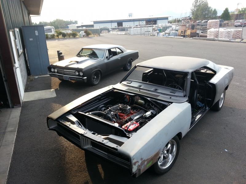

More fun blasting the Charger around with some more action and better sound! Trans is slipping pretty bad but I have another one I can throw in, and the automatic won't be in the car for long anyway. But DAMN does this engine want to run! :banana:
[video]https://youtu.be/mTG-elswwQo[/video]

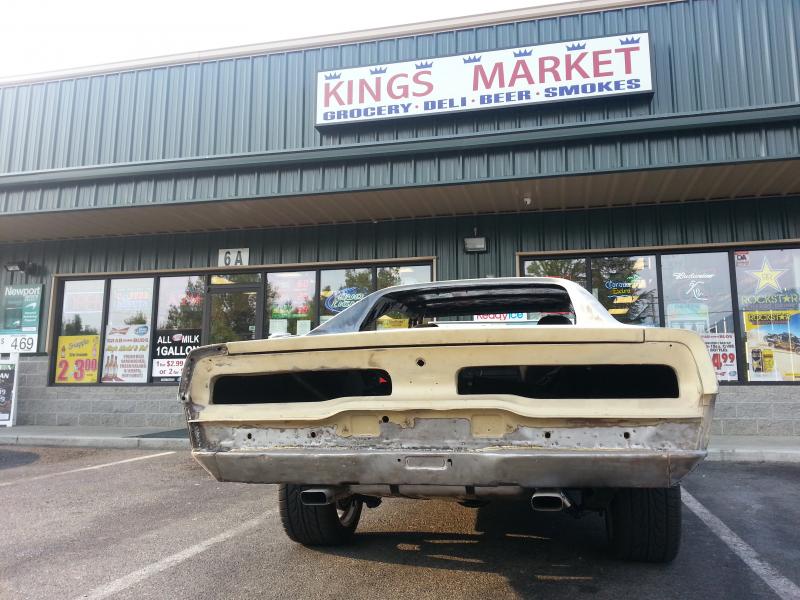

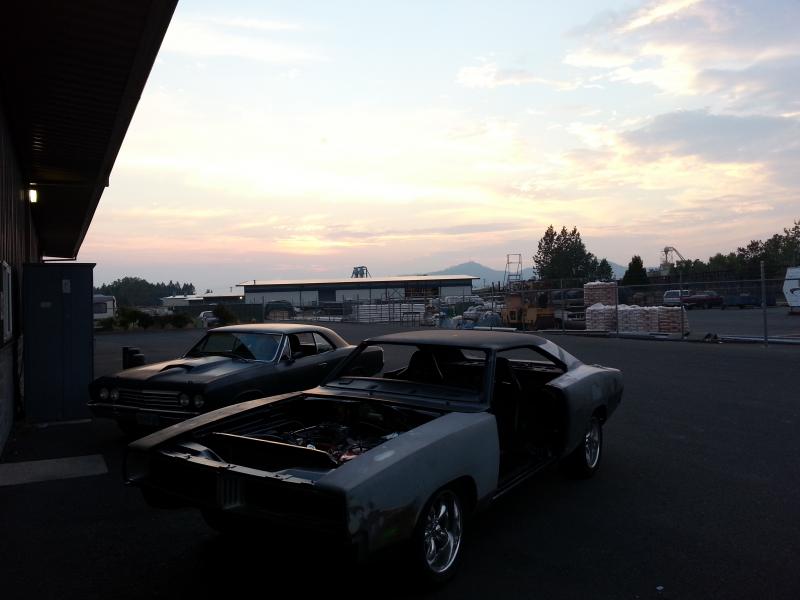

Also took the opportunity to weird up the parking lot at the market out in front of my shop lol people were actually loving it, and by the time I came out with my corndog there was a small crowd of people wanting to ask questions about it. Good motivation for the mountain of body/fabrication work that's ahead of me this fall and winter

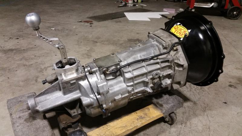

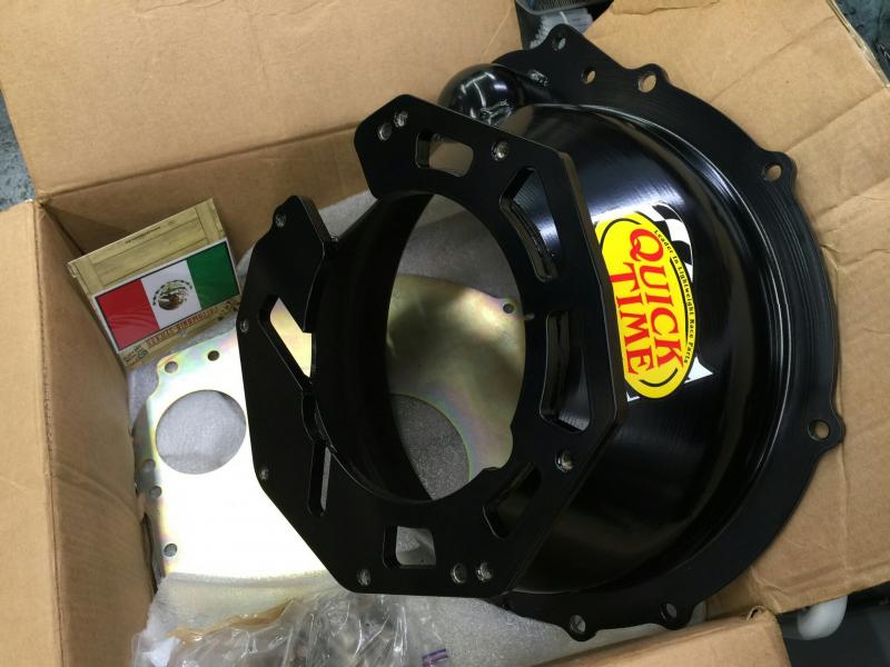

Well the bellhousing showed up all the way from Mexico! Haha
I was lucky enough to score it new/secondhand from a member of the mopar muscle cars facebook page for $530 shipped as opposed to $700 from Summit. And I didn't realize in the pictures how beefy these things are, pretty solid piece!

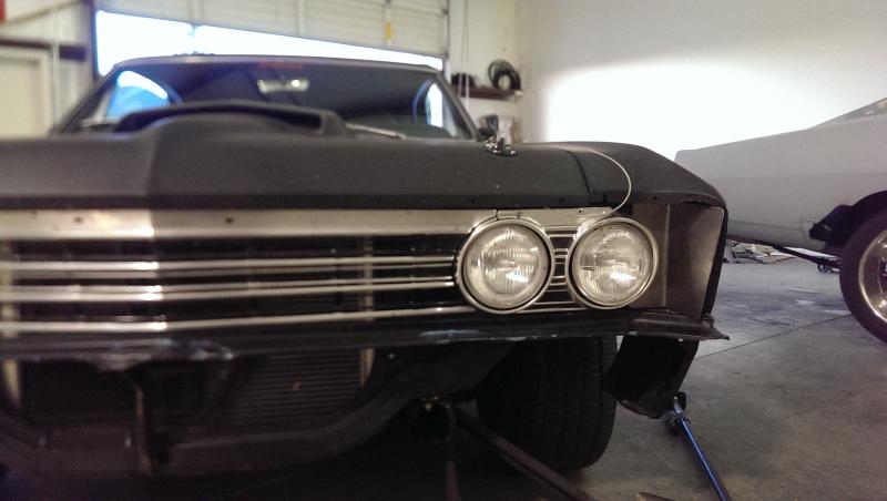

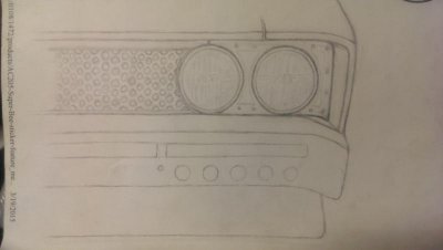

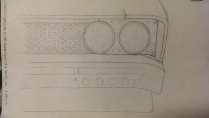

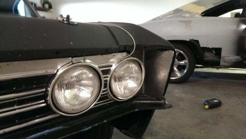

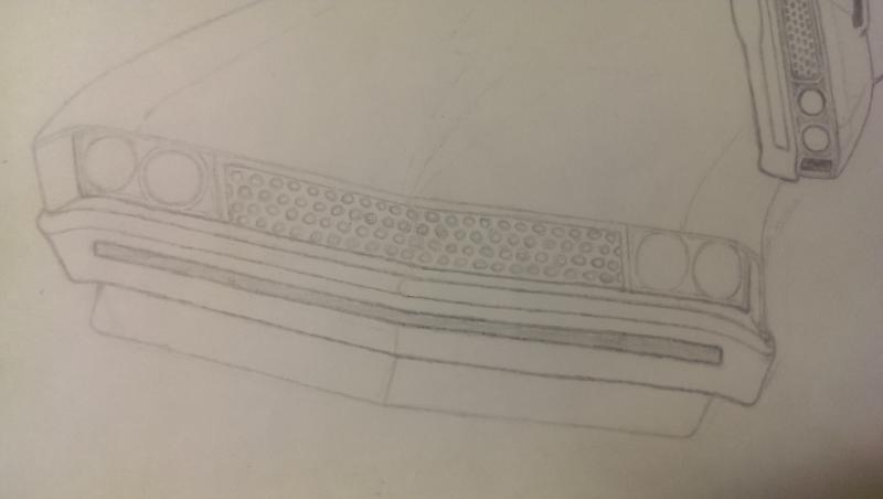

Also an interesting little project I've got going for the Chevelle (told you guys I still had a couple up my sleeve lol), finally got the front end design finished and got going on fabricating everything. I'm really not the biggest fan of the stamped tin chevy grille, so I did some basic rough drawings of what I had in mind
Refined it a little and got into the details

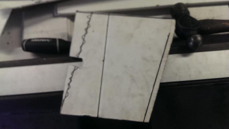

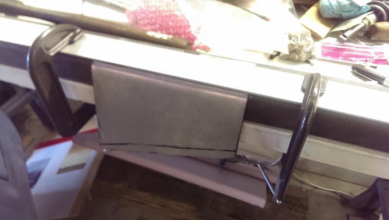

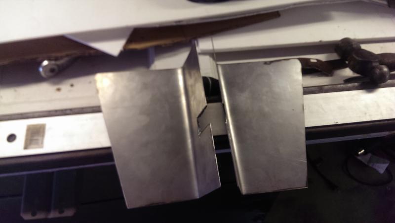

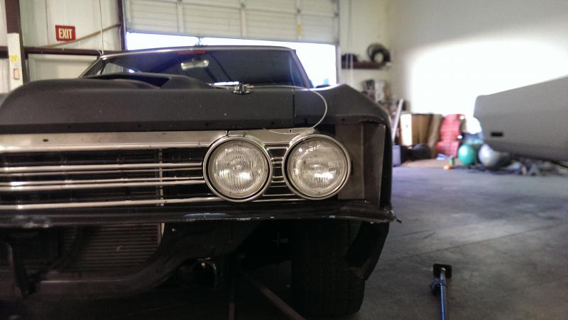

Then got to work! Started with some foam posterboard templates to figure out the most practical way to make the modifications the new grille would bolt to.
Basically I'm keeping the factory lower tie bar, and the grille will be a mixture of perforated/sheet metal and molded carbon fiber, and three piece (headlight bezels and center) a lot like the factory grille was, but I've eliminated the outer "eyebrow" pieces in favor of "buckets" that the headlight bezels will be sucked back into and squared off against. See also: "Charger ish" lol. So I cut out some sheet metal based on my templates and got them bent up using some box steel tubing to give a nice inside radius
And they fit pretty awesome!
Just have to get them welded in, read up some more on diy vacuum bagging techniques, and get after making my headlight bezel molds. Fun project so far though, hopefully it'll all come together and end up like the drawing. More work on the Charger incoming as well
