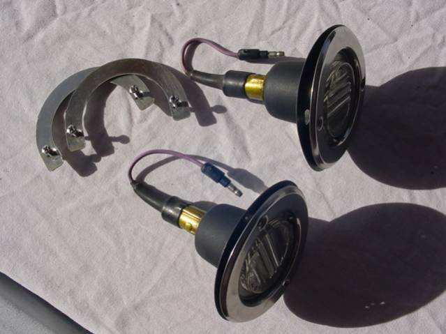

I`ve been into restoring Mopars ( mostly 68-70 B Bodies ) since the mid 70`s & never heard of this. The 68`s had reverse lights in between the brake/running lights in the upper panel. 69-70 where in the lower panel. 69 lights were female connectors & 70 were male like these from my restored 70.

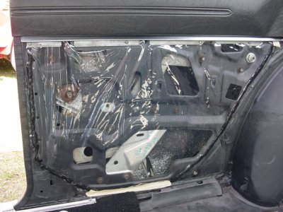

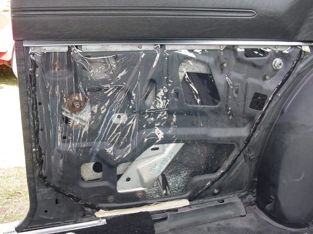

Maybe someone has changed the panel & replaced it wrong?? I bought a 70 twenty plus years ago, that someone rear clipped with a 69 and put 70 aftermarket quarters on it. I didn`t notice until i went to install the rear 70 seat belts that bolt through the side panels , & the factory nuts were not there. On 69`s the rear belts all bolt through the floor pan.
Here`s a pic of my 70 & you can see the nut hole down low & close to the rear wheel well.
