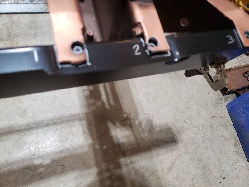

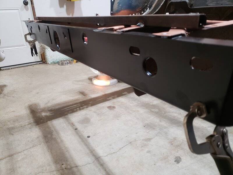

Hey guys. I am trying to install a rear cross rail on my 69 charger project and I am running into fitment problems. I made the mistake of buying a Sherman cross rail and now I am not sure if it has all of the proper contours or if and where it needs to be modified. Does anyone have a pic of the top of the crossrail where the frame rails attach? Any help/tips are appreciated!

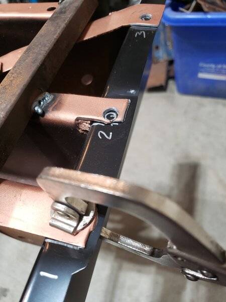

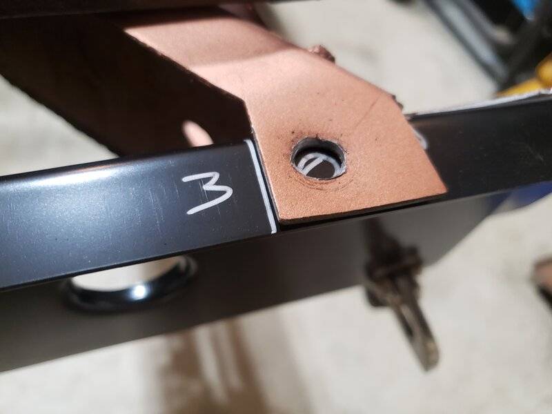

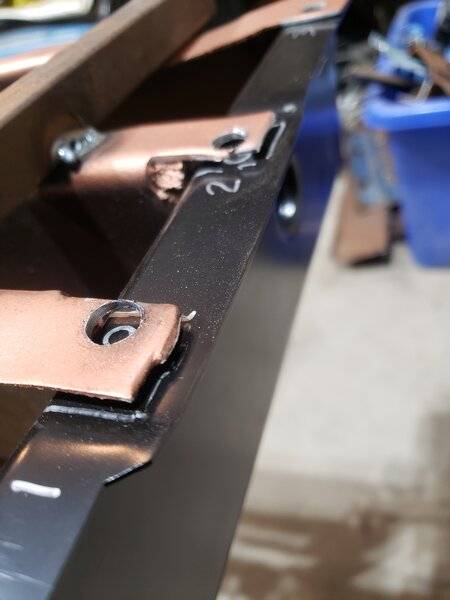

Currently the crossrail is sitting too low. There is an indentation in the top of the rail for #1 and #2. Should there be an indentation for #3 as well?
Is it possible that number 3 goes under the rear cross rail. And number 1 and 2 are on top?
Thanks for the idea. No the lip on the top comes out towards the rear so I think all 3 tabs must sit on top?
Thats a great article for what I am doing right now thanks! It looks like they have bent tab #3 up to allow the rail to come up. I will give that a try and see how it goes.
Ok if you pause this video as soon as it starts you can see the frame rail and the shakle hanger both sit on top. This is a 68 charger known as General Mayhem.... But the 70 may be different.
You nailed it. Tab #3 was just bent down. I bent it upwards clamped it in place then hammered it back down and now its sitting right. Thanks :thumbsup:
