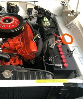

Does anyone have the measurements for the 69 Charger headlight vacuum hose mounting clip hole location? My body guy welded mine up and I would like to locate it as close as possible. I circled the general area in the attached pic. TIA. :drinks:

I've got 6" from the firewall and 3/4" from the inner edge of the inner fender to the center of the hole.
Is there supposed to be two holes for the headlight hoses or is there an difference between plants?

This is my survivor Charger. If you need dimensions, I can post them on Sunday. I'm on vacation right now.
Thank you! I believe there is a dimple there I can use for reference to locate the hole. :thumbsup::thankyou:
The holes are at about 6 1/2" and 18 1/2"......

Here's the dimples in those same locations on my 69 Road Runner.....
Great! Got holes drilled and hoses installed. Thank you everyone for the help!:thumbsup::thankyou:
