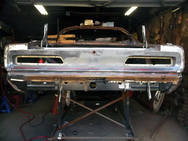

I've been working on this tail light panel for a little while now. I'm about half done with it and I'm learning a lot. I definitely like doing this, it brings out my creative side. I have 2 full quarters for an 80's Ramcharger that I used to own. I'm using them to make the patch panels that I need. The cutting, hammering, shaping, welding, and grinding is relaxing and challenging at the same time. I find that it's easier to make patches that follow the body lines on the car. I'm able to hide flaws this way. I'm not sure if this is the way the pro's do it but it's the way I'm doing it.

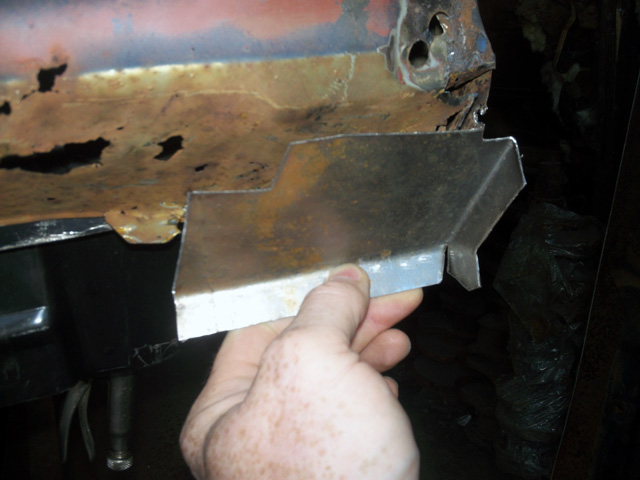

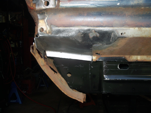

And the next patch to go in. I'm finding that when I make my paper templates for the left side I just flip them over to make the right side.

Looking awesome man! Like the crazy old guy from Vanishing Point would say, "now you're starting to get the, the fundamentals of it son!"
