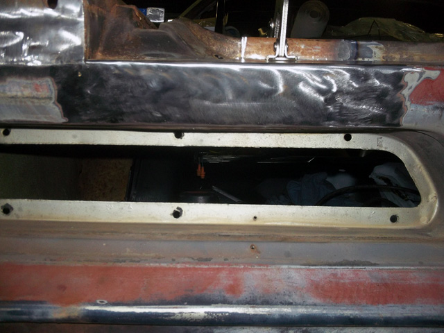

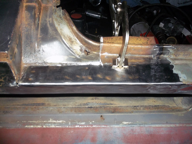

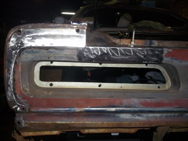

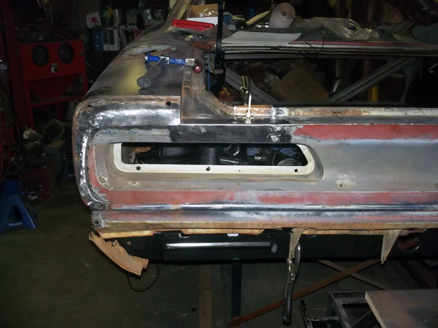

Well here's the next patch in the series. This seems to be getting easier. The only problem I'm having right now is with the top of the tail panel where the deck lid meets the tail panel, there is a rolled lip. What's the best way to make this lip? I left extra metal for the roll.
When my kids came out to the garage they wondered what I had been doing this evening? I had to point out where the new metal was and they both said they would have never known it was a patch.
TailPanelPatch_L_End_08.jpg TailPanelPatch_L_End_09.jpg TailPanelPatch_L_End_10.jpg TailPanelPatch_L_End_11.jpg

Would be pretty tough to roll that lip with a majority of the patch welded in place. Kinda of an off the wall idea, but you could half a brake or fuel line (width wise) of the same diameter as the rolled lip then graft it in place to recreate that roll. Out of the car, a vise, dolly, hammer and the sheetmetal worked around small diameter rod could get you close. Either way, Patch work continues to look great! Keep up the good work.
Put a copper pipe on the inside of the roll you want to create, then take a ball peen to the steel or something along those lines to bend the lip around the pipe. That's what I would do, but I'm a "all go, no show" kind of guy.
I'd try taking a shot at forming it to a rod of some kind, but like Will said it's probably gonna be tricky with the patch welded in already. The fuel/brake line graft is an interesting idea if all else fails though, I'd keep it in mind!
Thanks for the input on the rolled lip quandary. I ended up using a file and hammering the metal over that. It worked pretty good and it looks like the rest of the lip. The problem I have now is that I went to weld it together and I ran out of wire and gas! :BangHead:
Awesome, glad you got it taken care of. Those "Mcguyver Moments" always feel good when you can make something work and look good that isn't necessarily meant to.
