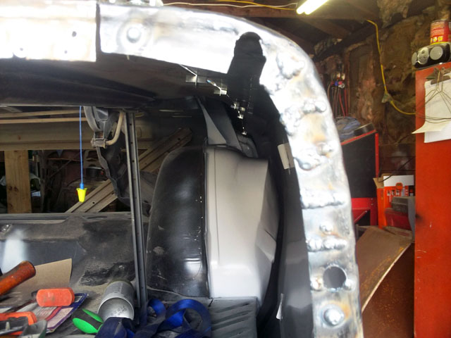

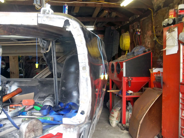

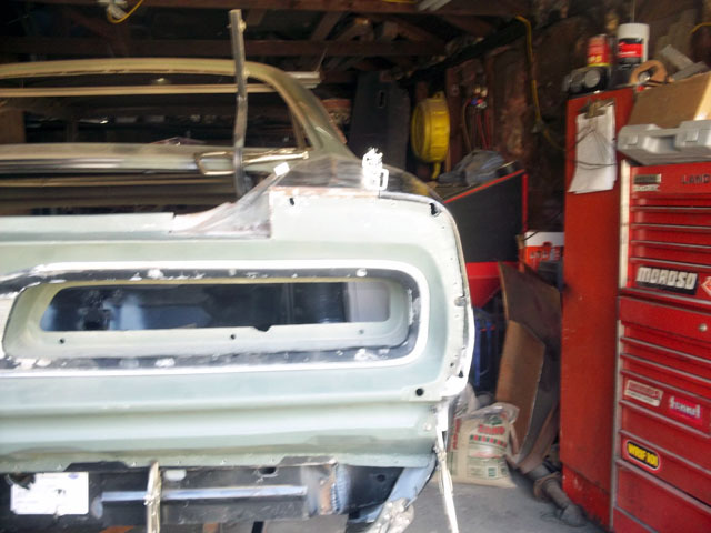

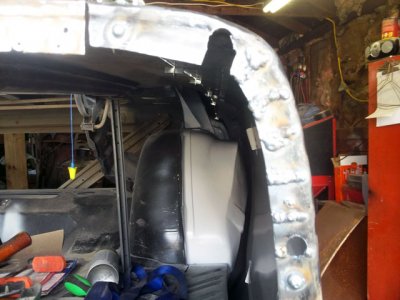

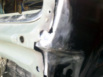

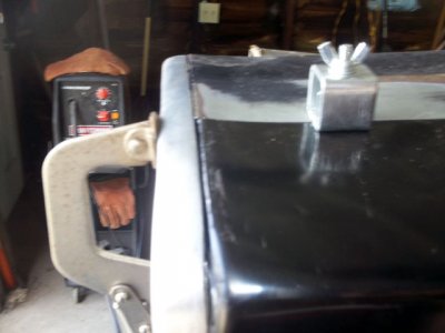

Ok it's been two days now of shear frustration. I'm holding off on the floor till I can get my compressor fixed so I switched to the quarter skin. The big stuff went off without a hitch. I decided to cut the old quarter on top of the old quarter, not on the side. I did this because the old quarters were cracked at the doors and this removed most of the crack. I cut the old quarter off using the new one as a guide and that went beautifully. My frustration is with the end that meets the tail panel. Because it's a skin, the attachment point to the tail light panel is very minimal and does not go all the way down.

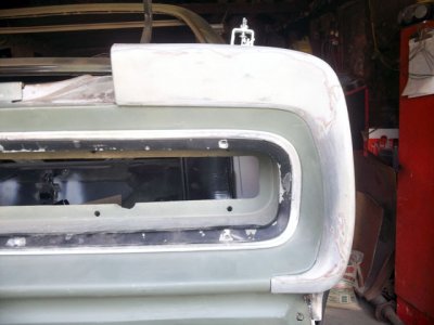

I ended up making the flanges that I needed to attach to the tail light panel.

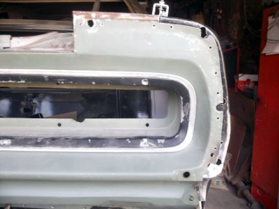

I also had to build this corner under the end cap because the skin went straight down. That was fun!!! :angryfire:
It looks horrible but for the most part it matches up with the end cap.

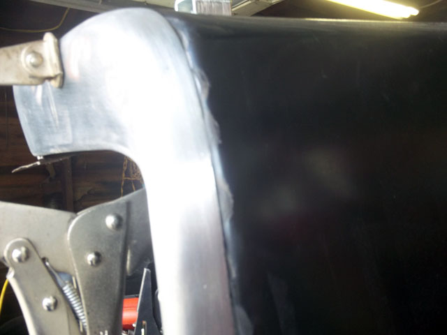

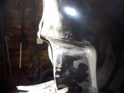

My new problem and the source of me wanting to beat this skin with a sledge hammer. the skin goes straight down to the center body line and the end cap has a curve to it. The skin is off by a 1/4 of an inch. It's good across the top and it's good on the bottom of the end cap but the middle sucks ***! I don't know how to fix this. anybody have any tips on what to do? I'm at a loss right now.

Got my problem with the quarter skin figured out. It was one of those things where I knew what I had to do, I just didn't want to do it. I made some cuts in the end of the quarter so I could put a slight curve into the panel. From there I welded up the cuts and ground them flat. Iworkef and now it all fits together nicely.
