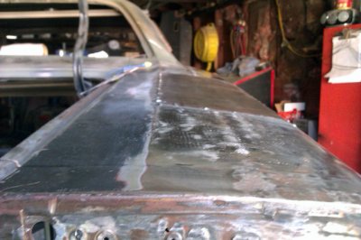

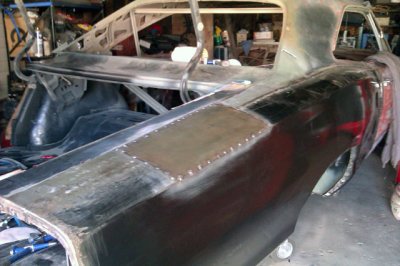

Well after fighting with the quarter all day I changed things up a bit. I cut out the section that just did not want to cooperate and welded in a new section.
Wah la it's now straight. When I cut this section out the quarter sprung so I obviously welded tension into it and that's probably why it didn't want to cooperate.
little grinding John and it will be as good as the rest! Better now then waiting and finding a problem...
Oh my is that bringing back some bad memories from my hood, weld it in cut it out, weld it in cut it out. Really glad to hear you showed it who the boss was and got it straight.
It's funny but patching in new metal seems to be the answer to most of the problems on Scar.
Thanks 7, Scar won't get the best of me and by the end I'm going to be quite the expert on Coronet restoration lol.
Nice progress man and nice job putting the hammer down on that uncooperative quarter. Looking back I probably should've saved myself some work and done full quarters on my car as well. But oh well, live and learn and like basketcase said if it was easy everyone would be doing it haha

Right now I'm still going, "Screw it I'll put on a whole quarter, No I'll keep going and fix what I have, Screw it I'm putting on a new quarter, no........". At some point I'll figure out what to do.

Nice work man! Good job jumping that hurdle. A bit of skim coat, bit of blocking and that headache is long forgotten.

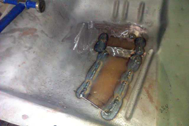

In between the rain today I did get out to work on Scar. (That name is really growing on me) I went back to finishing the floor pans before I continue on to the next.
I got the patches installed in the underseat pan and the pin holes welded up. Now I can install the left rear footwell. I'll start fitting it in tonight. :)

Like you I had to learn allot while I went since most of my previous repairs were just patching small spots. When I warped my hood I ended up cutting the weld back out to release to stress and then re-welded it being even more careful. The big headache to me is the welds from the MIG are so hard you can't hammer them down to reverse the shrinkage meaning you just have to be really careful and slow and pray you don't warp it to begin with. Good luck
You're pretty picky and do some impressive work so I'm sure you'll get it one way or the other.
Thanks for the kindness and now that you said it, I guess I am sort of picky haha. My biggest problem with welding right now is heat and learning how to slow down. It took me about an hour to weld the top joint on the quarter and it probably should have taken me all day, I've never been one for going slow. The other problem is, I want to make sure I get full penetration on the weld so I hold it a little too long. As you can read, I know what the problem is, I just need to learn how to fix it.

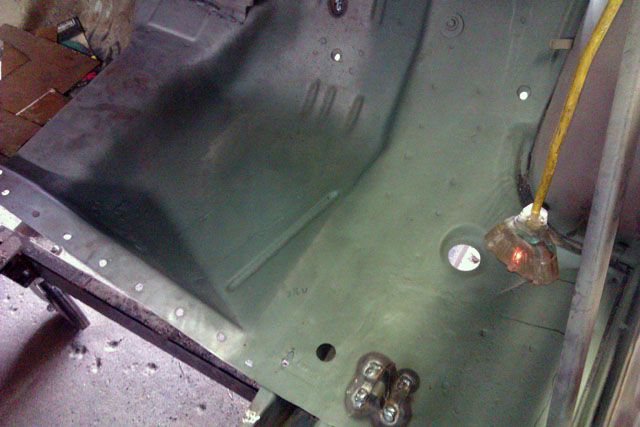

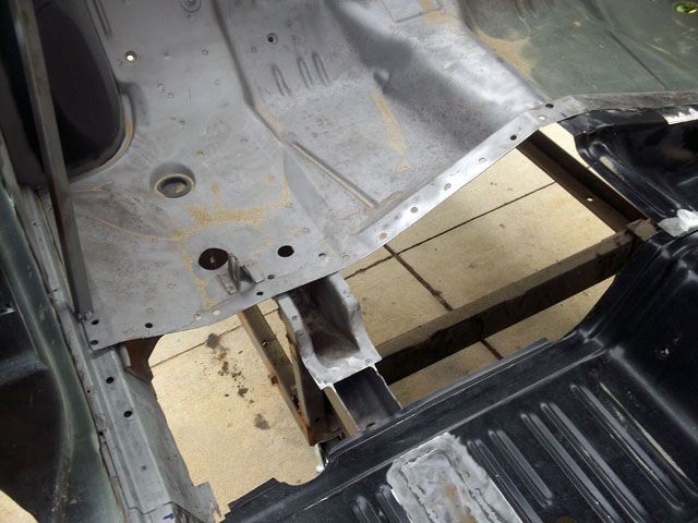

Hi all :hatwave: It's been awhile but the internet at my house was down. I finally got the floor and sides blasted. My compressor broke but my sons friend let me borrow his so I could finish up the rear seat area. I also finished welding in the floor. I still have to clean up some of the welds but other than that the floor is behind me. :)
