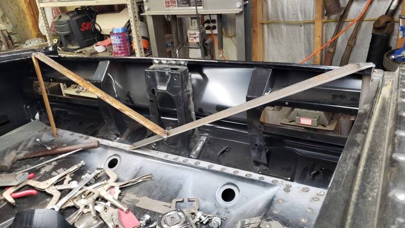

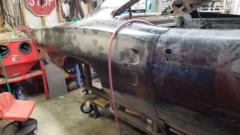

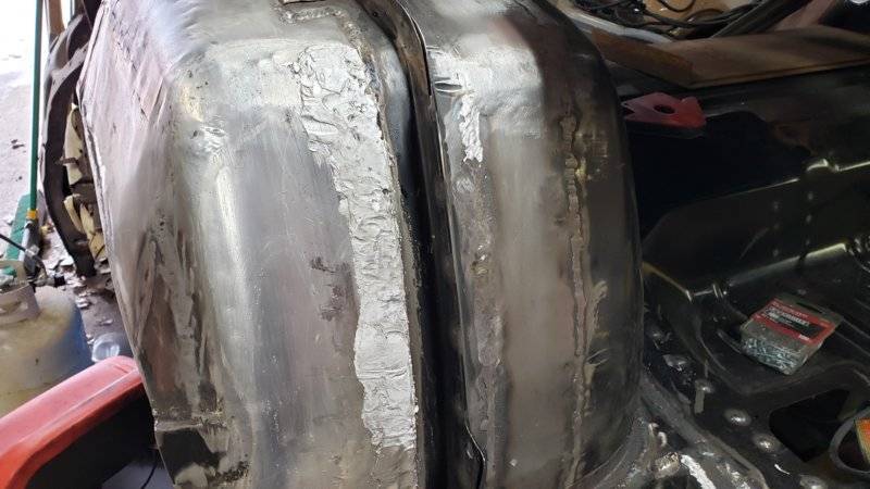

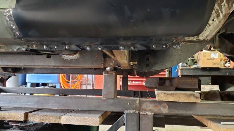

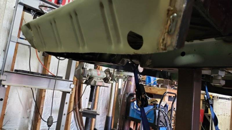

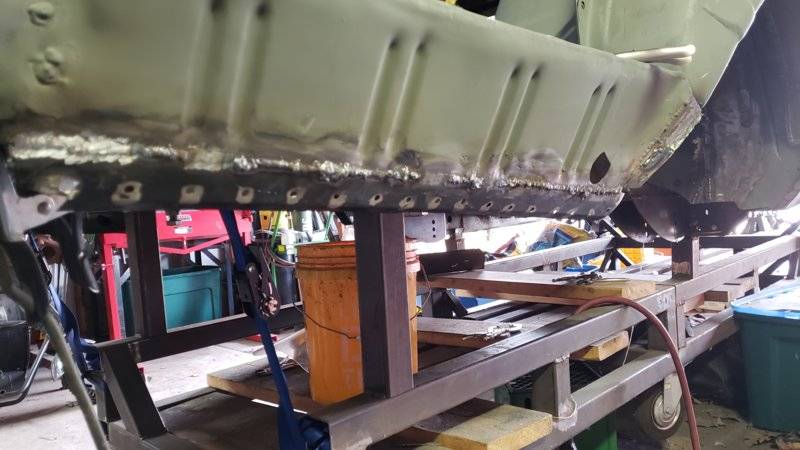

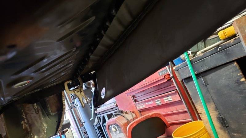

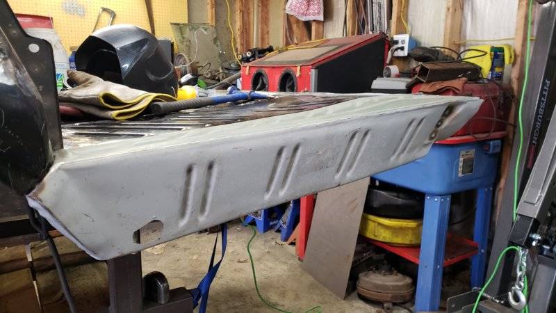

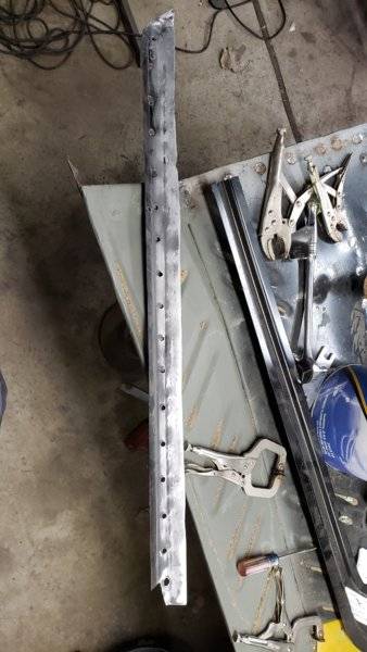

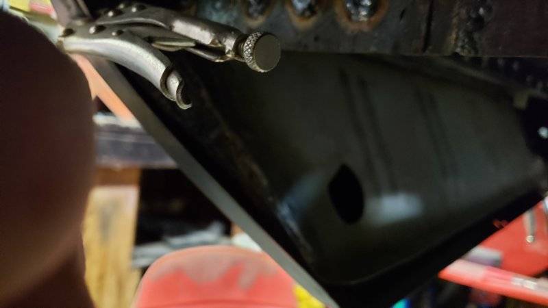

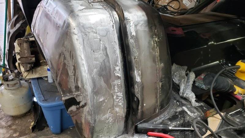

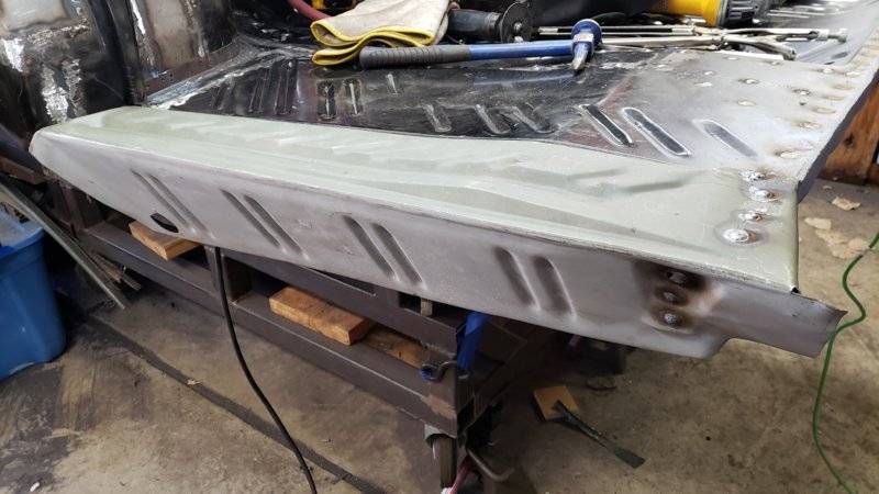

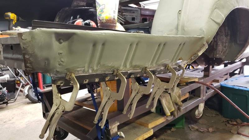

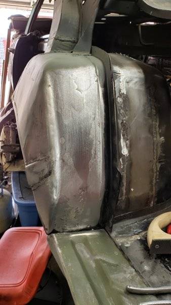

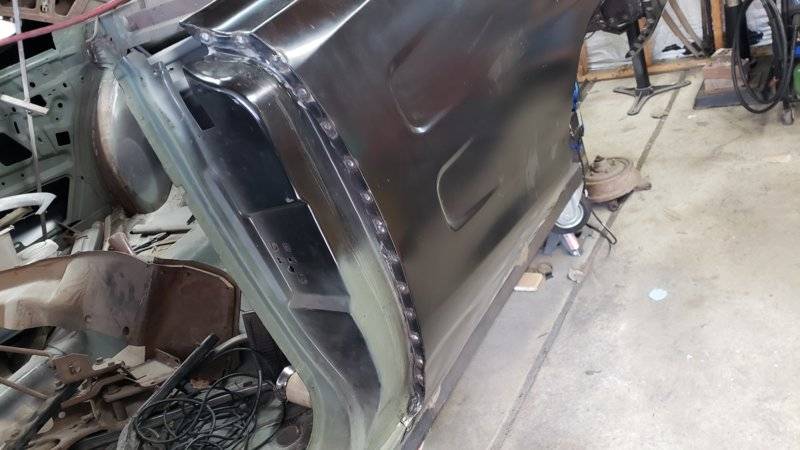

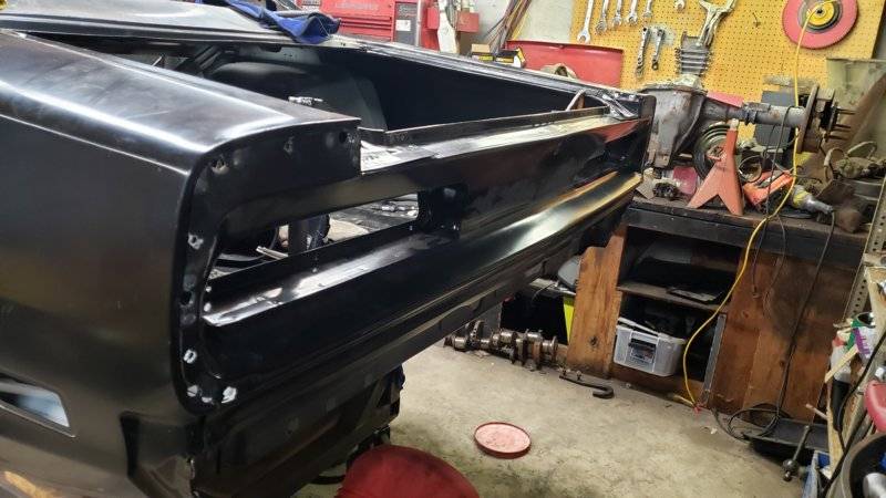

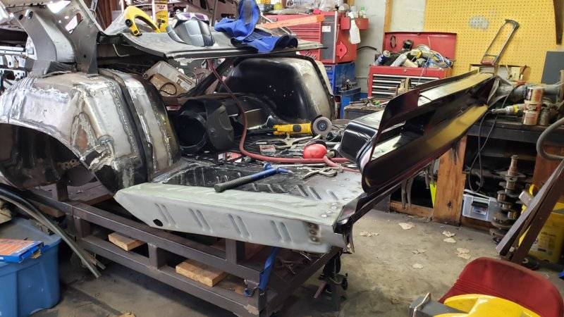

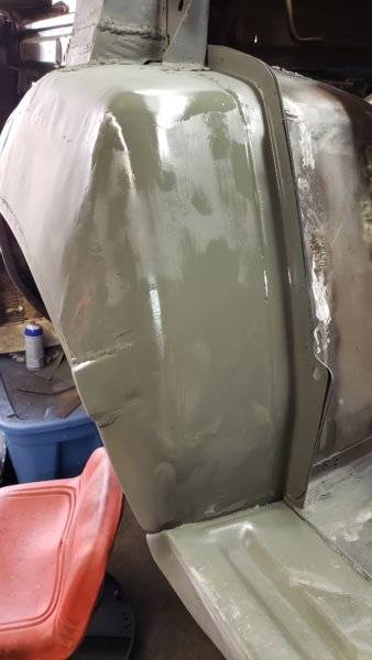

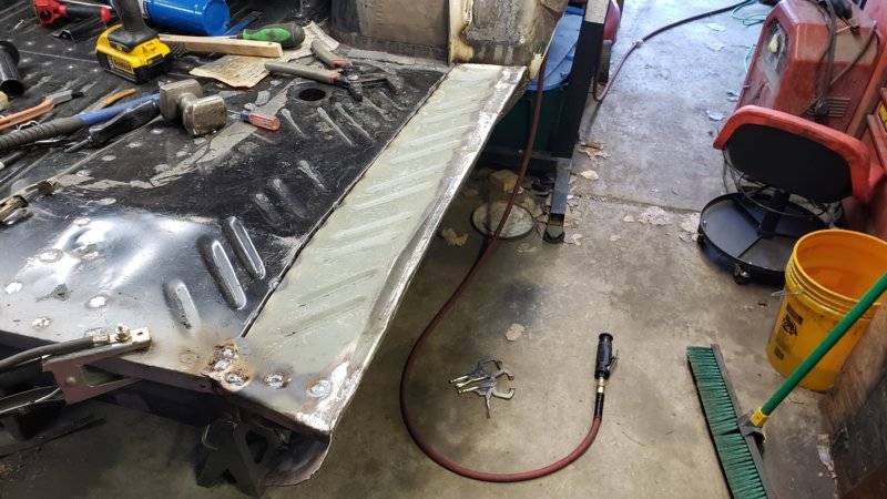

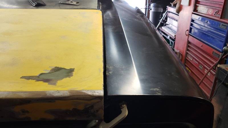

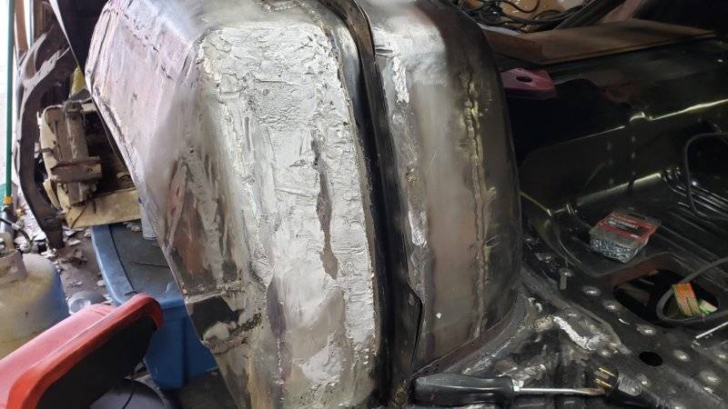

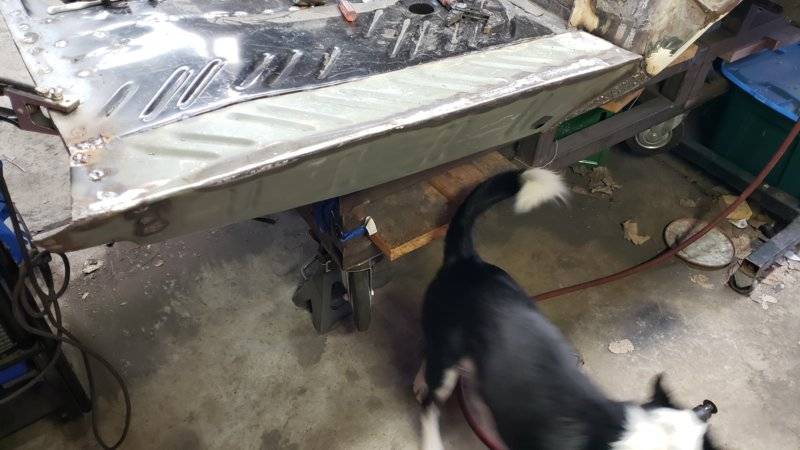

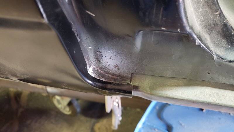

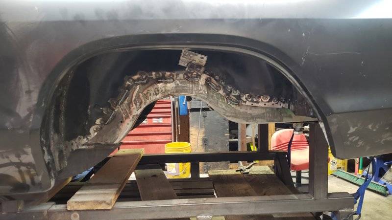

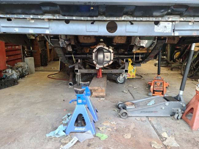

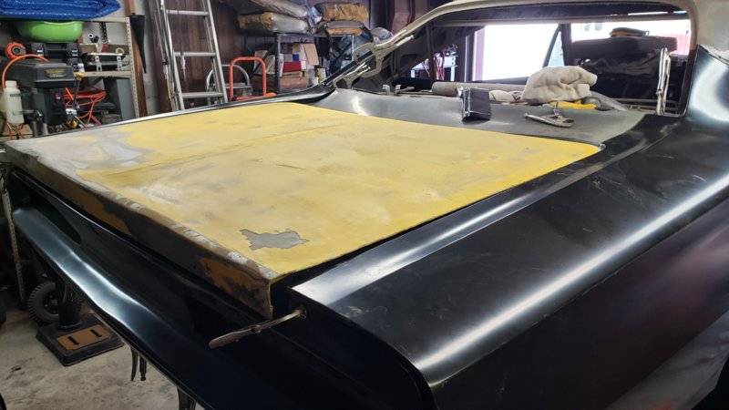

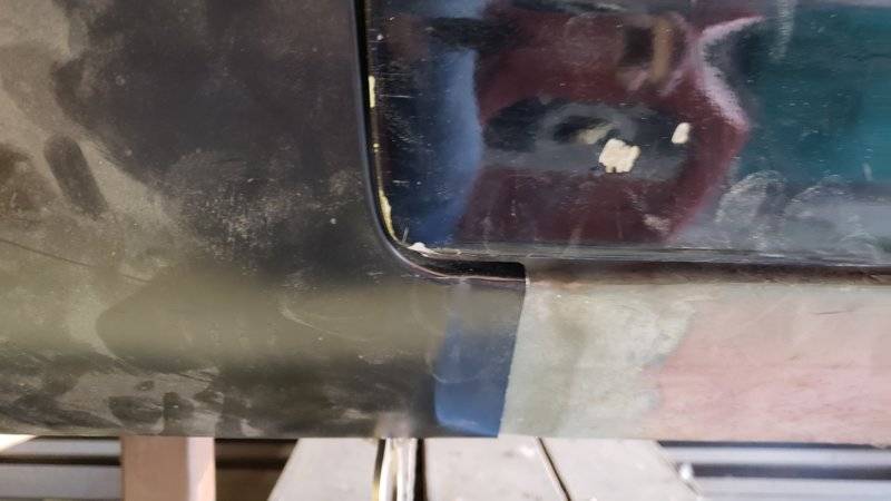

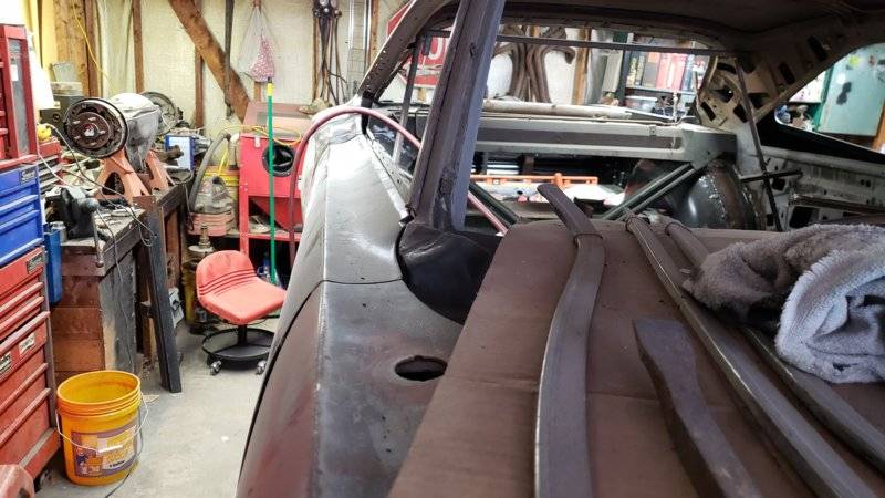

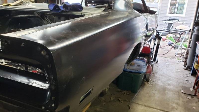

I got the trunk extension burned in today. Well at least partly burned in. I came home from work and went straight to the garage still in my work clothes. I got the holes drilled and the front and back welded but to weld the extension to the trunk floor I will have to sit on the floor. I'm not doing that in work clothes. My thinking is that the trunk floor is square and centered. the extensions have to line up with the wheel wells, trunk floor and the bumper mount. Everything else lines up to that combination. As long as the floor, extensions and wheel wells are solid the tail panel and quarters will have a solid foundation.
