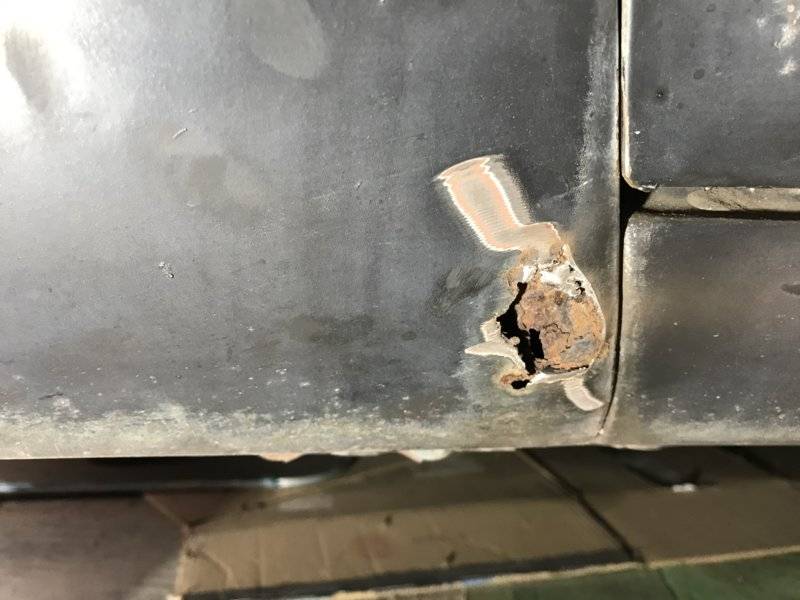

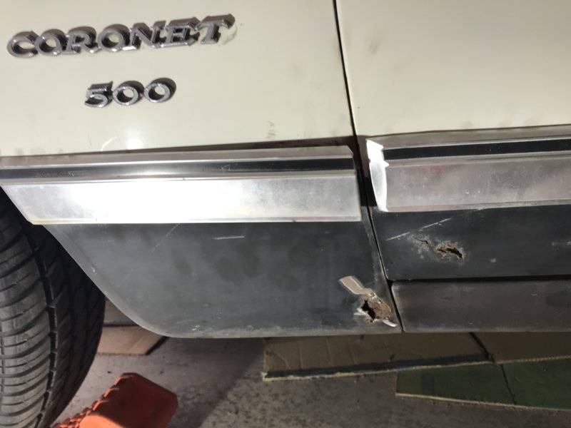

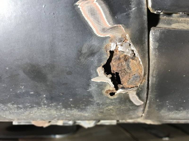

Hey everyone, anyone have a link to a thread or information on patching fenders on a 69 coronet? I have a small hole that needs to be patched in my lower rear fender. Does anyone know if I can use a lower rear patch panel from a road runner or charger? Any info is helpful, I’m including a pic with a mark where the rott is. Thank you in advance!

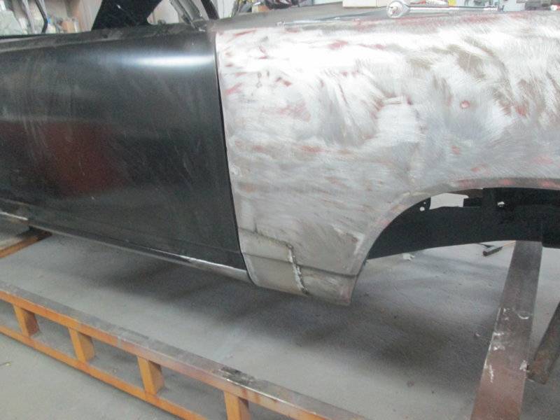

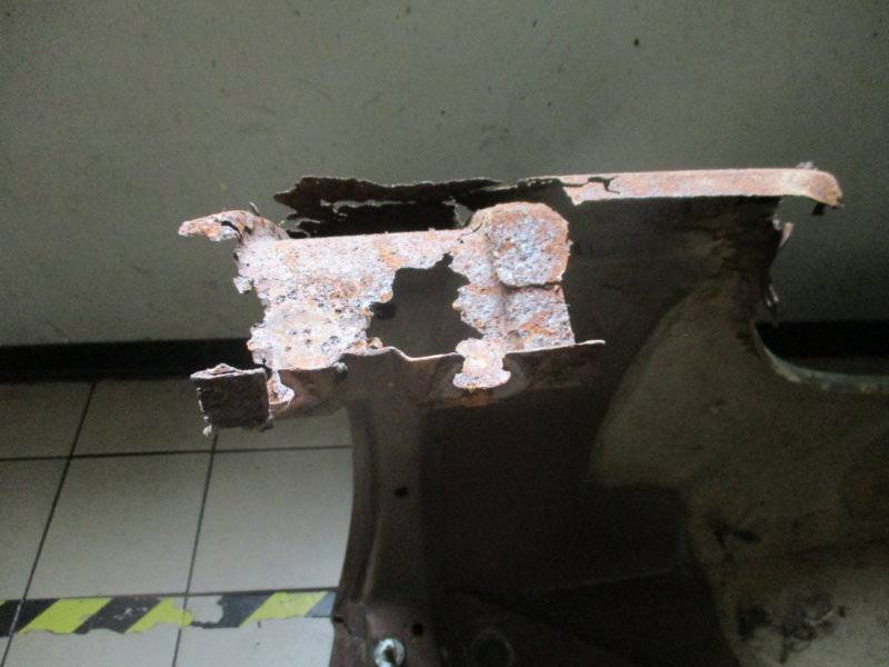

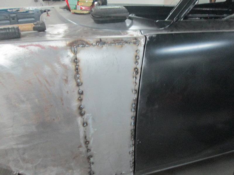

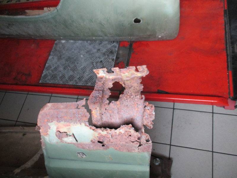

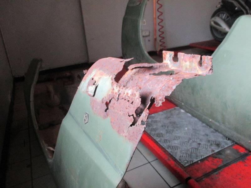

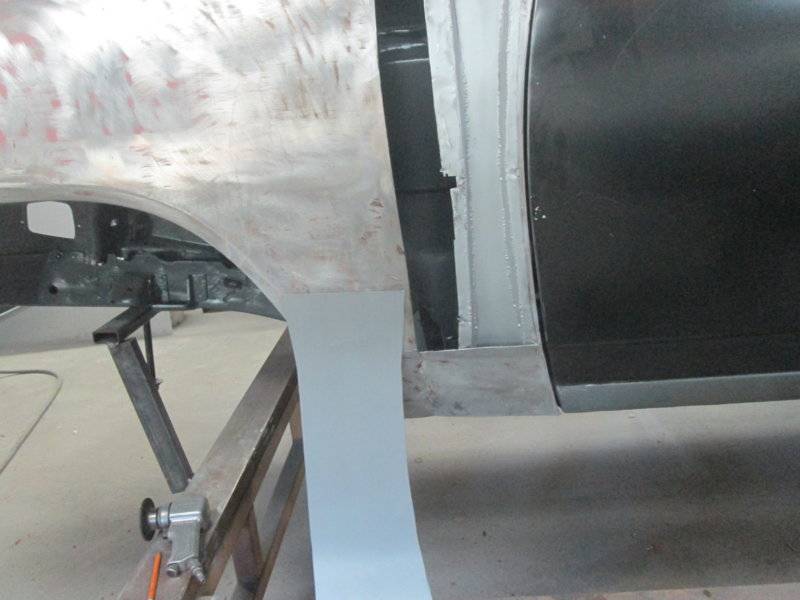

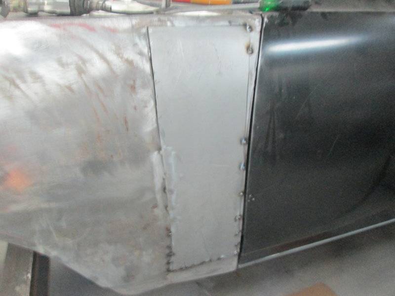

Many times it's only a small section that is bad, cut it out and replace it. Better than any repro patch you're gonna buy.. especially for a coronet as you can't buy repro fenders for one!

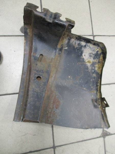

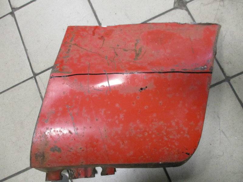

I used the bottom part of the charger, 3 centimeters below the line
