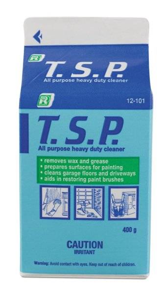

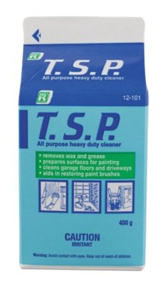

Lionized I appreciate you jumping in here and your advice. Educate me please, what is TSP and Argent paint....name brands for something specific?
TSP is Trisodium Phosphate. Available at your local Home Depot. It's packaged in a small cardboard milk carton type container. It's used to prepare/wash items for painting.
