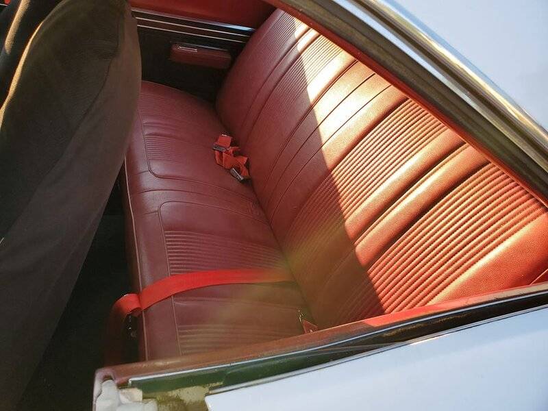

What frames can I use for my '69 Coronet front seat. I'm looking to replace the wrong buckets that are in it with either a bench or buckets that I can cover with the correct covers. My back seat.
For bench seats
68 works but probably won’t have provisions for headrests. 70 works as well and will have headrest Provision but will need the seat back release latches from a 68,69 bench
