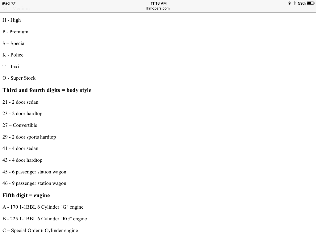

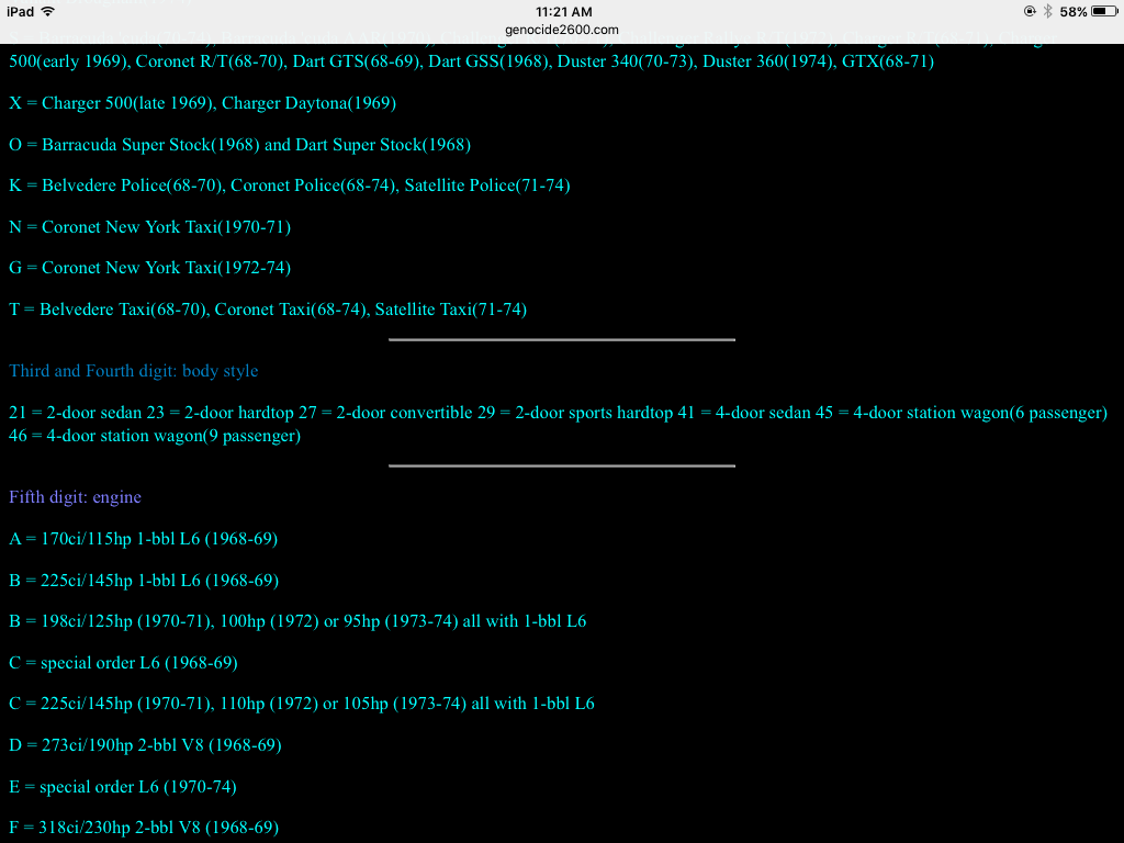

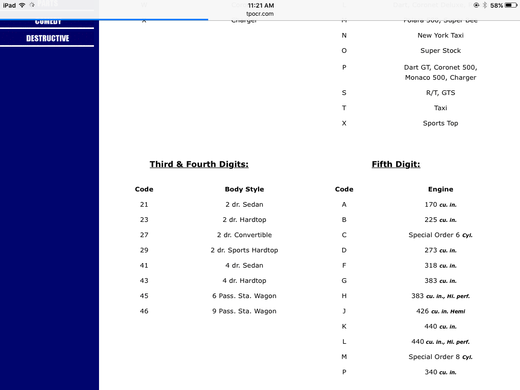

A coupe would be WM23 the sedan is WM21
List
You just don't see a 2 door hardtop being referred to as a sedan
It's the opposite
21= post fixed window coupe
23= roll down window sedan
You don't see 2 door hardtops being referred to as sedans. Sedans have a b-pillar, at least in my literature and the 2 door hardtop is not referred to as a coupe in the same literature.
thought 21 was sedan
For some body styles it is, say a 68 C body PE21 Fury I, for some it's not. The 68-70 B body two door with pillar and pop out window body code 21 is referred to as a coupe.
The definitions of sedan and coupe seem to have changed over the years.
well i guess i've learned something new today:thumbsup:
thanks
FWIW.....most online sites and decoders get it wrong too.....
I could be wrong here but 67-69 barracuda fastbacks come to mind here
Cool. Now try and distinguish the variations of the 29 code ;).
I could be wrong but 67-69 barracuda fast backs come to mind here
it gets confusing,
different companies call it different things at different times..lol
to confuse you even more,
when you get to 71
they are all called hardtop sedans and all are 23,there is no 21
and the fixed side window coupes are a option A93 on the fender tag..
