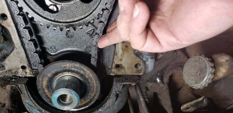

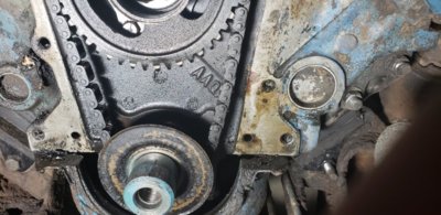

And below...my fight with the timing cover...bolt was seized in the aluminum and at the threads...and just a little chain deflection from the ancient cogs.

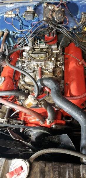

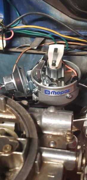

Ok...Cam is in...battery fully charged...tin covers are on...distributor is in and set about 8 degrees BTDC..radiator in..tranny lines reconnected...finishing temporary tach wiring...just need to tighten up the lower radiator clamp...add water...burp it...install thermostat and housing..and hose...prime the carb...pour in the cam breakin additive....say a little prayer to the Lunati Cam Lobe God of Strength....and turn the key...wish me luck.
So comp cams came up with a breakin for flat tappet with stamped steel rockers (check you tube) and it is supported by Golen engine builders...so I figured why not...just a minor variation of 3 10 minute run cycles with 10 minute rest cycles in between and using 2500-2800 rpm. So round one...saw minor seepage from the new coolant hoses..no biggie..turn the screw.....no tick..no knock...65psi oil....sounds strong
Round 2.....I topped off the radiator...fire it up...right to 2500 rpm as fast as I could turn the screw. ...5 minutes in...no odd noises...up to 2700rpm....5 minutes...no odd noises...idle down to 1500...off goes the key...
Just as I am patting myself on the back for taking care of the sleeping coolant from round one..I'm standing back about 3 feet admiring my handiwork thus far....
All of a sudden the sound of an m80 under the hood...my ears are currently ringing as I type this....Old Faithful came all the way down from Wyoming to Texas to pay a visit....
My upper hose exploded off the water neck and sent a hot jet of water and some traces of coolant everywhere....post mortem inspection shows the clamp slipped.....I think I need a lesser psi cap....and a mop.
