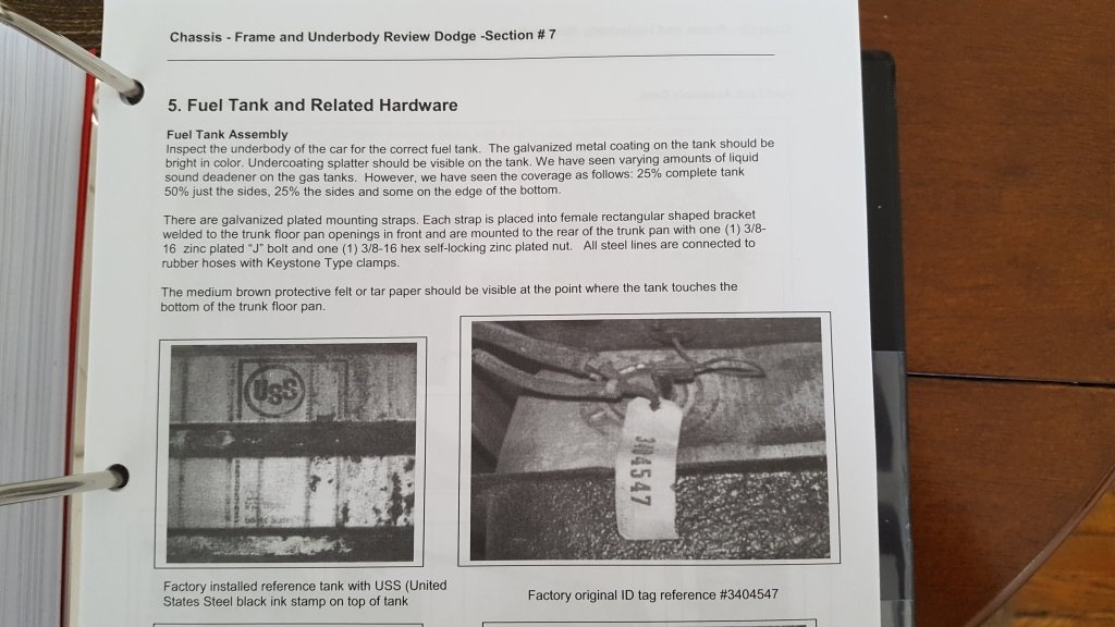

Did the gas tank straps have anything between them and the tank, or were they metal to metal?

Can't comment on the dash, but the gas tank straps have nothing in between them and the tank.
I think they were plated. They had to be, mine had so little rust there's no way they were bare. I replated mine when I restored the car instead of using new ones. I'm not sure if the dash pad I used is ABS core or not, I bought a repro off B,E& A. I think it looks great.
If it's just a driver, then you might think about one of the old "dash pad caps" that cover the dash pad. They're cheap & you don't have to disassemble your dash to install them. Also, the tank straps were zinc plated I believe, but you can buy reproductions for most cars & rattle-can paint is OK in my opinion for a driver.

Thanks for the reply. Were the straps coated or painted, or just bare steel?
Dallas
Gas tank straps originally would have been galvanized...
