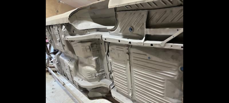

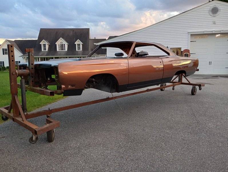

After spending money like a drunken sailor for the past two years, I've got almost everything I need. Still another $5-10K to go I'm sure but a good chunk spending wise is behind me. I dug it out two weeks ago and put it on the lift to get ready for the rotisserie and finally got it on yesterday. Now I can strip the floor and make that as pretty as the top. (I know, backwards but, I bought the car painted so didn't really have a choice).

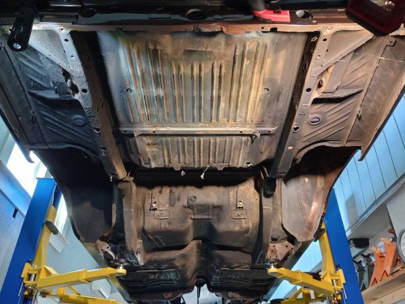

Should have posted these back when it was done but ... it did NOT go as planned and I was a bit disappointed.

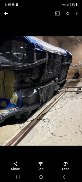

They did strip the entire under side and prepped & painted it with POR-15. Once stripped, we found the undercoating was hiding some minor damage. Not the end of the world, just the first of many kicks In the midsection.
No 2 kick was, they didn't clean the media out before spraying so ... there are places that are very "rough". I know, it's the bottom of the car but damn, I'm trying to make it nice, driver or not.
But the real kick was the over spray all over the near perfect paint. Apparently they didn't tape it off as good as they thought and the entire car was effected. Luckily, I was able to whipe most of it off with lacquer thinner on a rag and then had to rebuf the whole car. And that's after he charged me all most double what he quoted me.

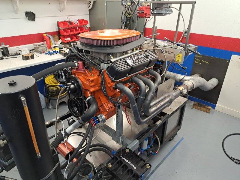

Fast fwd to current date and the engine is assembled minus intake and trinkets.

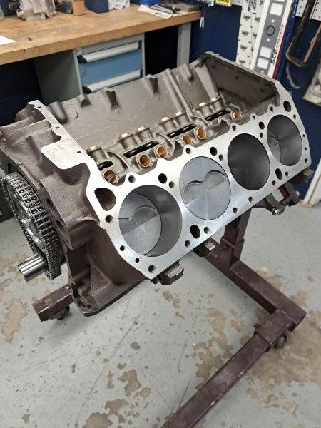

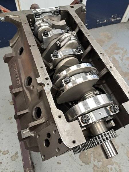

As you can see, I dial indicated the seal retainer and added a screen to the windage tray. I also bushed the lifter bores for the hydraulic roller and used the Johnson lifter to oil through the pushrod. Each bushing has a .040" hole to limit the volume up the tube but still keep the critical points lubed. I tapped the block and put .060 restrictors in the feeds so the shafts still get oil directly too, just not as much.
If you look close, you can see I lathe cut the counter weights (no holes balance).
Should be on the dyno next month.
Stay tuned for results

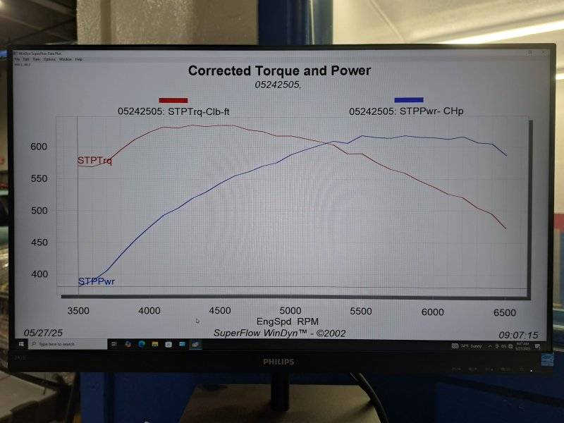

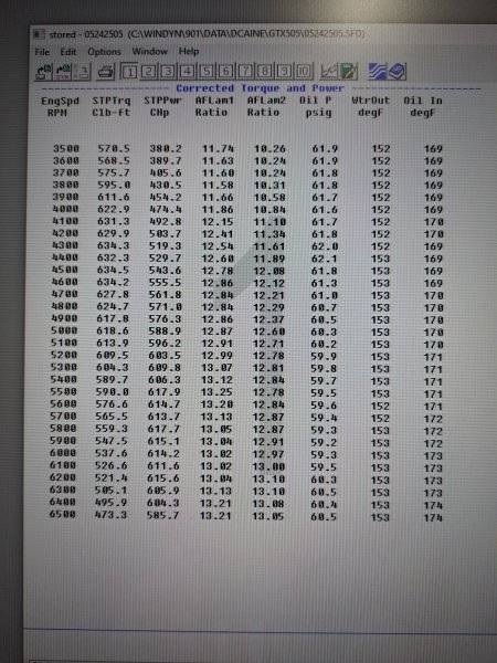

Dynoed the engine Saturday.
Very pleased with the results!
Idles nicely with 12 inches of vacuum at 800 RPM. Incredibly crisp and VERY responsive!

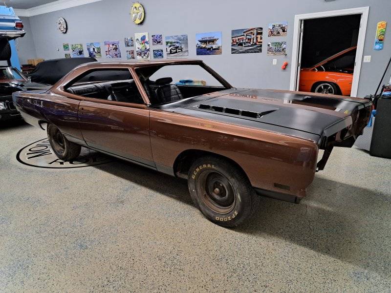

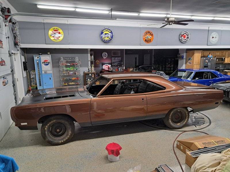

Spent yesterday removing, cleaning, greasing and re-installing the rear window regulators & quarter glass. (Still on the hunt for proper drivers door latch & regulator)
Also installed the fender mounted turn signal indicators. I tried putting the side molding on but the hardware kit is a but of a mystery to me. There's a bunch of plastic clips that barely fit in the molding and do NOT fit in the holes of the car. And there's 8 pin type clips that fit but I don't know why there's only 8 or where they're supposed to go exactly. Any help here would be greatly appreciated.
Hoping to order some stuff for the Dana this week so I can get that back together and maybe back on 4 wheels soon.
