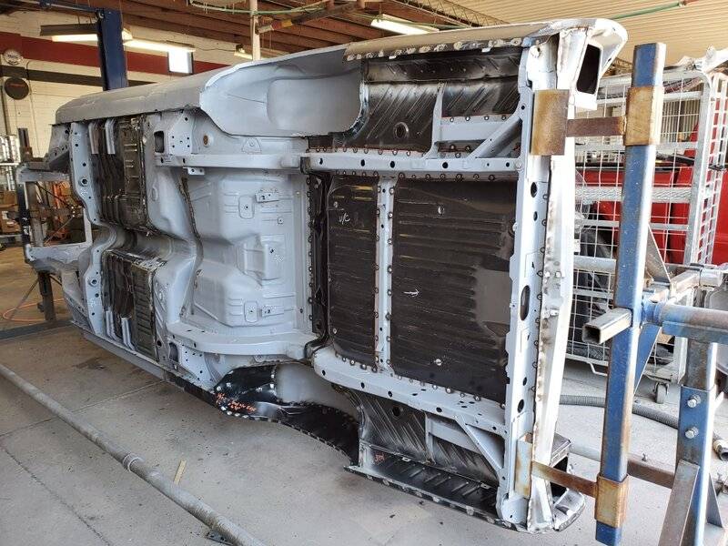

As stated above the bottom are the same coupe and convertible. I had damage on my upper that could only be repaired. Cut the AMD reproduction wheelhouse apart and rebuilt it.
