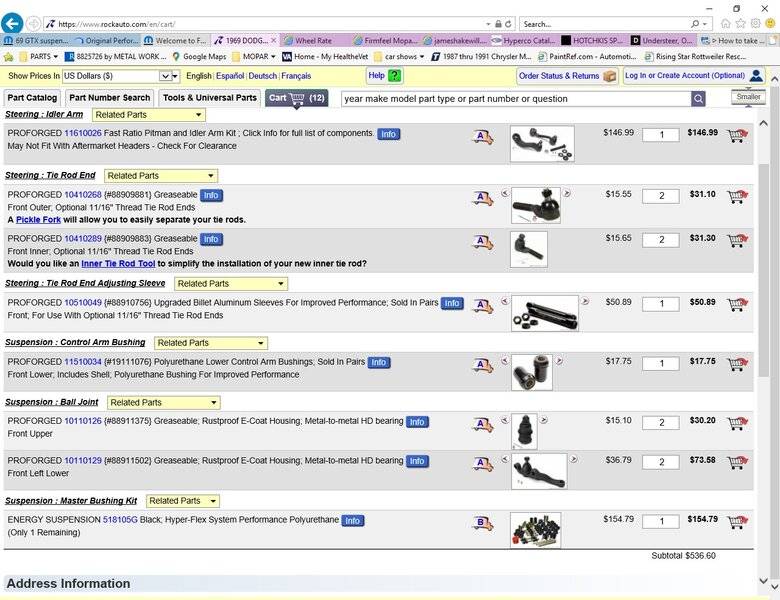

While the front end is apart another item to think about, depending on time and budget, is having Firm Feel rebuild your steering box. They have three stages for power steering - Stage I replicates the stock feel and III is the firmest. I went with the III; nice 'heavy' feel at low speeds with great response at high speeds.
I did everything mentioned in the prior posts using a combo of Moog and PST. I also installed the PST aluminum barrel-shaped tie rod adjusters, C-body size. Shocks make a big difference too - I recommend Bilsteins if the budget allows. All the above suggestions along with the disc brakes will make the GTX a pleasure to drive.
