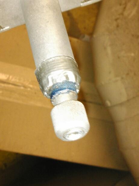

So did a little work last night. Bead blasted pedal assm. parking brake, some misc. brackets and my wiper pivots.
So you can see they were a little crusty. I soaked them in the solvent tank to free up some of the crud before I started.
As you can see I wrapped a rubberband around the crank end to keep silica out of the housing. I also used duct tape on the other end to cover that end. I tried to barely cover the opening and made sure I pointed the nozzle so it blew over that edge to clean.
Then I peeled the tape off and put it on the other way to get what the tape had covered. After blasting that area I peeled the band & tape off wiped the area off then wire wheeled the area that I couldn't get.
You can see the blue from what the tape covered the first pass. Now I'll paint the arms and top with a zinc paint. Next will be seal kit from Schumaker and then instal. My wiper motor is getting done as we speak so it will be the first thing back under the dash.
