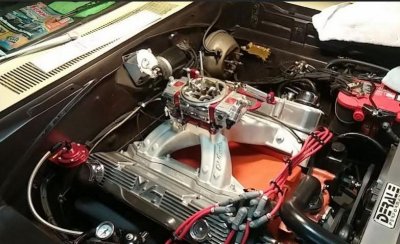

So this first test is with the Victor single plane with max wedge ports. So needless to say it's not optimum but a bench mark.
Oh BTW latest update 591HP & 562 ft lbs.
Haven't done anything but fiddle with the fuel mixture and a little bit of timing. This engine is going to run with a 6-bbl so we aren't wasting a bunch of time on these other combinations.
RPM..................Victor TQ/HP..................RPM TQ/HP
3000...................472/269.......................495/283.....+23/+14
3100...................468/276.......................500/295.....+32/+19
3200...................483/294.......................515/314.....+32/+20
3300...................500/314.......................541/340.....+41/+36
3400...................513/332.......................546/354.....+33/+22
3500...................514/342.......................547/364.....+33/+22
3600...................516/354.......................550/377.....+34/+23
3700...................510/359.......................552/389.....+42/+30
3800...................516/373.......................555/401.....+39/+28
3900...................520/386.......................555/412.....+35/+26
4000...................528/402.......................558/425.....+30/+23
4100...................529/413.......................553/431.....+24/+18
4200...................532/425.......................553/442.....+21/+17
4300...................539/441.......................548/449.......+9/+8
4400...................545/456.......................552/462.......+7/+6
4500...................550/471.......................554/475.......+4/+4
4600...................554/485.......................553/484........-1/-1
4700...................552/494.......................550/492........-2/-2
4800...................562/513.......................558/510........-4/-3
4900...................560/522.......................556/518........-4/-4
5000...................562/535.......................552/526.......-10/-9
5100...................561/545.......................558/542........-3/-3
5200...................551/546.......................556/550........-5/-4
5300...................554/559.......................548/553........-6/-6
5400...................546/561.......................546/561.........0/0
5500...................549/575.......................544/570........-5/-5
5600...................541/576.......................532/568........-9/-8
5700...................539/585.......................530/575........-9/-10
5800...................534/590.......................517/571......-17/-19
5900...................526/591.......................508/570......-18/-21
6000...................512/584.......................497/568......-15/-16
6100...................503/585.......................480/558......-23/-27

Small correction here. The Victor intake we used here is stock port size. The ports in your heads are raised .060" above standard port size. So we have a smaller manifold port going into a bigger head port. We raised the ports on the heads and the 6bbl to allow us to get all the flow we could out of the 6bbl intake when we ported it. I believe the 6bbl might beat the Victor and RPM torque and power figures. I haven't dyno'd a 6bbl setup (and unported it was) since 2006 when we made right at 600tq/600hp with a 451 stroker, 452 iron heads and a 254/260 @ .050 solid roller cam. It might just be wishful thinkin', we're giving up 20 degrees of duration here, but it could happen. We've been running with an 850 cfm 4bbl carburetor and the three 2bbl carburetors on the 6bbl equal a 960cfm 4bbl.
Yes I know the center carb is rated 350cfm and the two outer carburetors are rated at 500cfm for a total of 1,350cfm, but remember, 2bbls and 4bbls are rated at different depressions.
