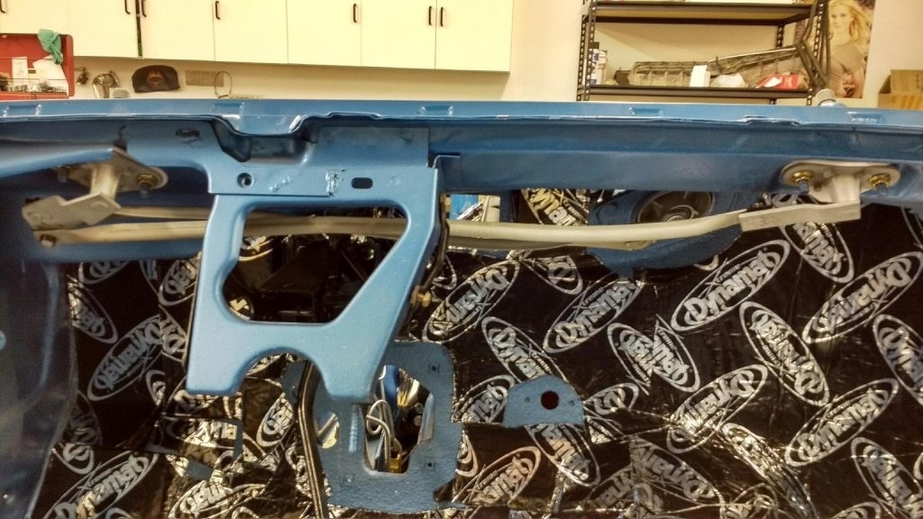

Got the new clips on the wiper linkage

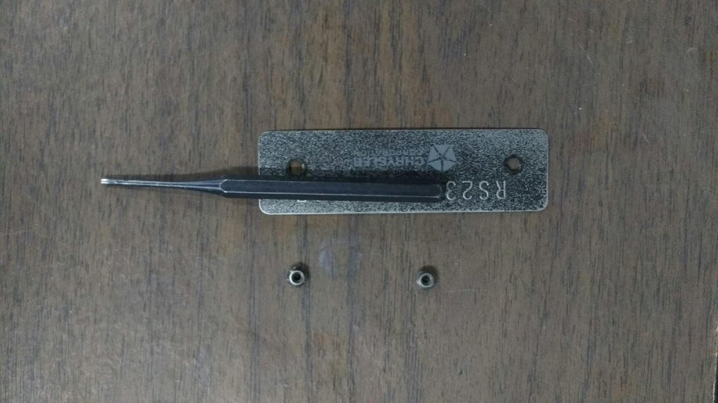

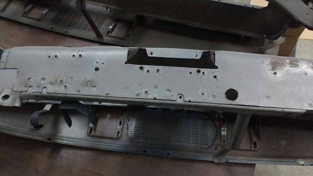

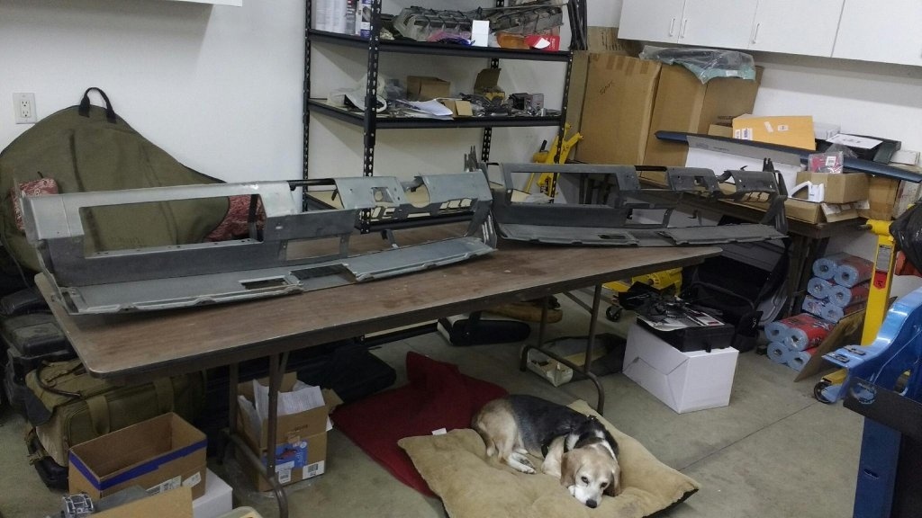

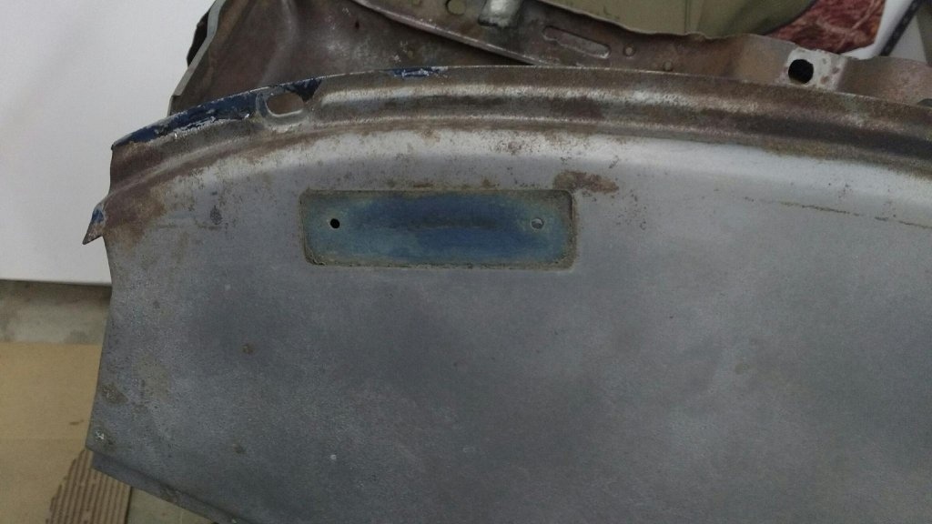

So I dug the dashes out that I have. I bought a AC dash so I could use it for measurements to cut the AC vents into my dash. Note that my dog is watching me closely. I removed the vin tag rivites from the back side. I'll save them and glue them back in. I'll be damned if I'm going to pay stupid money for 2 rivets. I may see if I can file some down to replicate the flower shape of the OEM's. I was hoping the color under the tag would have been better so I could get an idea of the dash color.

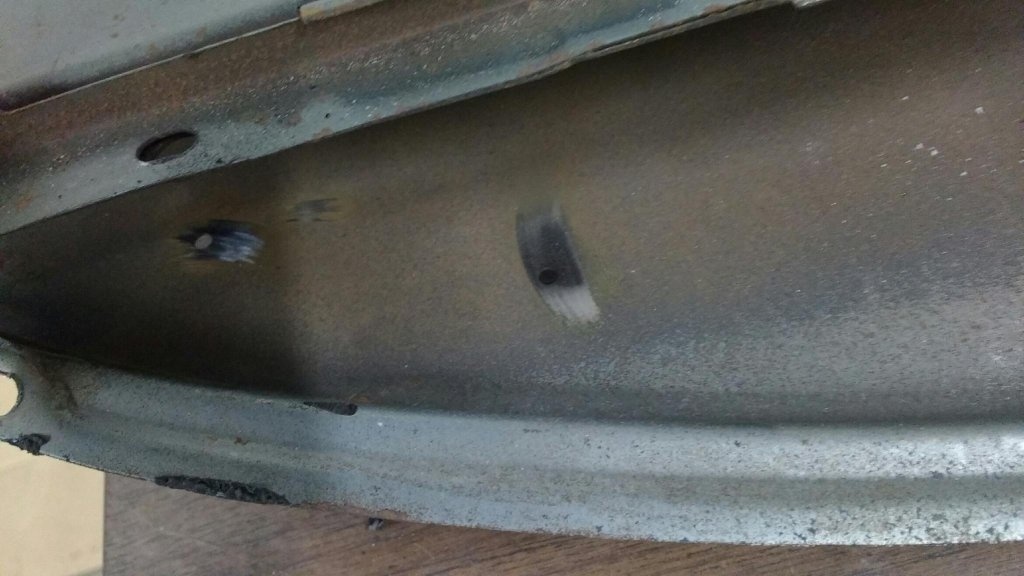

Note all the circled holes I need to weld shut from over the years of gauges and other stuff added to the bottom of the dash.
If you need to keep everything original you can buy dash rivits. Because my car is not totally original it isn't worth $29.00 to buy 2 rivits. I am going to use regular pop rivits that run about .02 cents each. May be I can carefully grind the star shape in it like you mentioned.

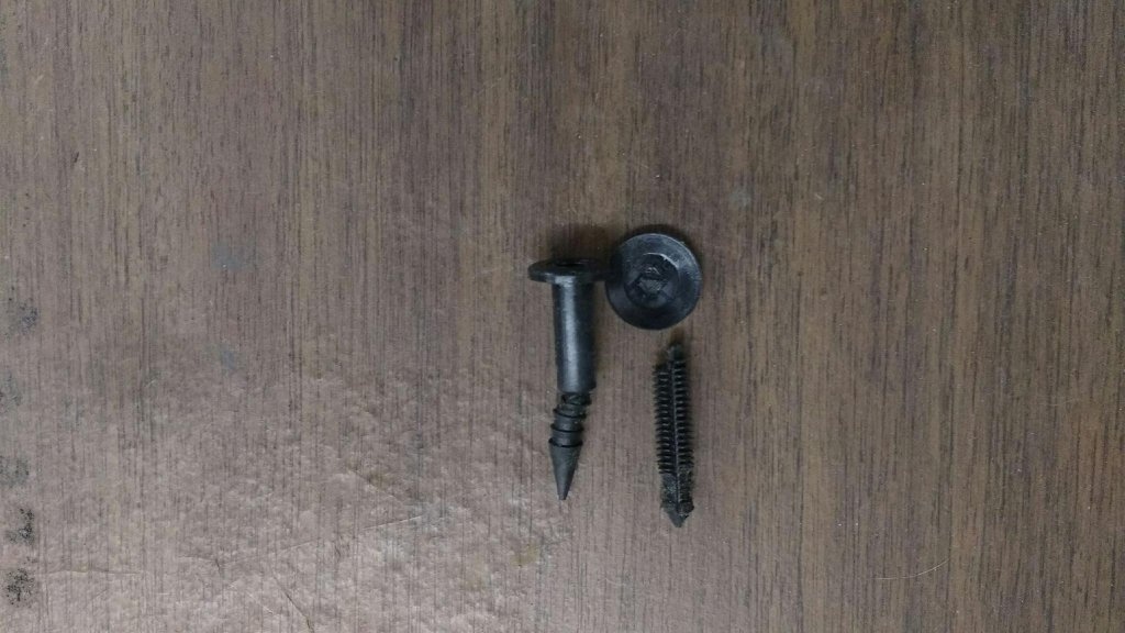

When installing my under dash insulation I had a tough time getting the plastic push rivets in the holes, maybe from lizzardskin & paint. so I ended up grinding down the first diameter to slide through then the ribs slid right through. Notice the REM fastener on the left was soft and bent like a nail. The other fastener I had was harder & brittle and the head broke off when pushing in.

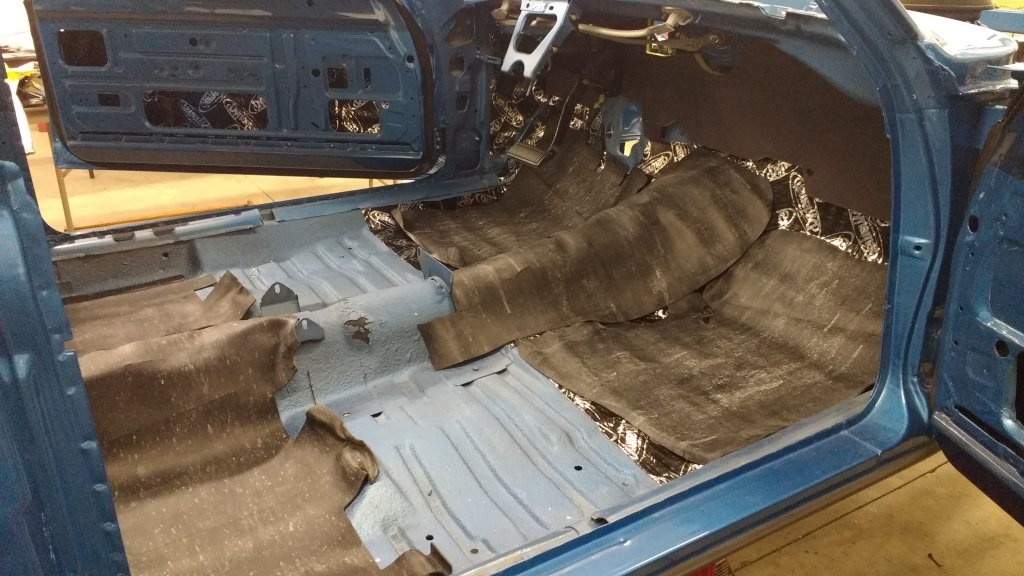

I bought a roller to roll the mat yesterday so I'll be doing that tonight. Between the 3 layers of Lizzard Skin and Dyno mat it should be pretty quite & insulated. I'll install the factory insulation over the top of this. The Hot Rod Power tour is coming through my state in June so I gotta get after it if I'm going to make that!

So as if I didn't have enough sound deadener, I have some rubber deadener from REM I put down also. I think I'll go ahead and buy some more dyne mat or something for under the seats.
