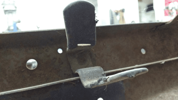

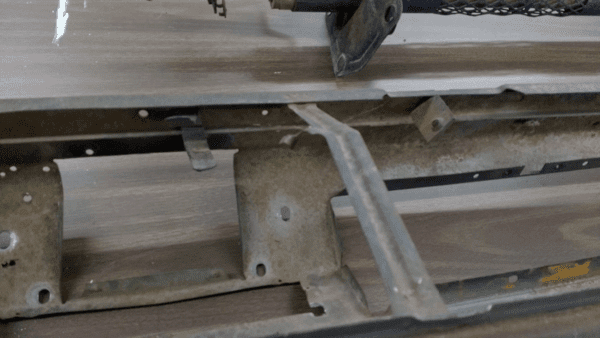

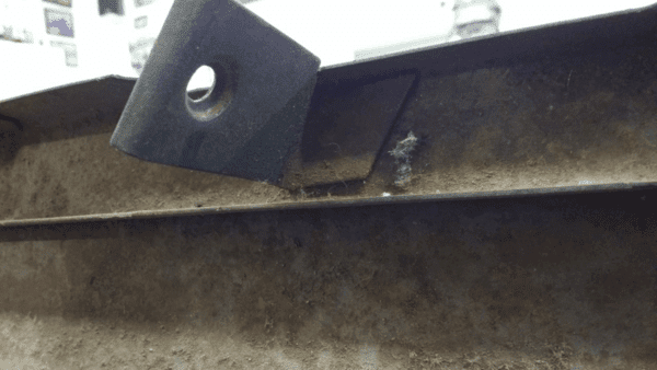

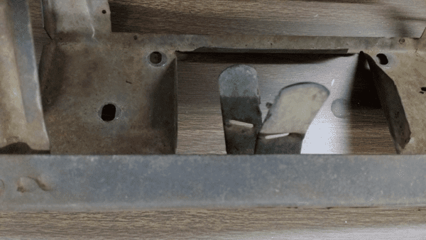

Here's the bracket on the other dash.
You can see the harness clip and on the other side of the vertical brace is a bracket, anyone have a idea what it goes to? I'll probably make one rather than cut this one up. That way if anyone wants a dash I got one.
Bracket on the right side in your pic is where the fuse block attaches.

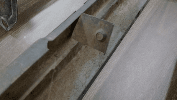

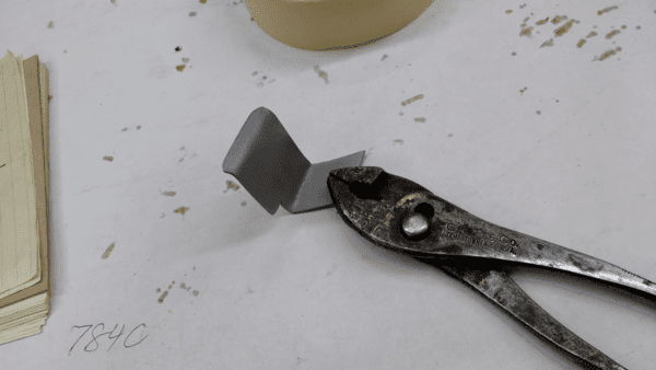

So I made the fuse block bracket last night. There's some pictures from the reference dash and the new bracket I made. I need to measure the divot & hole location and size, put them in and it'll be ready for install. Next will be the loom fold over bracket that was hacked.
Darn it I just noticed I put the notch on the wrong side. :BangHead: Well shouldn't take me long to make another. Maybe it'll work anyway, I'll have to test fit it.

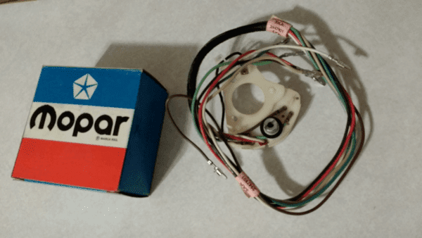

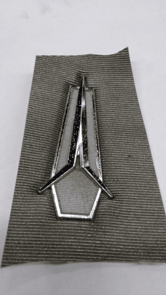

A member here was a huge help, he sold me this for my car. I'm saving the box for garage art!

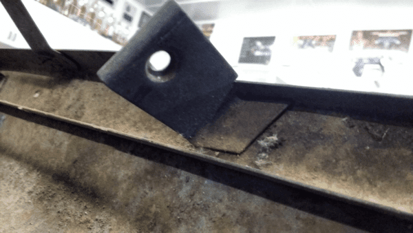

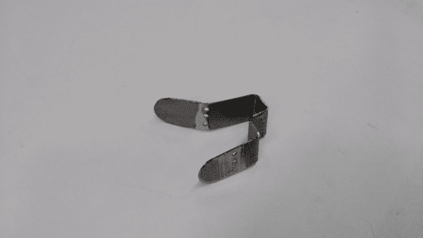

So I made the new loom bracket for my dash using the bracket on the dash for a pattern. I drill three small holes to replicate the slots on the other one. I believe they are to help the bracket bend where it's supposed to. I'll plastic dip it before attaching it to the dash frame.
Holy crap, I'm eye candy for the day!!! Thank you darlin!
I hope my PM back to you about your emblem makes your day (it probably won't -- sorry, I just call 'em as I see 'em) but you should know you definitely made MINE. Thank you muahhhhhhhhhhhhh
