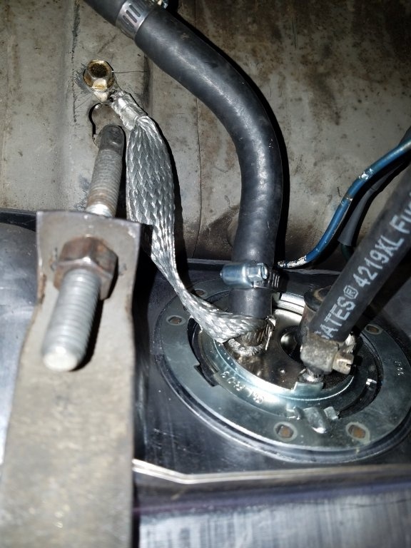

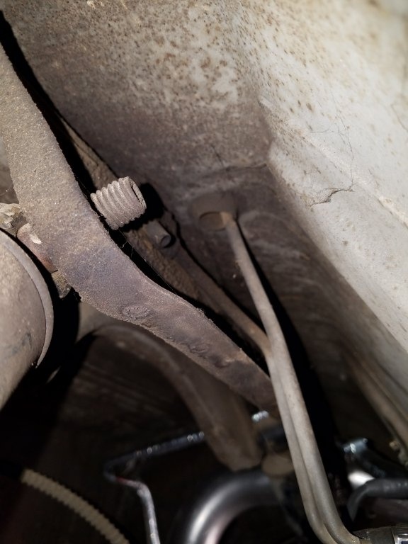

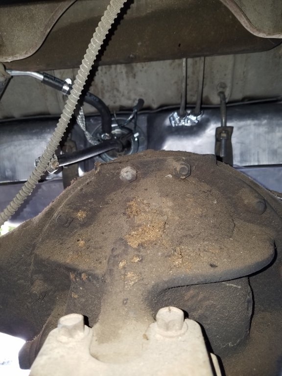

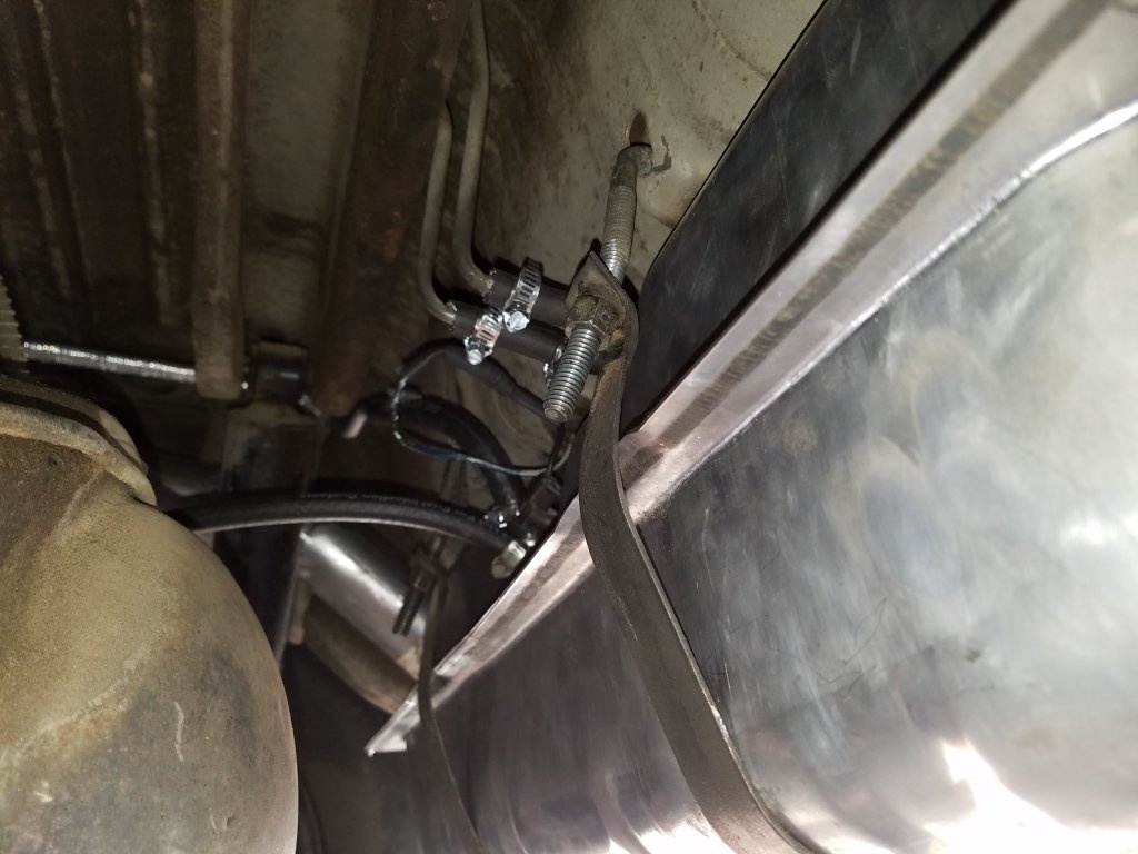

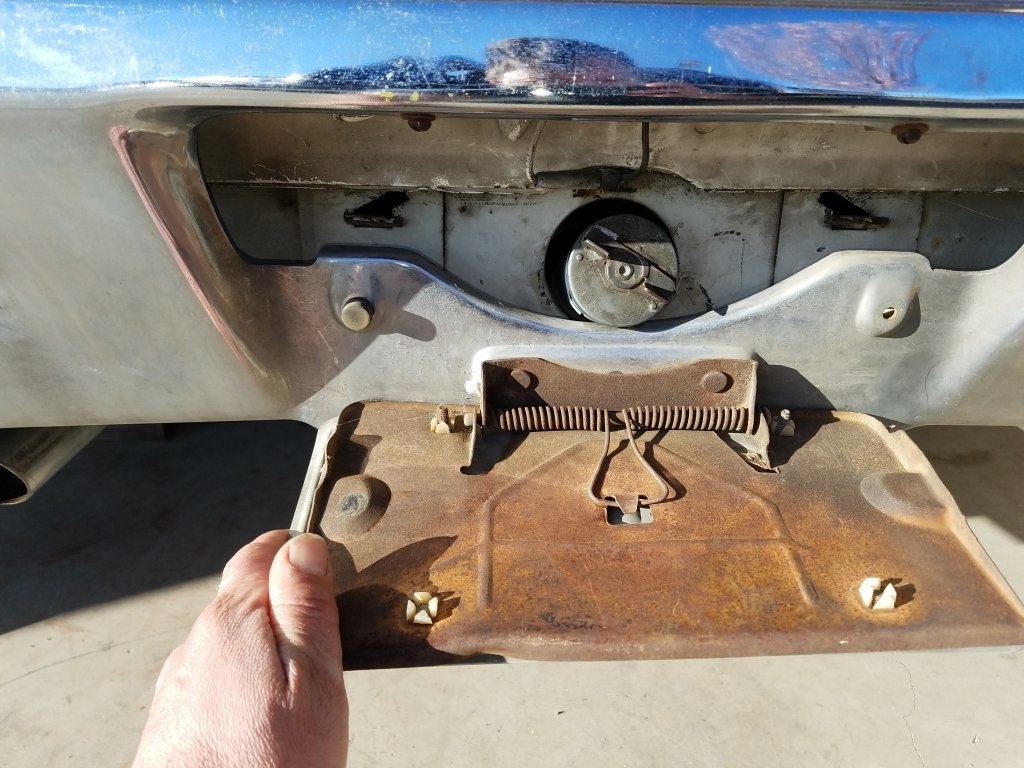

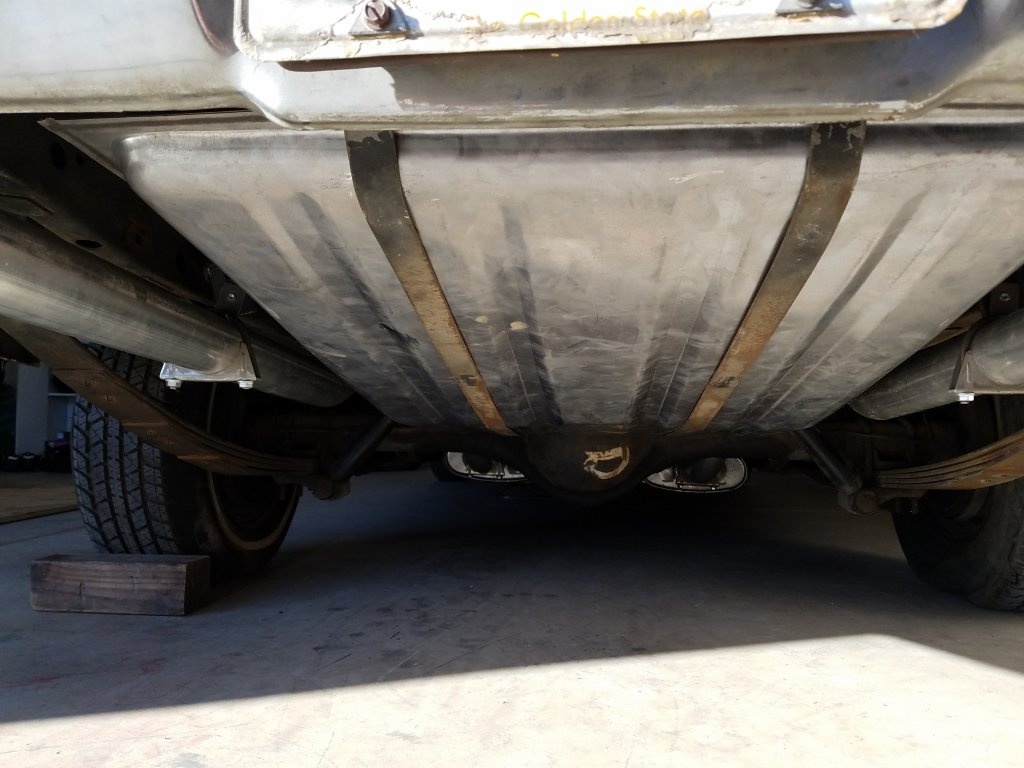

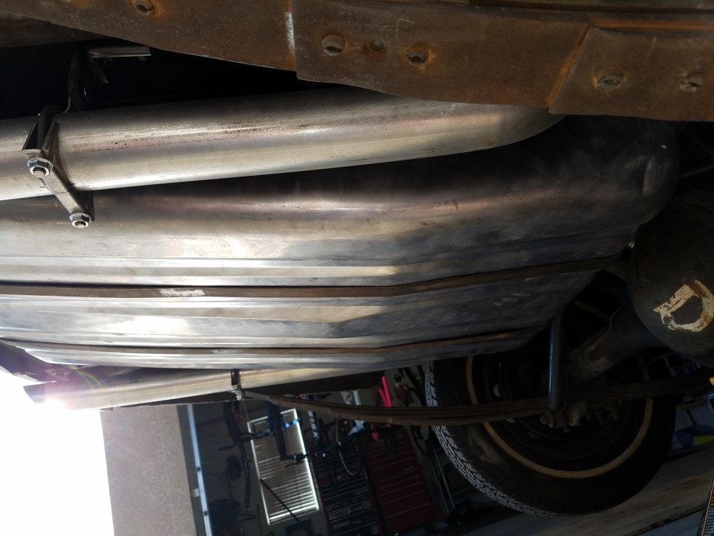

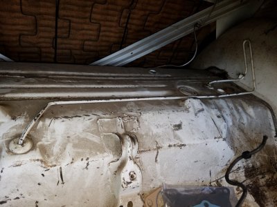

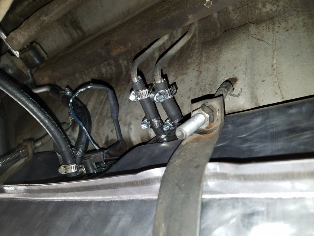

Well mine is a 68 but they are basically the same just make sure to get the parts specific to your year..mine is installed but hopefully this helps. Factory service manual is your friend here as far as getting everything in correctly...some notes: my fuel gauge grounding strap is obviously not stock(that's the braided thing you see), the return line is plugged for now(that's the rubber line that's just hanging there) and the next-to-last pic is how the vent line is routed through my trunk..there are two vent lines on my year, the other one just connects to the frame directly above and stops, you can see that in the last pic

Beanhead are the J bolts located at the rear by the bumper ?
Uwss- no ,by the diff&sending unit.
Yes oldbee's right, they're in front, the rear of the straps hook through the body above the gas filler
69 differs from 70 for number of vent nipples. California vs 49 states. Get the right tank. Pay close attention to sending unit and vent routing to prevent the heartache reported here on many other threads.
