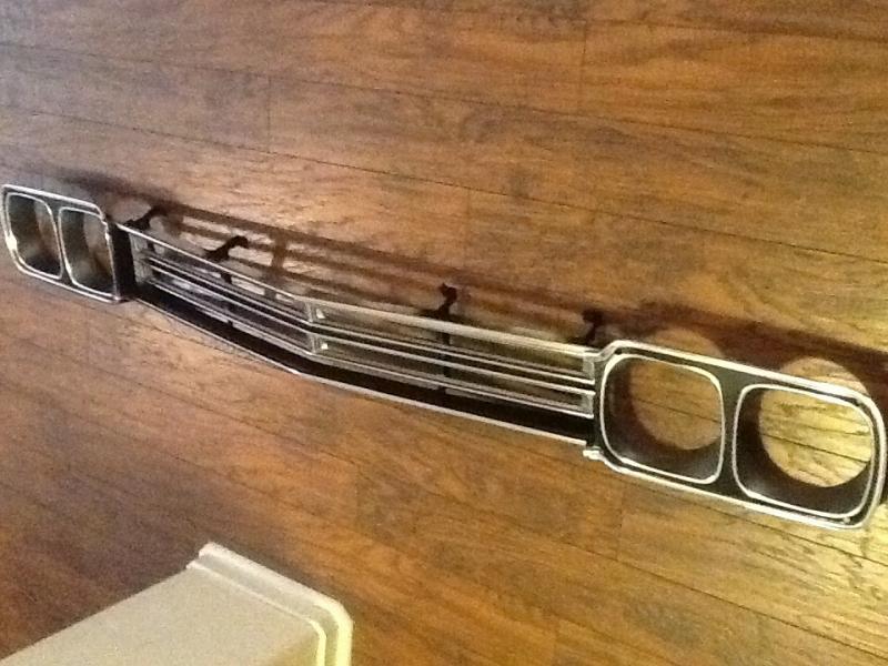

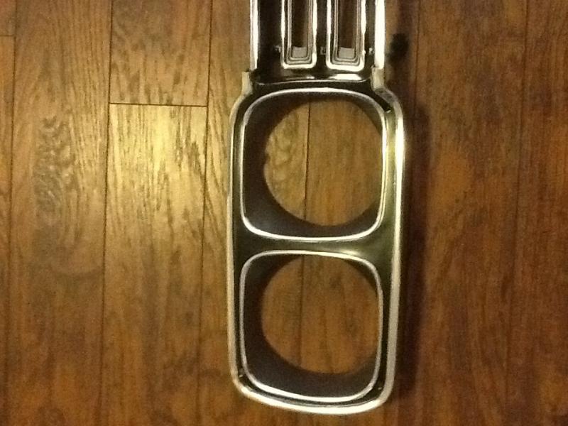

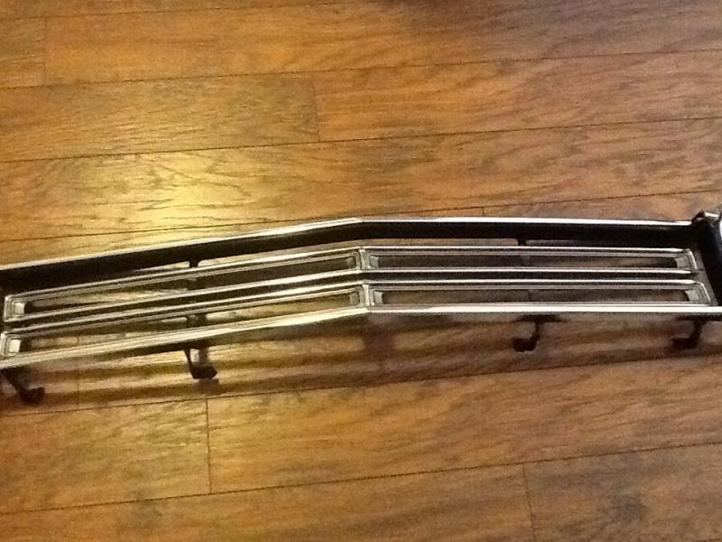

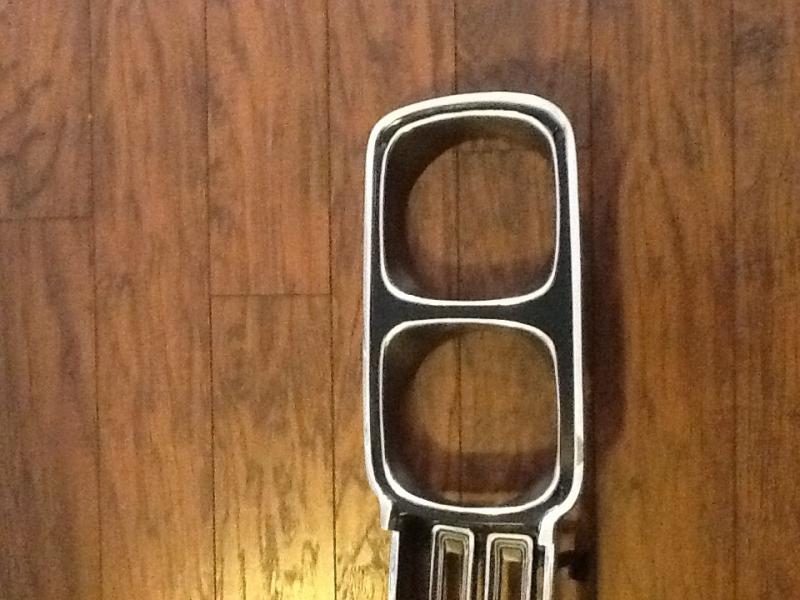

Here is a grille that I just finished for MoparBill. It turned out fantastic and was the first roadrunner grille that I have done. One word of caution, the textured dark argent paint is really pricy....got it from totally auto, but it is perfect unlike some of the paints that are available.

What did you do to the aluminum surface that is not painted?
Polished the **** out of it, lol!! Honestly, all the bare aluminum is polished, then they are masked off, the black is painted and then the textured dark argent is painted. If ya do it right, it comes out really nice with minimal clean up.

Is the Totaly Auto paint close enough that I could not do my grill? My grill is good but the argent was removed from the headlight bezels.yours looks great!
From what I understand, Totally Auto is the only place that makes the correct textured dark argent paint. It is pricey, 24 bucks a can!!!

I should have said that I did both the grille and headlight bezels, so the paint used on both is the same.
so is one can enough, or did it take more to do all?

1 can did everything, and there was leftover.
The grill looks FANTASTIC! I can't wait to put it in the car! I know they make repops, but nothing fits like OEM. 5.7HEMI did a great job, was super nice to deal with, and got the grill done very quickly. I would highlt recommend his services to anyone. Wouldn't you rather give your money to a MoPar guy to get your OEM grill restored that give it to a stranger for a chinese grill??
@Basketcase- the dark argent is damn close to original-I compared it to a spare grill and I can't tell the difference
