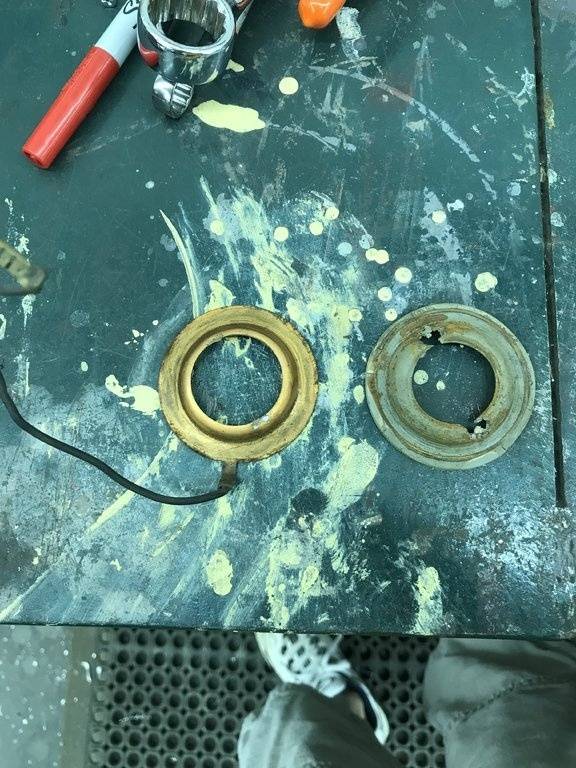

I have same problem.does anyone have a picture of gasket that goes under flat copper ting with wire attached.thanks
I'm out of town for a few days if no one posts up
a pic I have one apart and will get you a pic on the weekend
I bought a sheet of thin gasket material at NAPA and cut it to fit. Not a problem since.
do you have any pictures of what you did. does it go under the flat copper ring.thanks
Sorry but I don't have pictures. IIRC the gasket material goes between the copper ring and the hub. The trip ring wire must be removed and the gasket has to be cut in a circular fashion with a hole in the middle to slid over the hub. I used the copper ring as a template for the gasket.

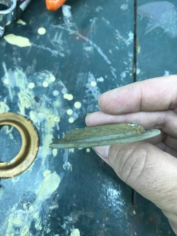

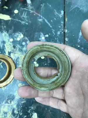

Here's the pics you requested
