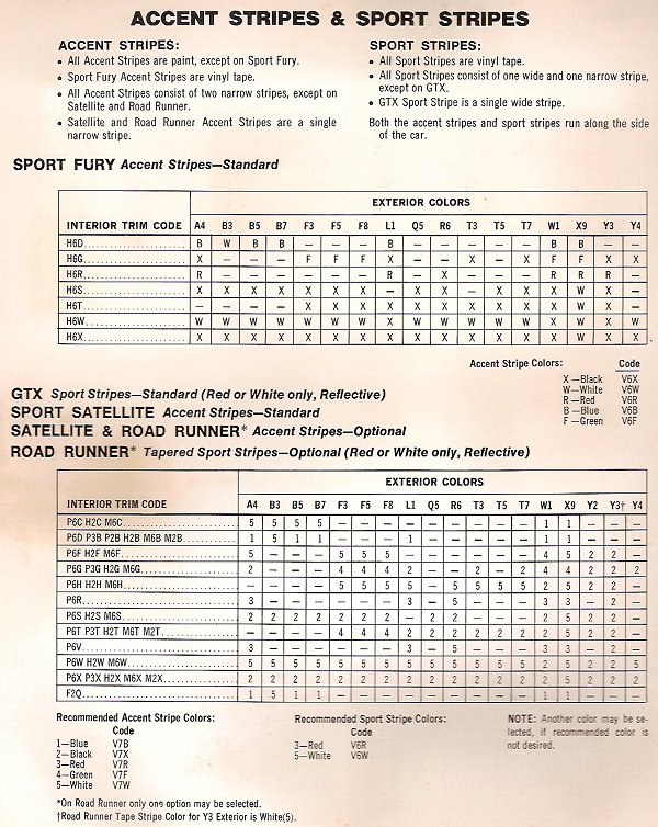

Interesting. I bought a NOS white dual stripe that at the time thought i would put on my car but don't think i am, anyways the guy i bought it from called me up the next day saying he was sorry he found out the stripe wasn't on the 69's??? But they are? Hmmm
Sorry i should of note i'm cloning it. Maybe he didn't realise that... Anyways thanks the charts cool
Interesting about the V8* stripe on a 69 RR. Do you have a source for that info?
THANKS FOR POSTING THE CHART!!:)
The v8* was usually the bumble bee stripe on Coronets or stripe deletes V88 V68. The V means Paint or vinyl , the numbers 1 thru 8 indicate the position on the vehicle. example V1X = Vinyl, Roof(top), Black.
This chart must be early 69 as it does not show the midyear exterior body colors like R4, The R6 is a darker almost Blood Red. Over the years I have had many people call my R4 Spring Red RR "Orange" until you set it next to a Hemi Orange or Vitamin C car then it is as red as can be :)
I always hoped to see a W1 White 69 Road Runner with V6R Red Reflective Sport Stripes. The reflective stripes were AWESOME and can be seen blocks away at night when headlights hit them!
The only time I have seen Black Reflective tape stripes were on 70 & newer Road Runners. As the Chart shows on 69 RR only white or red were factory as far as reflective goes.

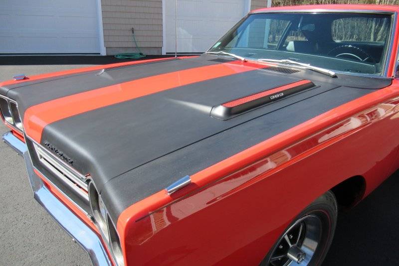

yes my car originally has a gloss black painted top , I will someday put it back that way , back in 84 when I bought it I was young and dumb ? I had no idea about fender tags and rare options , it had top trim and a black top and the rest of the body was primer . So i figured it needed a vinyl top , stupid me.
anyone have a picture of what this painted on stripe should look like ?
Thanks for the picture! BEAUTIFUL Rare Bird! Broadcast sheet? The way it was optioned almost makes me think it was a customer special ordered car?

I have been told he ordered it to race straight line
manual brakes , manual steering , bench seat , column shift , 383
but got hood stripes , painted roof and pin strip , air grabber , so he wanted it to look good on a budget . No broad cast sheet long gone when i got it ?

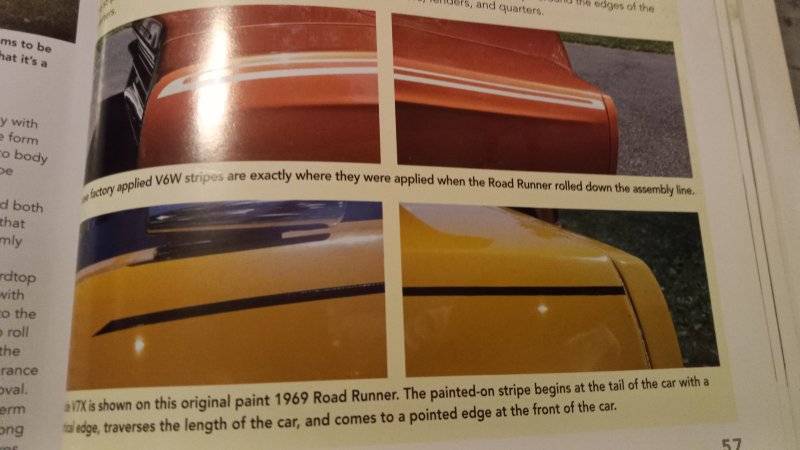

Finally found the factory picture with the painted on pinstripe.
This is a harder to find option.I believe the fender tag code is V6X for a black stripe and V6W for a white stripe.I have seen the stripe in red and green over the years also.
7X for Black pinstripe
7W for white, 7R etc..
V6# is the reflective tape dual stripe, red or white only. V7# is a single painted-on stripe, painted on with rollers at the factory (beugler tool?)
It looks just like the 68 above, follows the fender/door line, at about where the bottom spear of the dual tape stripe would be. Could be black, red, white, blue, or green.
7X or 7W
