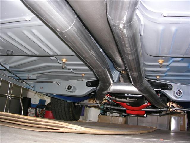

I went with DP40 Epoxy primer on the bottom which is close to the gray I found on the car and its pretty durable and cleans pretty well also. I think the primer colors varied because the factory would add to the tank what ever showed up, mostly gray, oh look we got some black today.

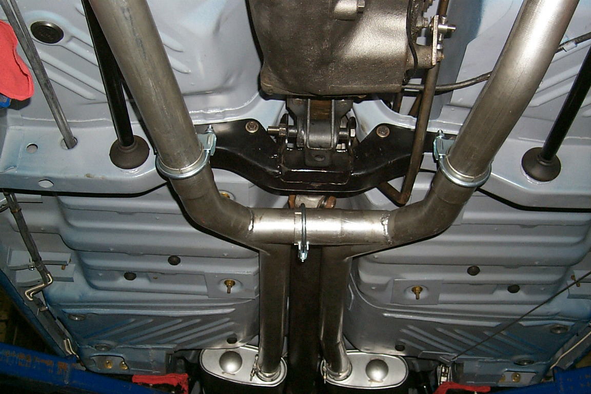

I have seen a lot of LA cars with dark charcoal colored dip. My 66 Hemi car is a St. Louis car and it has a darker than usual dip on it that I was able to duplicate with a cast iron type mock colored paint that was a match. Below is the under side of it.
As noted below also I have seen varying colors of dip in other plants as well. I don't think anyone can "call" you on an exact color on any particular car from any plant. Just reproduce what you can see as factory left over on your car regarding color.

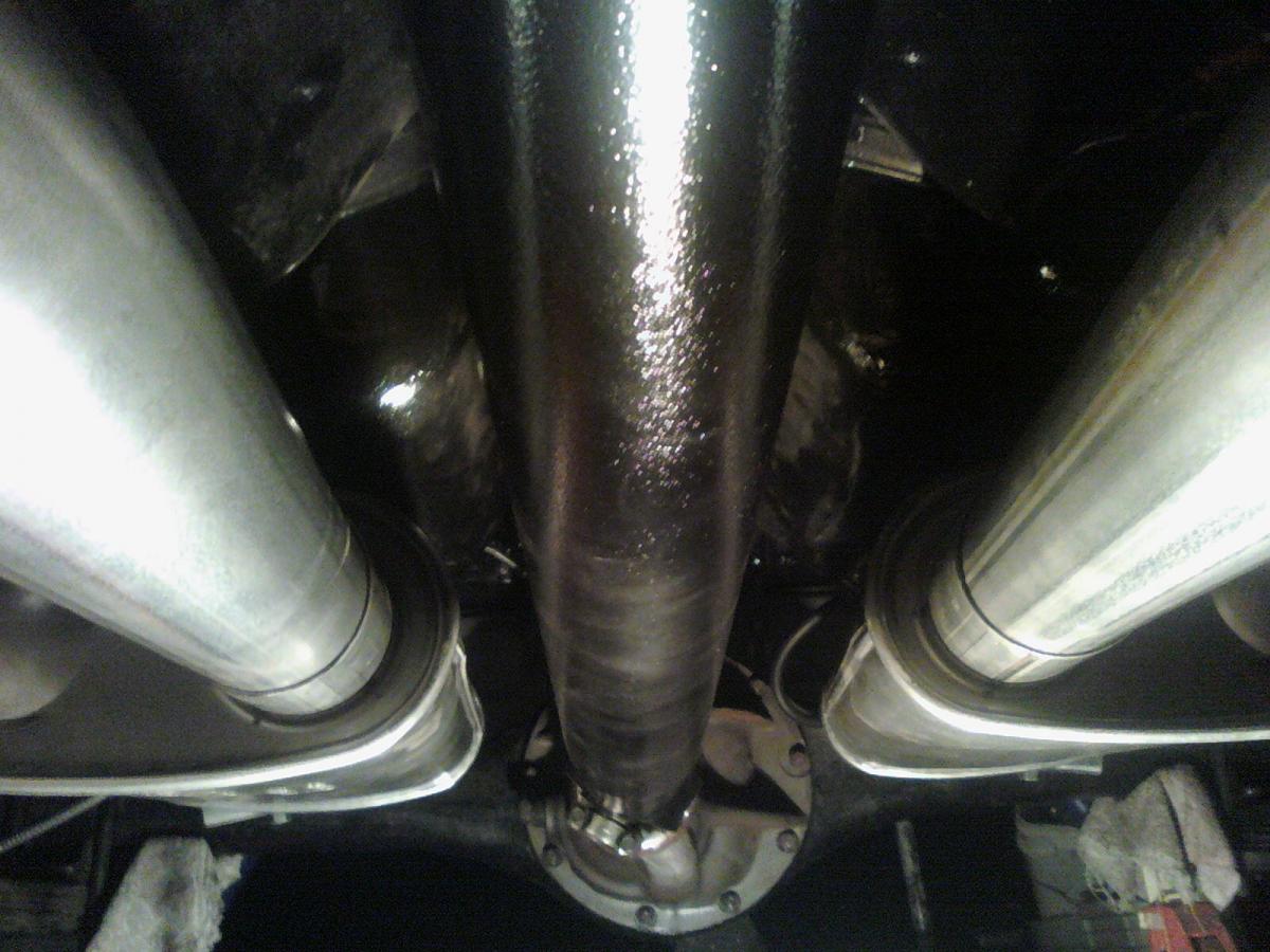

painting it black doesn't look bad i just plan on some truck bed liner or undercoating when finished
