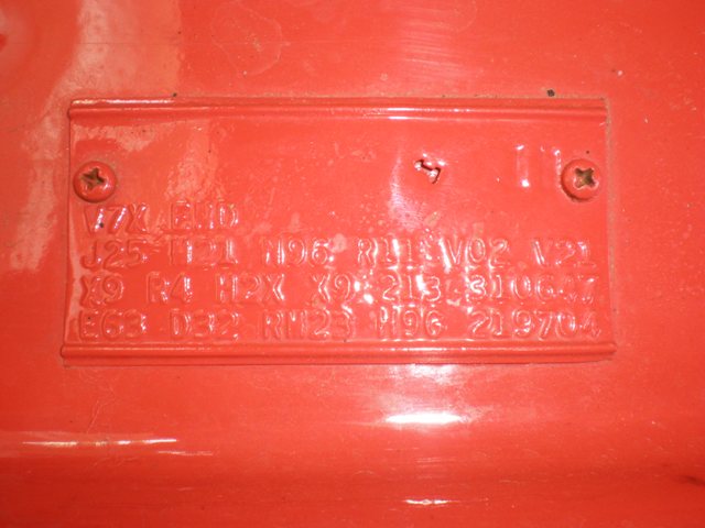

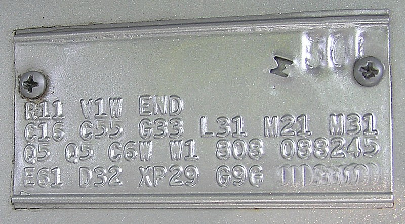

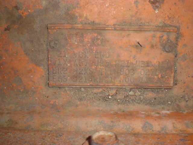

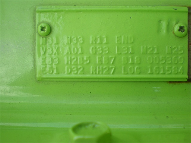

what is the difference on a 68 fender tag?
moparstuart thanks for the info. My next question is on the 68 since they didn't use vin numbers on stampings, if you don't have a fender tag, how else could you i.d it
On 68s the VIN is still on the core support and trunk gutter-the fender tag has the sales order # instead of the VIN. If a 68 doesn't have a tag or buildsheet, it's difficult to verify exactly how it was built, but you can verify that it's a RoadRunner.
It's a little more tricky as VIN swaps are much easier on 68 and before. You could turn an RH21 into an RM21 pretty easy just by pulling the VIN plate from a salvage car and adding RR trim. The VIN tag plant code would have to match the plant code on body stampings.
Bill,
VIN numbers did not appear on the body until '69. You may find the VIN on drivetrain components on a 68 model year car but you won;t find them on the body. 68's still have the year, plant code and body line plus the VON on the radiator and trunk rail.
