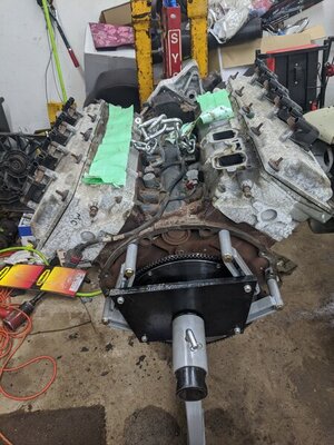

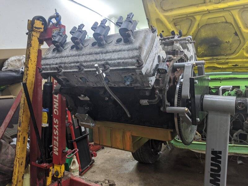

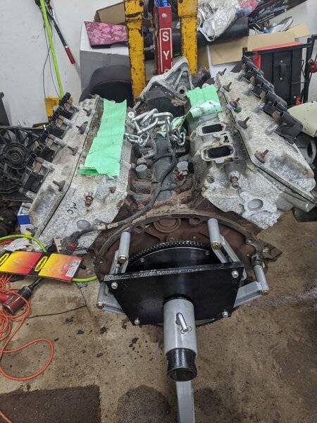

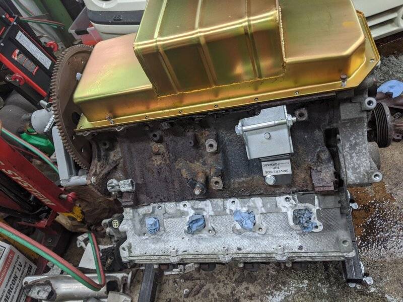

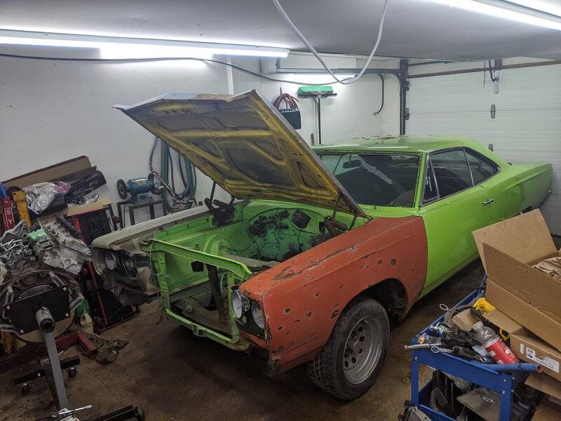

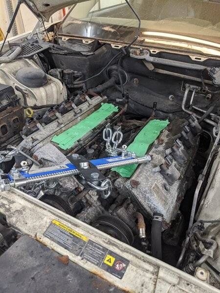

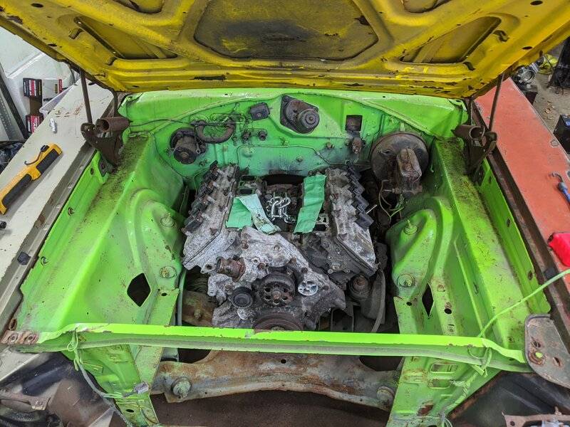

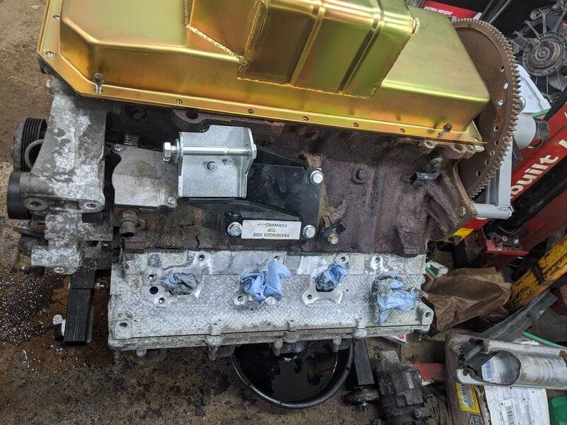

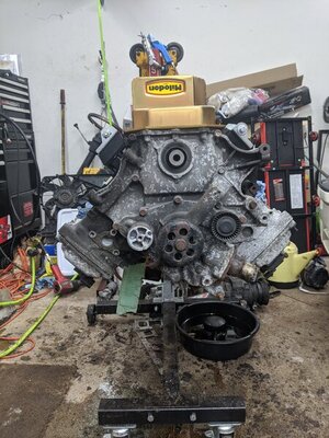

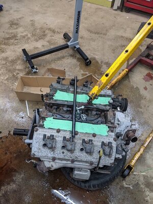

Been a long time coming to get this project off the ground but I've finally made some big waves so it's time to post some progress! SST kit showed up around a month ago and I've been collecting parts since I bought the car in 2017? 2018? Anyone else lost all sense of time? Anyway! After years of staring at two cars thinking how to make them in to one a few weeks back I finally dove right in and here's what I have to show for it.

Donor car is a 2005 300c and it's not giving away much beyond the engine and the seats. I'll be using an ms3gold to control the engine and planning to get PST disc brakes all around. The dream is to drive the car out of the garage in April once the snow melts up here :D

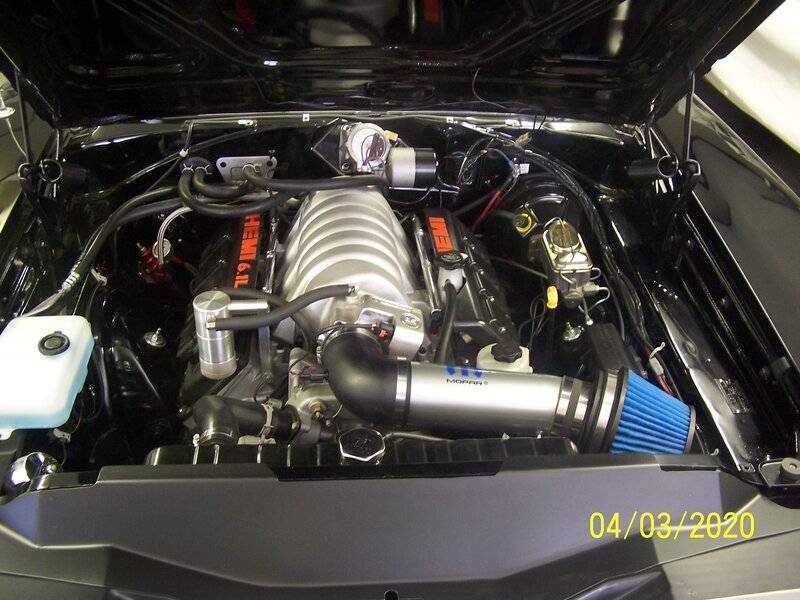

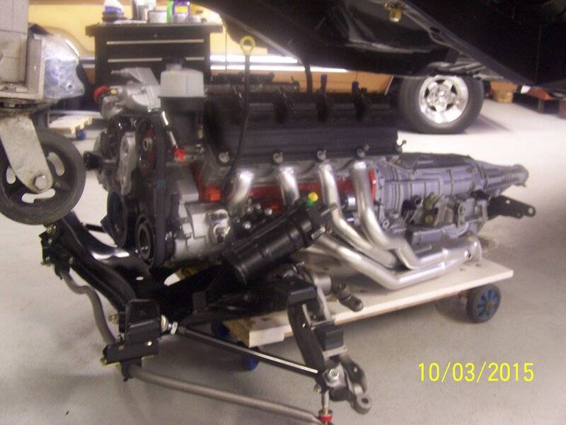

It looks like you have a good start. One thing I noticed is it appears you are staying with the factory air box. If so, there is no room for the fly by wire gas pedal to fit between the heater box and steering column. For me, the only way to make it work was to use the stock cable operated pedal and use a bell crank assembly from a 03 era Ram that used the fly by wire assembly under the hood. Bouchillon Performance can help you with a kit to make it a little more less trial and error. Hopefully they are doing a better job now than what they did for me since they have had more time to practice. I'm not up to speed on the MS3Gold system but it is more than likely less headache than my experience with using the truck computer. Does the MS3 use the fly by wire system? Also, you may want to upgrade the steering gear to a Borgeson to help with more room for the header on the left side. Plus the newer style PS pumps have been known to blow seals on the older power steering gears. I also see you have a 2 speed wiper motor. Not sure if it will be a problem with the intake or not. Everyone has their own way of installing these things but I recommend you remove the K frame and install the complete engine and trans from underneath. Much easier than trying to drop the unit in from the top. If I can be of help, don't hesitate to ask. Good luck and have fun. Here is a pic of the 6.1 in my 68 Charger.
That car of yours is just beautiful.
You've got sharp eyes! The ms3gold doesn't and provisions for electronic throttle so I've picked up a BBK mechanical throttle body and bouchillon mechanical throttle cable. At the moment the plan is to be gentle with the stock k frame and once I've got the car working for a while I'll start saving for a gerst front end conversion. Currently the engine is sitting on TTI 57MMBE mounts and I've got a set of 61HC headers to go with it.

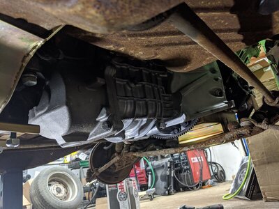

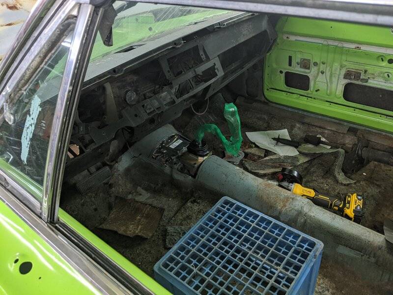

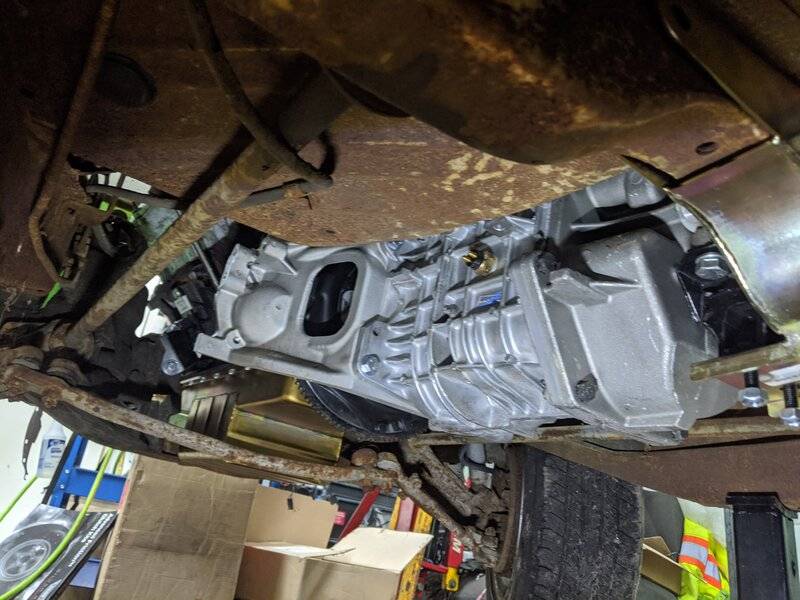

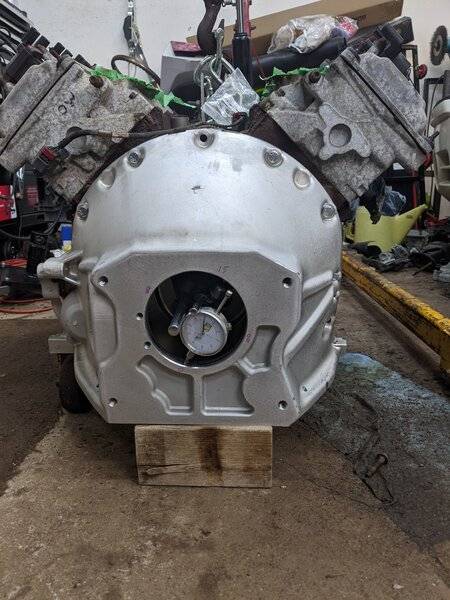

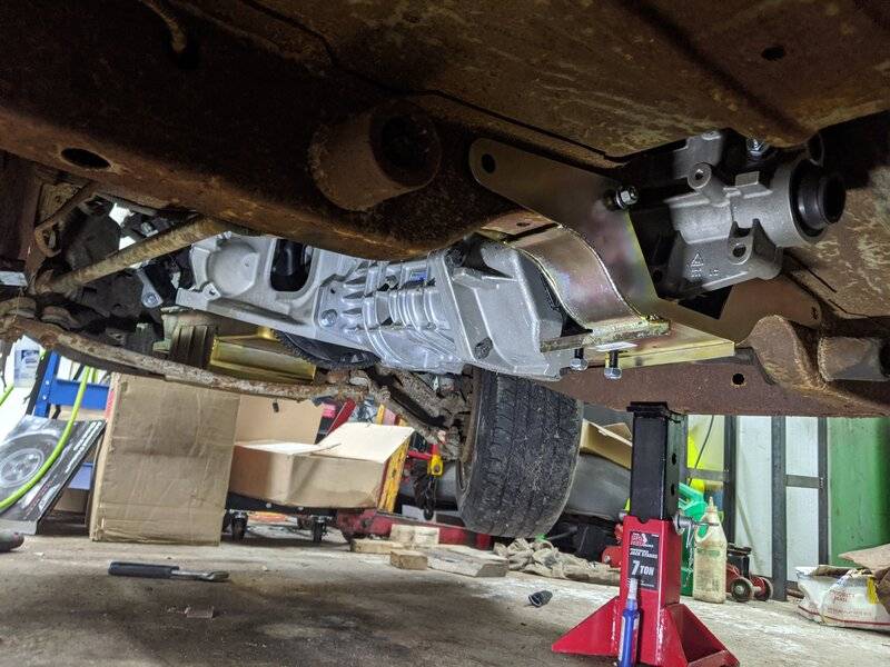

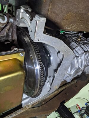

Been a few weeks since I've had time to get some work done on the car and with the cold weather moving in I'm starting to feel a little down as the days get shorter but I got some big progress done! Transmission is in, though it's going to have to come back out again. I'm in need of one more shim for the clutch slave, but figured if I'll be calling SST anyway I may as well get my driveshaft measurements written down so I can kill two birds with one phone call (stone?). Just for giggles I bolted the shifter on and sat on my trusty milk crate seat and boy I can't wait for this thing to be rolling down the road!
IMG_20201023_214552.jpg IMG_20201023_214619.jpg IMG_20201023_214816.jpg IMG_20201023_214821.jpg IMG_20201023_214831.jpg
im already jealous that you were able to do the bell housing alignment outside of the car
