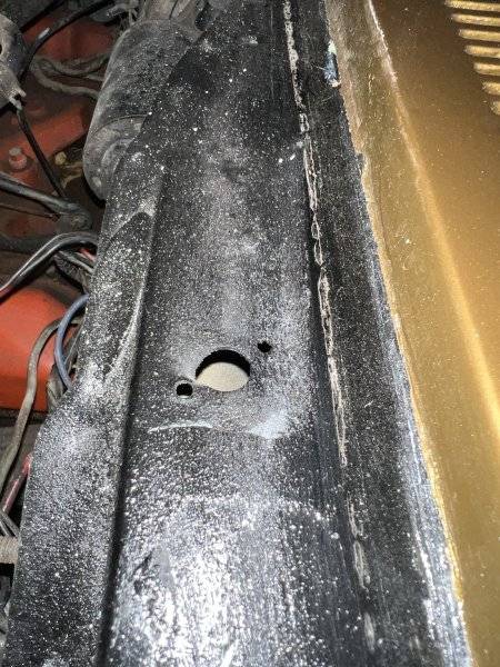

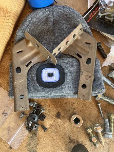

As I am piecing my 69 be back together from a collection of small parts, what are these two brackets? And where do they attach? Also, the space between the Cowell and the engine bay. Looks like something should go there. Does anything fill this space? The long strip in the picture below. It looks like there are two positions to mount something with a large hole and two small screw holes on either side of whatever that might be.

Looks like those brackets were welded in and the spot welds drilled out.
Those brackets go in the corner of the quarter window between the quarter panel and roof rail. They weld in to give that area some added support

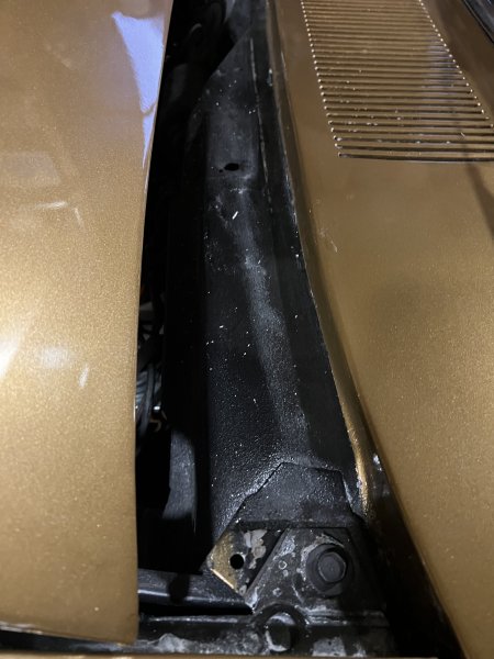

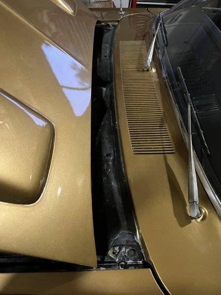

On the squirters, when I close the hood, it covers that area.. completely. What am I missing?
Also, is there any piece or sheet metal that bolts in to the holes on either side of that long black strip between the cowl and hood?

The squirters bolt into the holes at the top of the cowl but they shoot through the fresh air vents in the cowl. There is a rubber strip that clips to the underside of the hood that seals the hood to the top area of the cowl

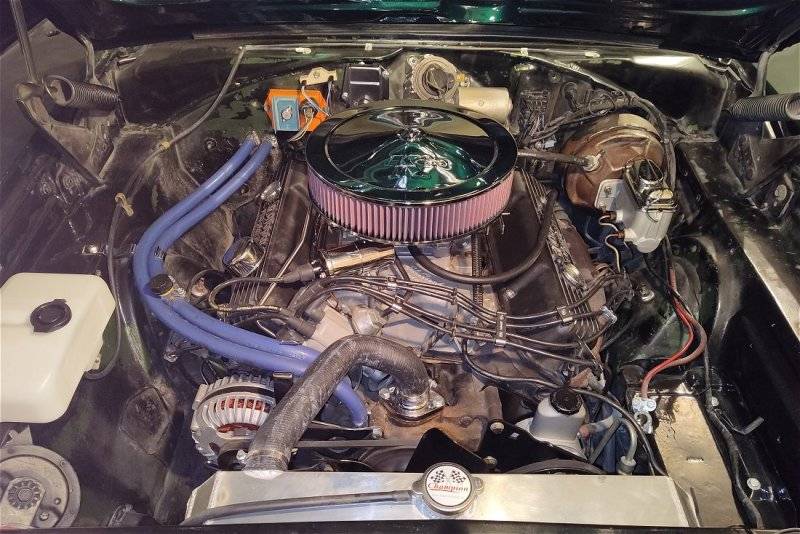

Dude, no doubt. I pulled the trigger on this car because the body, frame, undercarriage, and engine bay were all restored, numbers matching 383 N96 car with 62k. The PO and his crew got started on putting things back together but there's still a LOT to do. It's drivable but still, lots of wiring, weatherstripping, etc. panel adjusting, all splash sheilds, etc. On the plus side, it's pretty quick, has a lot of torque and - in looking at your pic above - it reminded me that I learned I have magnetic pickup ignition that goes back to a box that looks very much like yours on the firewall. The dizzy cam is not a standard points cam, rather sharp, thin, flat ribs that are the pickups. Today, I went to check the points and found out I had none. The guy I bought it from was a good dude but didn't know much about cars so he had buddies and speed shops do work for him. Anyway, sorry for the unnecessary info and thanks for the info and pics.
