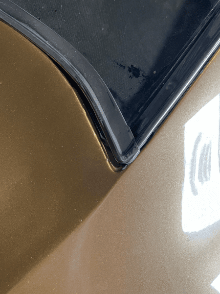

Hey all,
In working though all the kinks on our Bee, I'm noticing that there are places where it looks like water can pool, not drain, and possibly lead to rust, etc. down the road. I know that many of us don't drive our cars in inclement weather for various reasons but for those who do, and/or would like to, how does one keep water from pooling, if possible at all, in places like this and along the whole rear lower chrome trim? Sealant? How did the factory mitigate against things like this? Drain holes? Just let the water pool and count on (hopefully) good paint and sealers and evaporation to keep the water from pooling? Old car guy, Mopar newbie here.

A good glass guy will carefully fill the cavity with the black butyl under the stainless so that the water runs out good and doesn't pool
Interesting, thanks. Will they typically fill the entire length of the rear window at the bottom? or mainly the corners?
Thanks,
Mikey

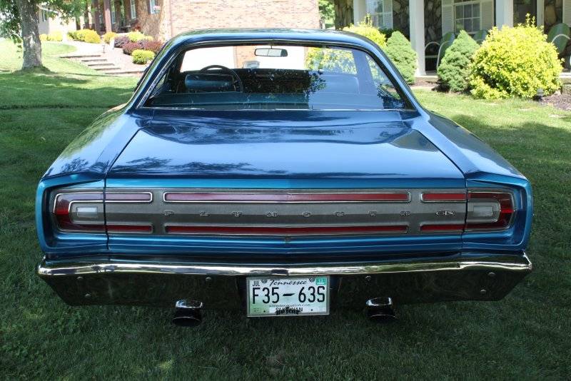

Back in the day, the guy who sold me my second GTX used the butyl under the stainless, and also blew the corners out with a hair dryer. Never had rot, and still had a perfect original trunk floor. Original corners were still rust free when this picture was taken in 2013, with 113,000 miles on the car, 28 year old paint job.
