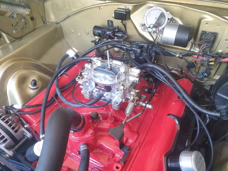

Hi All,
I have a new to me 69 Super Bee, 383 with a 727. The one to two shift is fine, but it seems I have to let off the gas for it to shift into third. I’ve read similar posts about adjusting the kickdown linkage, but I have no idea if this is correct. It came with the car so I was hoping you guys could tell me if this mess of linkage is even accurate. I was thinking of just getting the Lokar lockdown cable set up or something similar to simplify. Any advice you guys could give would be greatly appreciated. Thanks
Mikey.
It looks okay, but get a better return spring, 2 actually, an inner and and outer.
Does it kickdown properly when you mash the throttle?
You want the lever to start to move as soon as the throttle begins to open, and not to impede the throttle opening fully either, but there is fine tuning around this.
- By hand, open the throttle all the way and make sure the kick down isn't stopping it.
- Holding it at full throttle make sure you can't push the kickdown arm further down.
Generally there's that much slack in each part of the linkage that you can hit full kickdown before you hit full throttle, and the linkage will still allow you to get full throttle.
If the front slot is adjusted correctly and the shift to 3rd is delayed, then pop the ball off the vertical part of the linkage (against the firewall) and screw that a few turns out. Write down what adjustments you are making so you don't lose track.
The factory linkage can be made to work well, but takes a bit of trial and error sometimes.
PS your fuel filter looks to be on backwards. Check the arrow on it.
You have a universal aftermarket holley, which is fine/good.

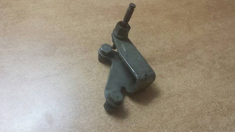

You need the mopar linkage attachment that bolts to the holley bellcrank to get the ratio correct. And to align the linkage centerline.
Thanks all. This car is new to me so still learning it. The FF is getting replaced tomorrow. along with a bunch of other checks.
Thanks again,
Mikey.

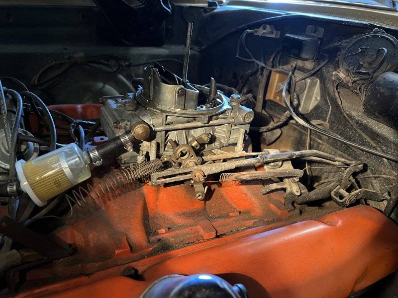

66 SAT has the same arm as I do. For sure you need that. You can either adjust the slotted unit that hooks to the stud on that arm or the rod on the bell crank that goes down to the trans. I chose to adjust the one heading to the trans. Easy to do. I would drive, pull over to make an adjustment, take off and repeat until I liked it.
Awesome, thanks. I just ordered it. I'll search for some posts on the setup but might have to reach out to you all for some guidance.
Thanks,
Mikey

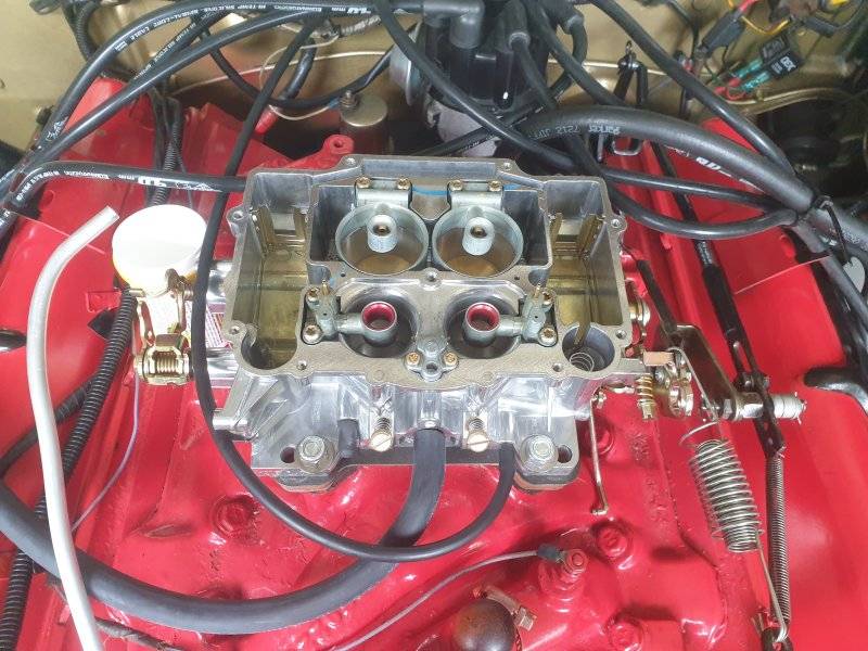

BTW. DON'T buy the Holley version of that linkage stud. The throttle cable side is too big to fit the cable.
Here's a couple of photos that show how it attaches. You can see the spacers I had to use on the stud to get the alignment of the kickdown arm correct.

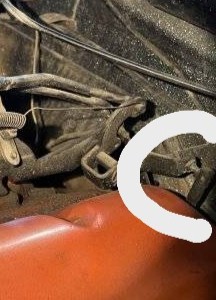

Mikey, if your one to two shifts are ok and the shift to third is hanging up, and you have to take your foot off the gas pedal to make it shift into third. You need to shorten the firewall rod linkage. The one in the picture that I highlighted, pull it off the ball and turn it a couple of turns (clockwise) to shorten the rod length. Take it for a drive and see if that helps the shift into third. Your linkage set up the way you have it in your picture should work. Tell us if that worked for you.

Moes, I removed that linkage rod as you suggested but it seems to be doing the same thing, not much change. I went 4 total turns which looked like about 1/8". Should I go more?
Thanks,
Mike
Keep going. It took a few stops for me to get it where I wanted it. Drive it, see how it shifts, pull over and adjust, do it again till you're happy.

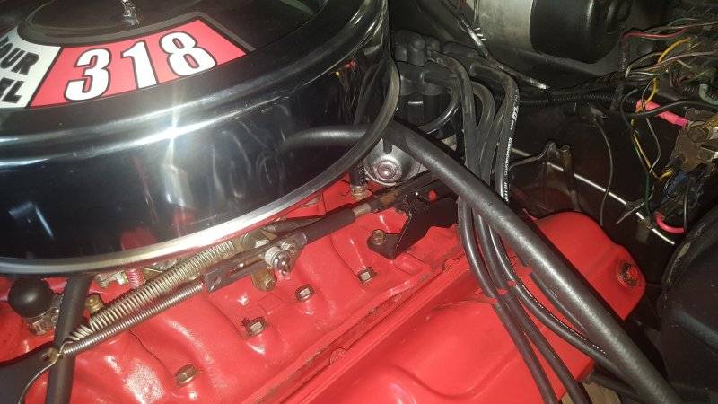

I’ll be watching. I have the same issue on my fresh restoration. First time out, first to second fine no third till I lift the gas.
After I put the new stuff on, the PO had put some sort of eBay cable stuff on the trans and carb that didn't work worth a damn, I started with setting it by the procedure in the FSM. From there drive, stop, adjust, drive, stop adjust until I liked it.
