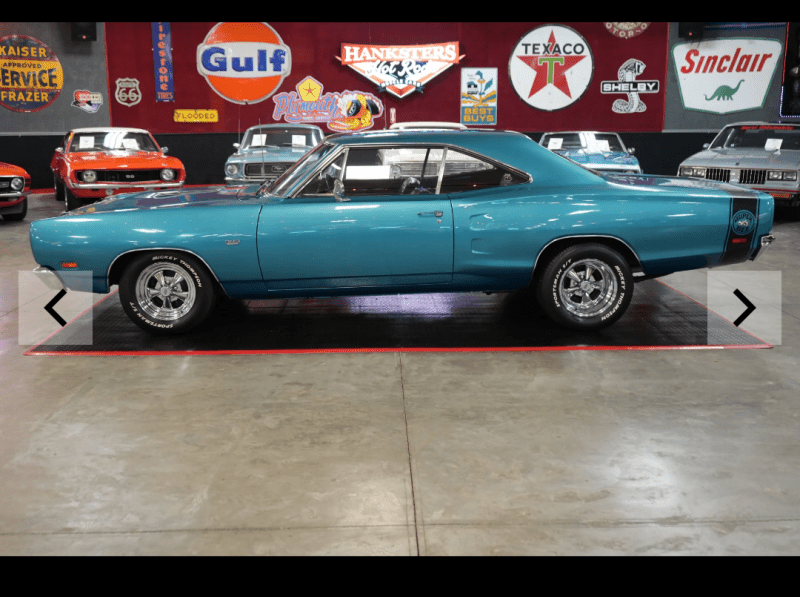

Not exactly what I've been looking for, but it checks a lot of boxes. Consignment car at Hankster. What do the experts think?

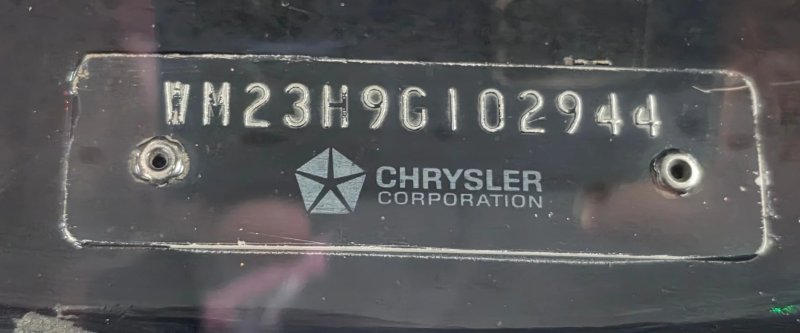

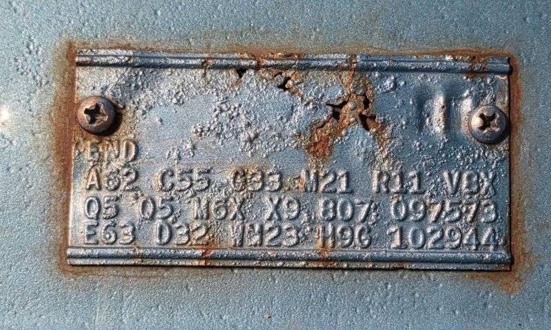

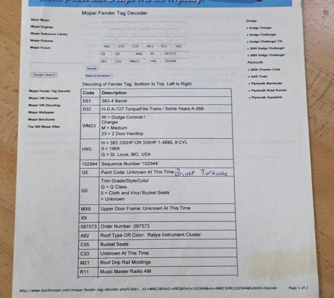

No expert , but the condition of the fender tag might be a clue to what’s under the nice paint top and bottom
For posterity:
VIN: WM23H9G102944

Looks pretty. Take magnets, paint gauge, and a really bright flashlight if you go look at it.
Cheap but very effective tool for checking for filler/fiberglass.. Take one of those car show magnets ff your shop fridge & try it on any old car... If the filler is more than 1/8" the magnet will fall off... Steel with primer & paint it'll grab & hold pretty well...

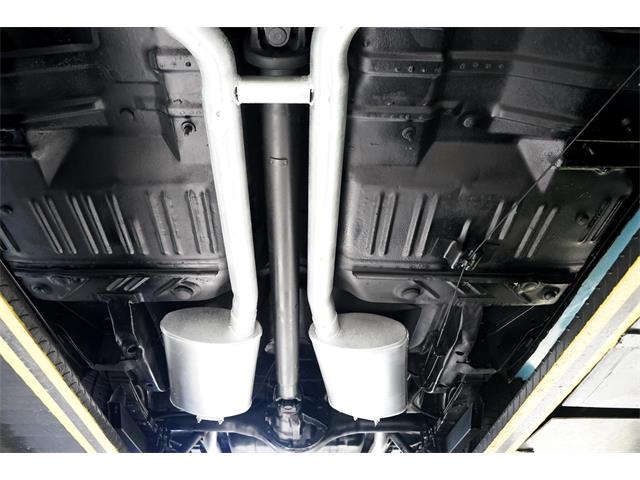

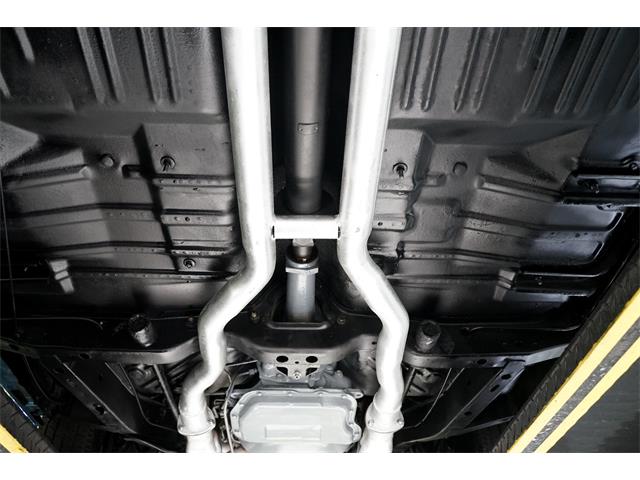

Headers look like they have been resprayed silver. There might be leaks at the collectors, but many people say headers leak. :eek:
There might be some silver overspray above the headers onto the transmission / dipstick tube.

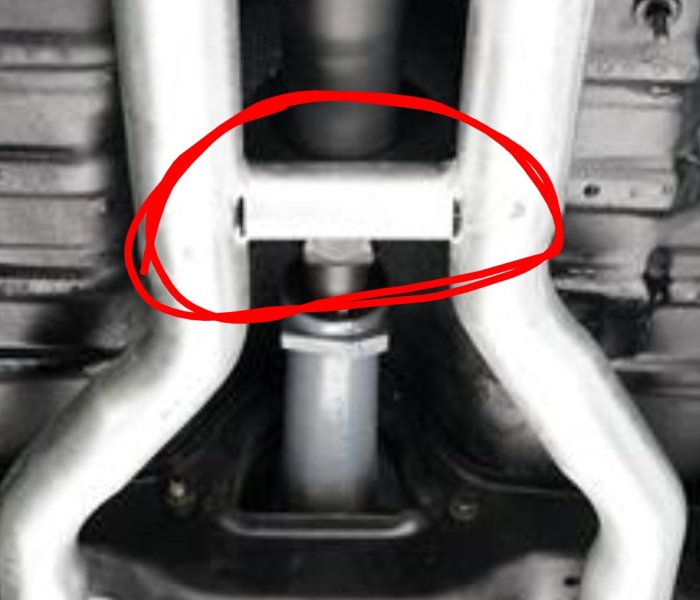

One tailpipe is really close to gas tank. Might rattle up against it.
Transmission case and pan have been powdercoated?

Traction bars. I don't like traction bars.

Looks like they want it to look nice cosmetically, but then fell short on painting the fender tag.
No mention of a broadcast sheet.

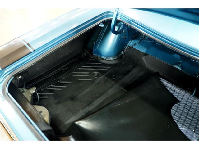

No mention or picture of partial VIN on trunk gutter.
